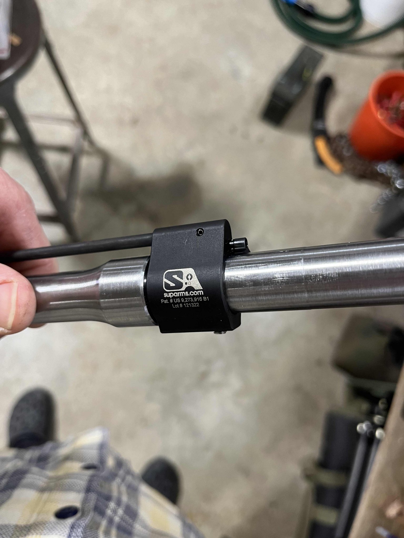

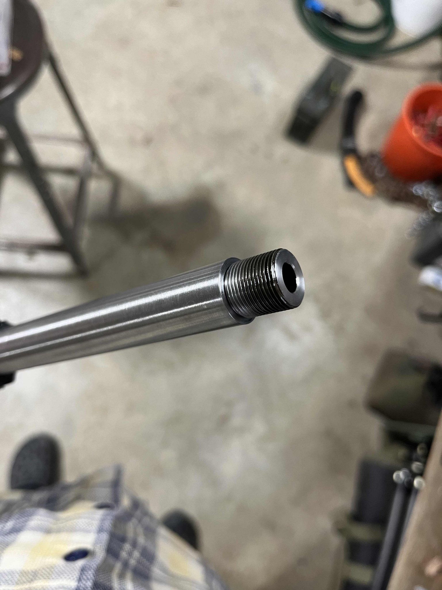

**UPDATE**
Been a minute as I've been busy with USPSA but have done the following "upgrades":
-A machinist friend cut/crowned, and threaded the barrel down to 16.25". This was his first rifle barrel and I think he did a great job. 30cal bore rod came out of the suppressor bore perfectly aligned according to my eye.
-Bought a PWS H3(5.1oz) steel buffer($56), then put the two tungsten weights from the Armalite buffer in with the 1 from PWS and that yielded a 6.8oz total buffer weight. Makes a big difference with a suppressor on it, but still might adjust the gas block a few clicks.
-I put the Superlative Arms AGB on and have it cranked out a good ways to the bleed off portion. Still needs a few clicks, but its shooting smooth right now with a can, so we'll see how it does without a can.
Rifle still has not missed a beat. I'd prefer not to put a stronger buffer spring in so hopefully I can dial it down a touch more with the gas block. I also have some tungsten powder somewhere, so I might add a few more ounces to the buffer.
Next step is a range day to do the 2nd round of accuracy testing with the ammo I bought in January. See if the shorter barrel, add-ons, and suppressor change anything.
