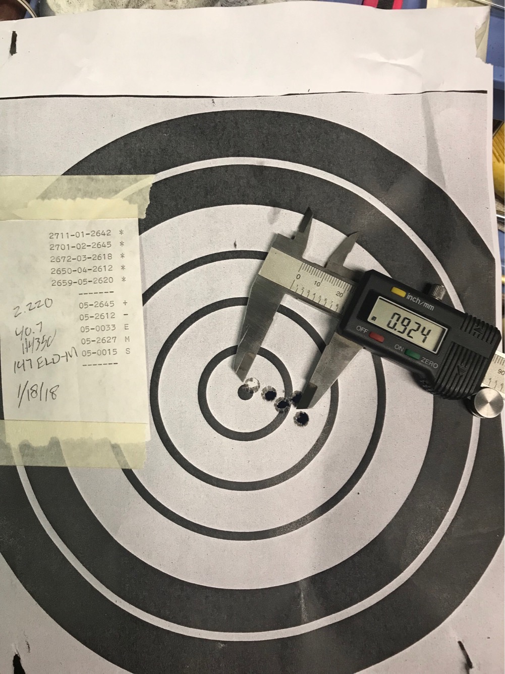

Did some load work up with an exceptional scope (1-4x20 Leupold, hey, it’s what I had) and it’s not too bad. 100yds.
Pretty sure the left/right was me. Had another group that was similar, but not quite as good (different bullet jump tho) without the horizontal dispersion.
Pretty well set on the LRTSi.
Hopefully with a better scope and more time to shoot groups (less rushing), I can tighten it up.
