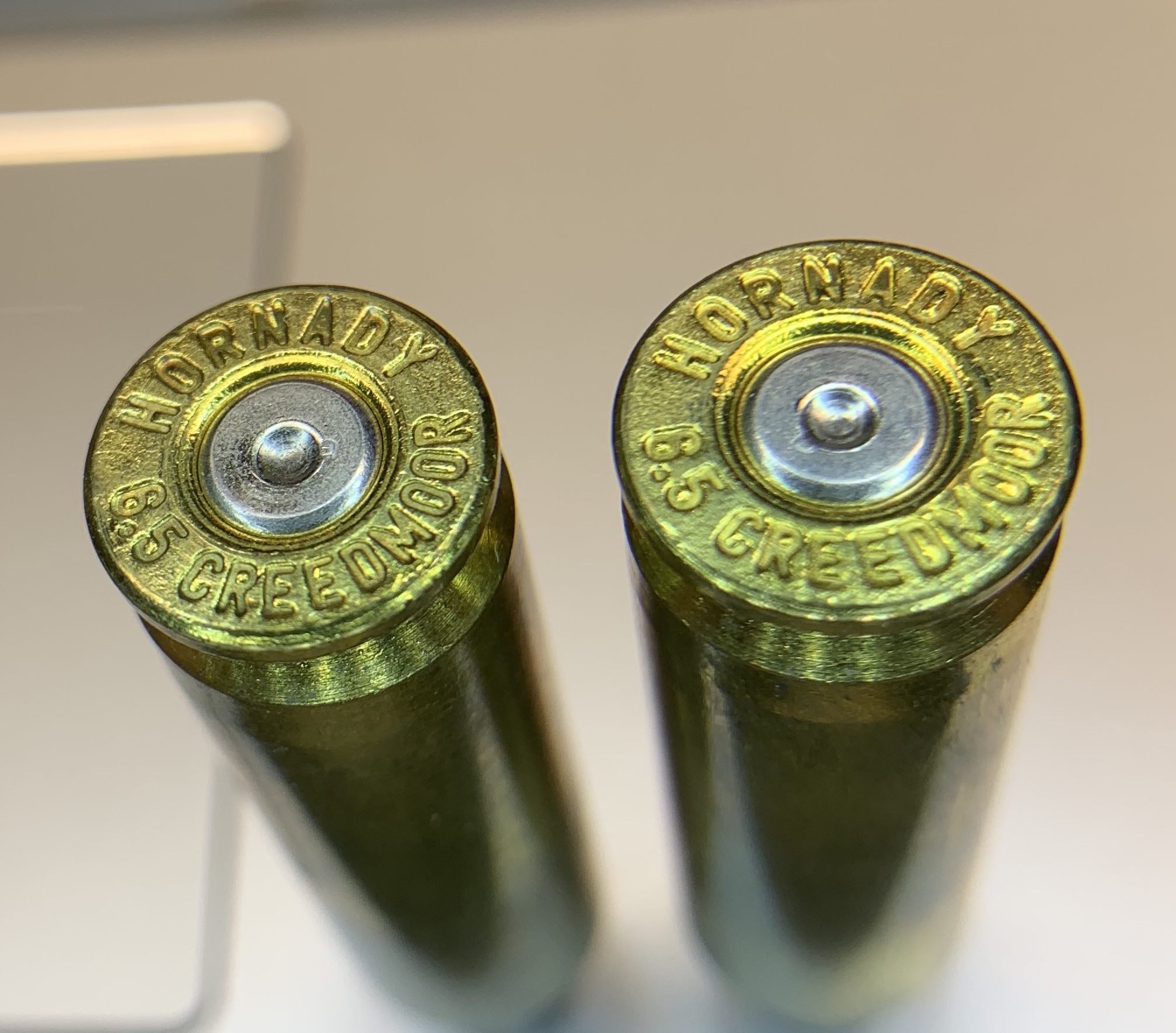

    I am wanting to see how fast I can push my 6.5CM with Hornady 135gr A-Tips. I am up to 2840 FPS with 43.4grs of H4350 with zero pressure signs. I am going to load two rounds in .2gr increments until I start to see signs of pressure. I guess my question is at what signs do you put the brakes on and back off. Let me say I know different people tend to push the limit more than others and some people are ok pushing the boundaries a little further than others. I will admit I am the type that tends to push the limit a little, but also within reason (read not blowing myself or rifle up.....LOL) So what is your SOP when going for speed?
    Reactions: Sidewinder66
    Cratered primers (My big rifle does this regardless. Gotta bush that firing pin hole!), flattened primers, ejector swipe, extractor <whatever tis called when the case rim has a pulled looking mark>, bolt thru the head... I kid on that last one. Maybe...

    On a scale of 1-5 on reloading experience (1=New 5=Expert) I would say I am a 2.5 I have been reloading for rifle about 3-4yrs I haven't ever strayed to far from published MAX. Just wanting to see how fast I can safely push my 6.5CM I guess am trying to see if I can reach 6.5PRC speeds in a 6.5CM case for no other reason than "just because". The two rounds below the one on the left was 41.6gr of H4350 the one on the right was 43.4gr of H4350 running 2840FPS that is .5gr over Hornady's max and .2 gr over Hodgdon's max with no signs of pressure to me on the case. So for the hell of it I figured lets see how fast we can get her up to.

    On a scale of 1-5 on reloading experince (1=New 5=Expert) I would say I am a 2.5 I have been reloading for rifle about 3-4yrs I haven't ever strayed to far from published MAX. Just wanting to see how fast I can safely push my 6.5CM
