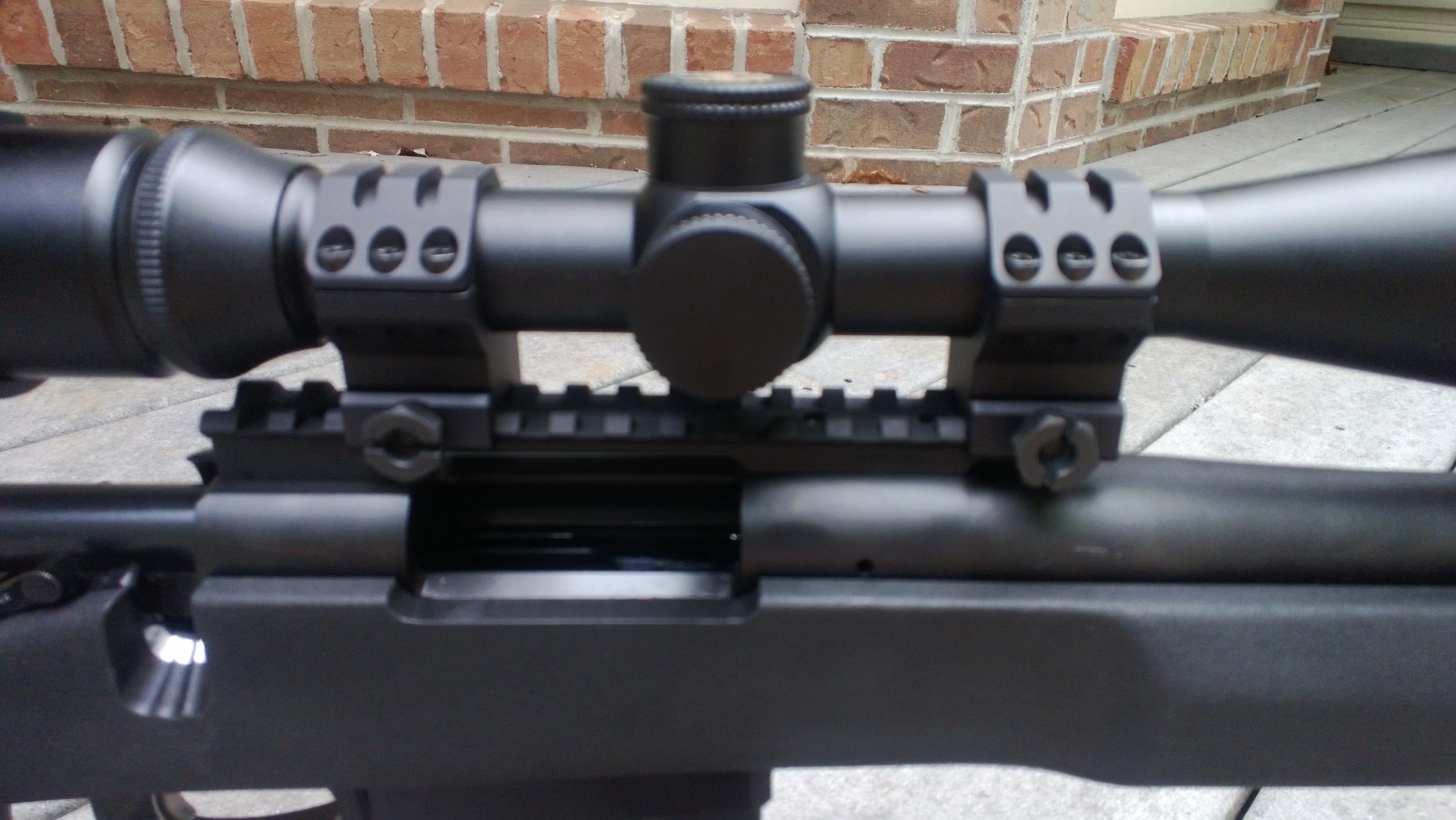

the tactical has an aluminum bedding block, so im not quite sure I will see noticeable gain from glass bedding. But if I were to do it, I could cut reliefs to give the epoxy better mechanical lock right? Would you recommend bedding the the scope base? From what I've seen it isn't too difficult, and I think I could handle it myself.
Also the weaver rings I got are extra highs. Forget the exact numbers but the rings I had on my rifle before were having clearance problems with my bolt handle and my scope. Willthe extra highs on a 20 moa egw rail be too high? Im running a Nikon monarch 4-16x42

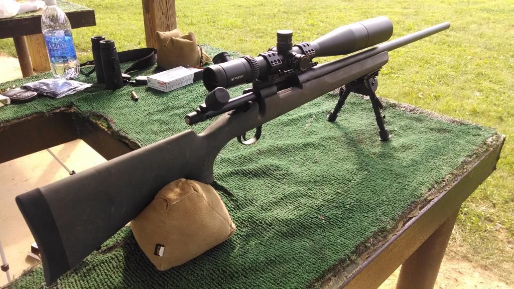

I have a Vortex PST 6-24x50 and I'm using the low Weaver Tactical rings. My objective bell sits about a quarter inch above the barrel. I have a 20 MOA EGW base. I did not have to bed my scope base, it fit flush with my receiver.
Sent from my XT1080 using Tapatalk
I think most folks like the scope to be as close to the barrel as possible. It really comes down to your comfort. If you can get a comfortable cheek weld with your rings, you should be good. Even with the low rings on mine I have a Triad stock pack on mine when I shoot. It's not on it in the picture I sent earlier. My son had been shooting my rifle that day and he shoots left handed.
Here's mine with the stock pack on it:
I don't use the pack to get that much elevation out of the comb, but I did raise it some to get a better cheek weld. All I can say is try them out with your ring bottoms attached to the rail and then attach the tops lightly so you can move the scope around some. Be careful not to scratch up your scope, but get down on the rifle and see where the scope needs to be for you to be comfortable. With the rings on loosely you can slide the scope around some to get your eye relief right. Pay attention to where your face is planted on the stock. There are some shooting tip videos on youtube where folks with some experience give advice on how your cheek should mate up to your stock. I'm sure if you search for cheek weld on here or google, you'll come up with some advice to consider, also.
Im starting to think the extra highs might be too high. From my measurements though, which could be wrong, it seemed as if they were the only ones that would clear my bolt handle. I had no clearance problems with the objective and barrel, it was just a clearance problem with my bolt handle and eyepiece

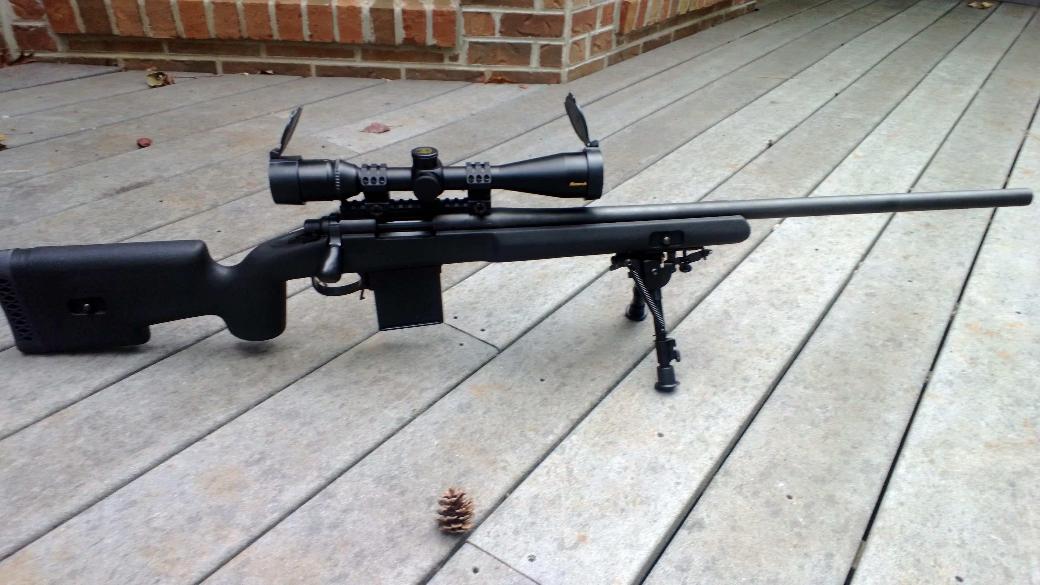

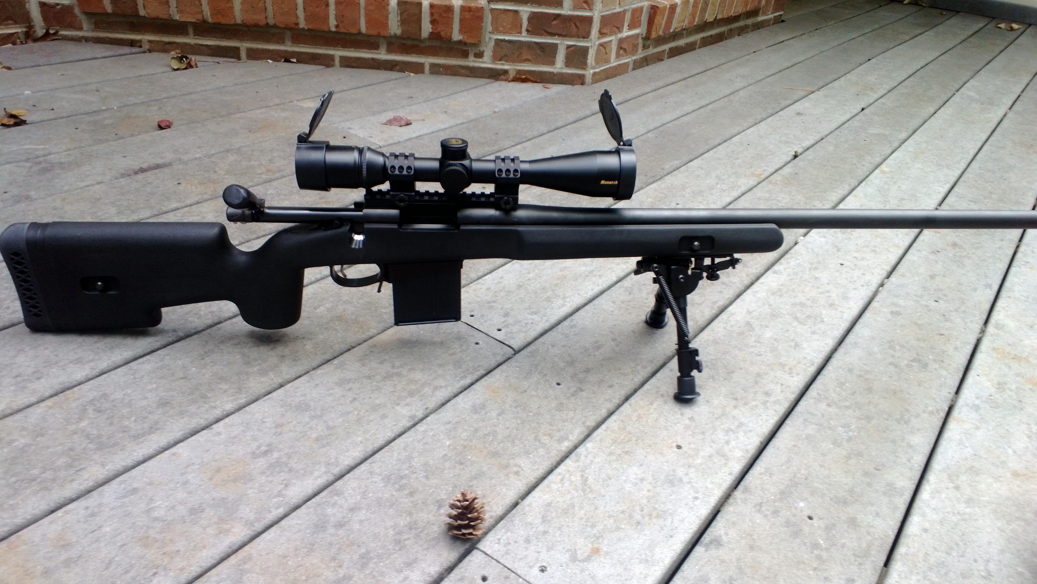

She's come together beautifully. All that worry for nothing! My first build and hopefully the rifle that's going to stick with me while I learn the basics of the sport! Saved all summer for this build so im pretty proud of it.
-Started with a dicks black Friday 700 adl varmint
-DIY bolt lift improvement off the forum (sanded the cam to polish)
-$5 bolt knob idea off the DIY section (jb weld putty and enamel black paint)
- Choate Tactical Stock inletted for badger DBM
-PTG stealth DBM
-EGE 20 MOA picitanny base
-Weaver Tactical 6 Hole rings
- Nikon monarch 3 4-16x42
-Blackhawk Bipod
She's not too fancy but im proud of her.
