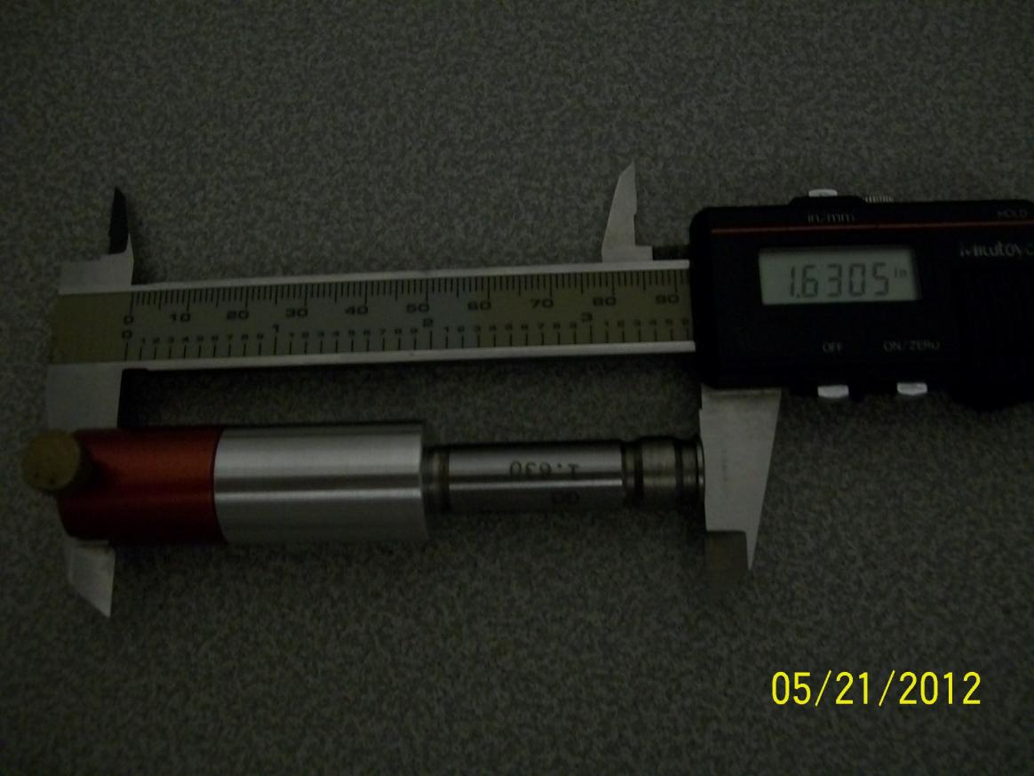

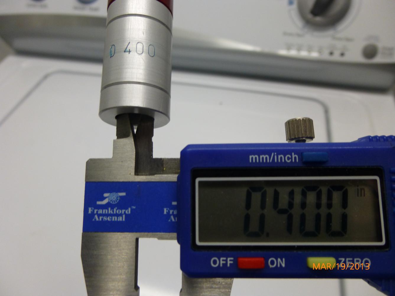

I use a Hornady .400 bump gauge insert for my 308 reloading. When I zero it using a set of digital calipers, I get a reading of 1.613" for fired cases out of my custom chambered 308 and my SR-25. Cases fired out of my Remington 40XBKS measure 1.616" with the gauge. When I measure fired cases from an M-1A or some other 308, I will get measurements around 1.620-22". For my different rifles, I use a set of Skip's die shims to adjust for the different rifles.
When I took a 308 1.630" headspace gauge and measured it (the shoulder) with the .400" Hornady bump gauge, I got a reading of 1.611". My point is some gauges aren't going to give you a reading of 1.630" minimum headspace gauge SAAMI spec. My Hornady gauge with the 1.613" fired cases reading shows snug chambers on two of my rifles.
I also happen to use a Sinclair bump gauge. It will give different number readouts from the Hornady gauge, but the numbers will be consistent with the amount of shoulder bump.
I don't know why you're getting measurements of 1.586" on your resized cases with your gauge, unless you have the die set too far down. 1.586" is a pretty far set back for the shoulder bump from the 1.612" of your fired cases. My redding F/L die maxes out on the shell holder at about 1.610" on the Hornady gauge (which is very near the SAAMI minimum).

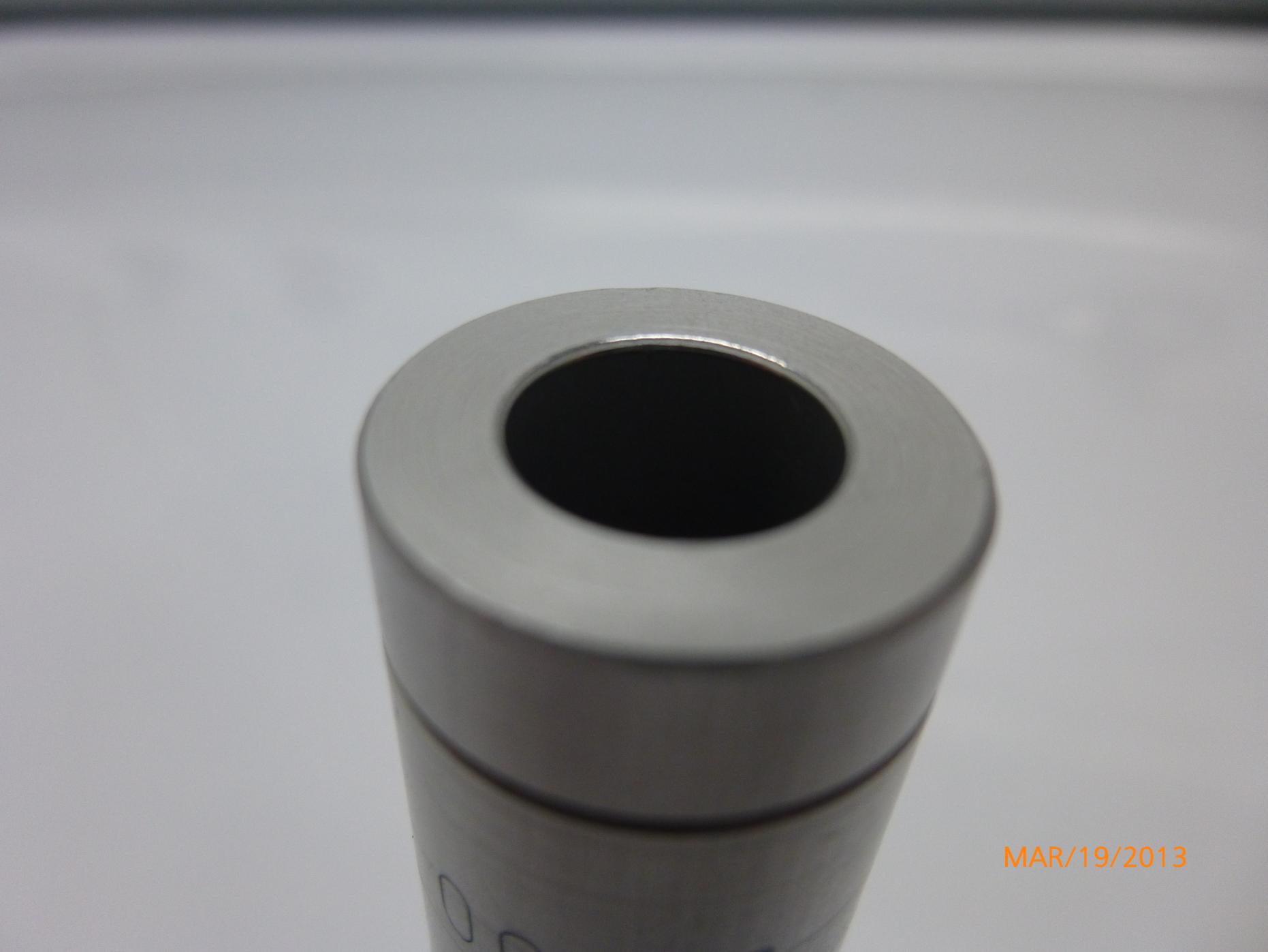

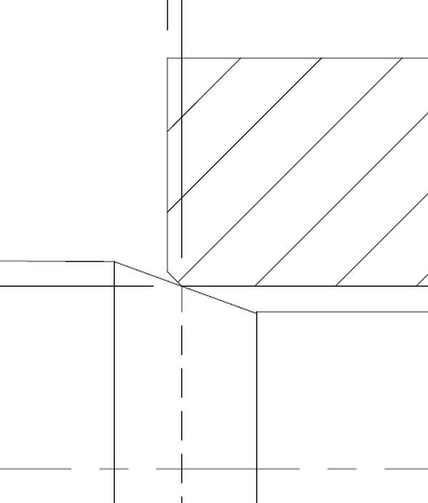

The reason you are not getting the 1.630" dimension for the "GO GAGE" using the Hornady 0.400" insert is
that there is a chamfer in the mouth of the tool. Every insert may be different depending on the depth that
chamfer has been cut. Your "GO Gage" is accurate it's just your not adding that difference from the tool face
to the chamfer cut depth (or the actual .400" datum). See below.
Terry

The reason you are not getting the 1.630" dimension for the "GO GAGE" use the Hornady 0.400" insert is
chamfer has been cut. Your "GO Gage" is accurate it just you not adding that difference from the tool face

That makes sense. It seems I have a .019" chamfer on my tool. Thanks for the diagram, I haven't seen that diagram before. I bought the tool when it was still "Stoney Point". Many years ago, I used the Wilson style drop in case gauges. While they helped greatly in setting up dies, the newer gauges are so nice since you can read numbers off of the datum line. It makes a big difference when you're setting up your die on a precision rifle. I see Forster just brought out a new bump gauge this year, similar to the Hornady, but it is self contained.
http://www.forsterproducts.com/store.asp?pid=37195&catid=19938
I made one with a 0.400 bore and found it measured this Go-gauge kind of short so I bored the next one 0.396 and it's on the money.
Could someone measure the true bore dia. of the tool and post it.
