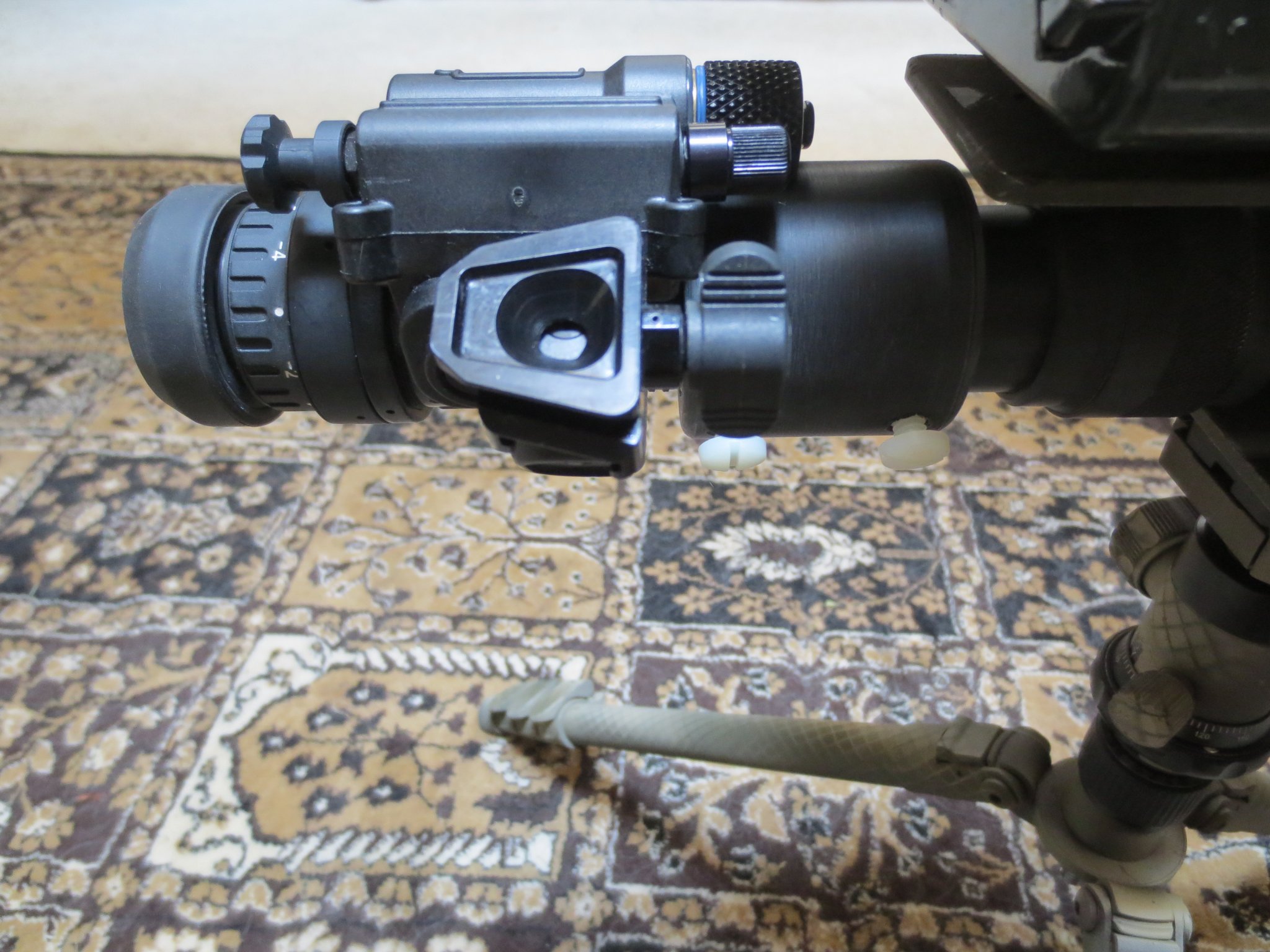

You can also make one/have one made. A member here made the mount for me, it's just a piece of industrial plastic spun on a lathe with a cutout for the on switch. The inside is bored out so the 14 and USO observation scope don't touch but come close; this particular scope has a really long eye relief FWIW. I threaded and installed helicoil inserts and use nylon 1/4-20 bolts to hold 'em in place. It'll require adj. of focus. You can also burn an image in quick with one this way, in part because it's stationary and in part because it's magnified light I'm guessing. Be careful with PEQ's and staying in one spot too long, or street lights, etc. Turn it off when not in use and move it around some when in use. Again, be damn careful using the PEQ and keep it minimal.
Monoloc is a good place to go to if you aren't gonna DIY it. What German did with the PVS30 is the best way and how you're "supposed" to do it, but if you only have one, well, you're gonna want that on the rifle and I get it.
Here's my DIY setup. It's far from ideal but it gets the job done and was done on a post-divorce budget. $1160 not counting the PEQ and PVS using parts that were not meant to be used this way, so where there's a will there's a way. Of course if you can afford another PVS30, then that's the route to go for sure.
