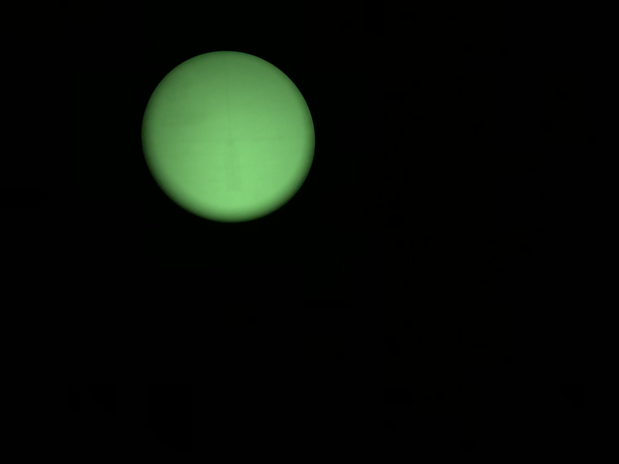

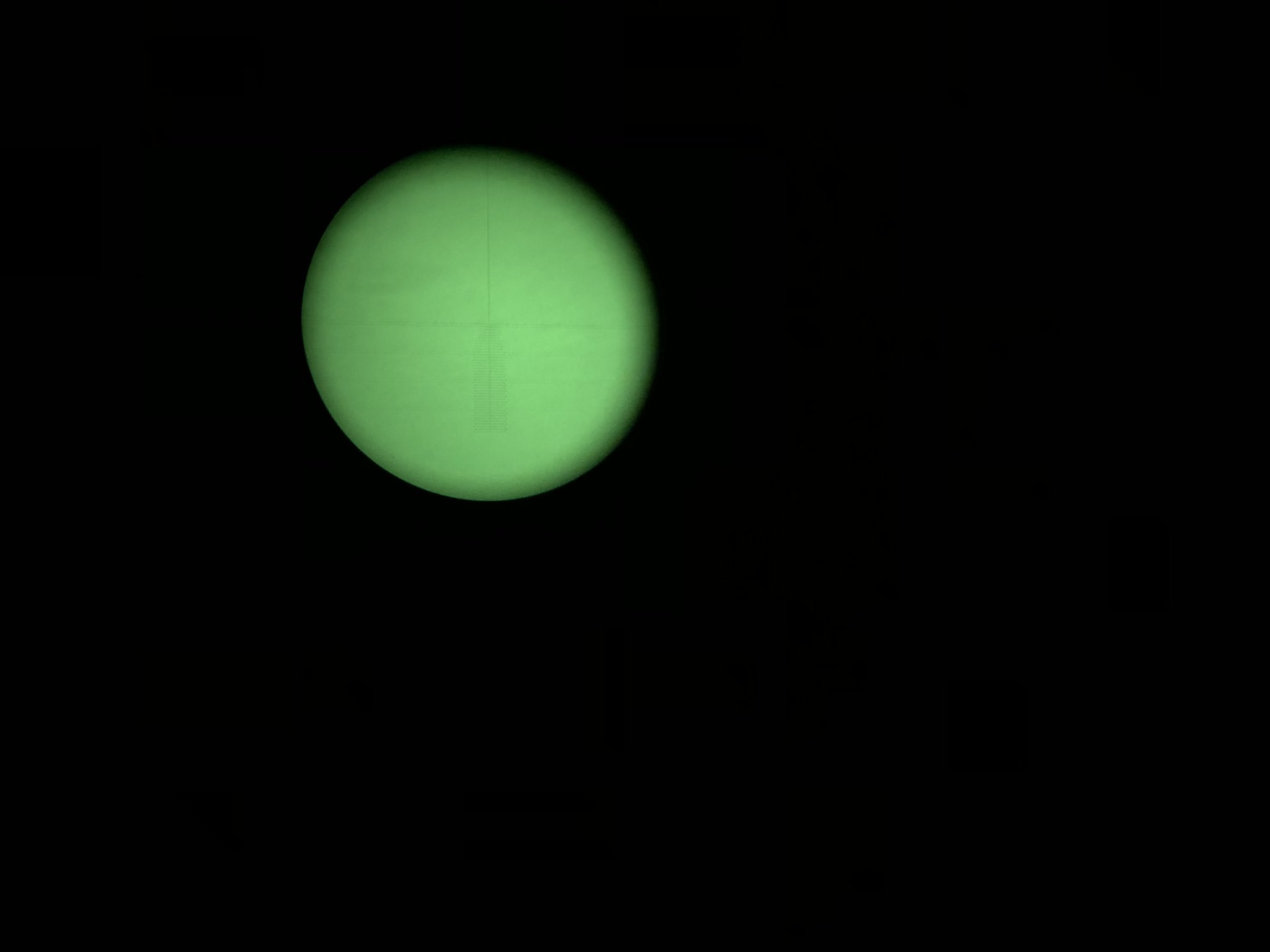

I was playing around with my new PVS-30 and it appears a roof ridge line is faintly “burned” into the tube form looking at it too long? NVG newbie here appreciate the advice.

Sorry it’s the best photo I could get but you can see it faintly in the top left corner

Could be my eyes, but that reticle looks burned in too, no? Was that pic taken mounted through a scope and reticle out of focus? Or straight through the ocular of the -30 looking at the cover or blank wall?
A reticle should not be in front of the tube.
Mounted through the scope.... if I zoom in with the scope you can’t see the image top left. I have an a dark drawer right now trying that trick Victor-TNVC suggested
