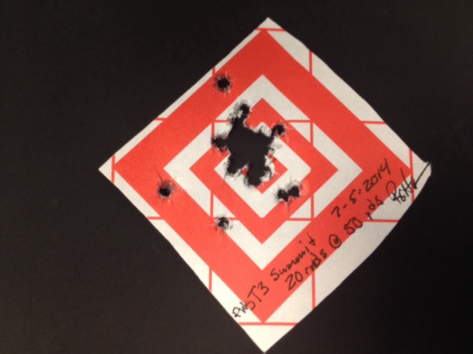

PWS T3 in Boyd's Tacticool stock w/ SWFA SS 3-9x42mm Mil-Quad in Vortex Precision Matched (Low) rings 100 yard zero. Harris Bipod and rear bag. With CCI Standard Velocity, mine is about 1.5 MOA on average at 100 yards. With better ammo, it's under 1 MOA.
Here's a 20 shot group I shot in July from 50 yard bench (bipod & rear bag). CCI 40gr Standard Velocity
If I can figure out how to post it, I got video shooting 12x18" steel at 300yds with it. 300 yards is a 12 mil hold with the above setup & ammo.

Junger,
You get the lolipop for being the 1st to post a tgt pic. Gracias Amigo. Am I correct to interpret from your pic that the target's grid is 1" squares? If so, am I reading the group correctly to be a 20rd group measuring about 1.3-1.4" center to center at 50yds? Just checking since it is hard to accurately read a photo and I do not want to jump to conclusions. Help me out here. And thanks for posting.
PS: CCI std vel is hardly match grade ammo. Any chance of getting some pics of 5 shot groups at 50yds with high grade ammo from say: RWS, Eley, Lapua, or similar?
Irish
Correct, those are 1" grid squares. I find I get about 20% fliers with CCI SV. Taking the best 15 of that 20, you get roughly 1.5 MOA.
I mostly shoot CCI SV because I have a lot on hand as it shot the best out of the Savage BSEV that I traded toward this T3. Out of the BSEV, I could consistently get under 0.5 MOA. It also had a 21" barrel.
When thinking of what you should expect from a T3, remember that it's only a 16" barrel that's intended to be suppressed. I should have my Sparrow by mid-November. I think shooting it suppressed will tighten it up further.
I'll follow up once I get some groups with better ammo and once that suppressor comes in.
