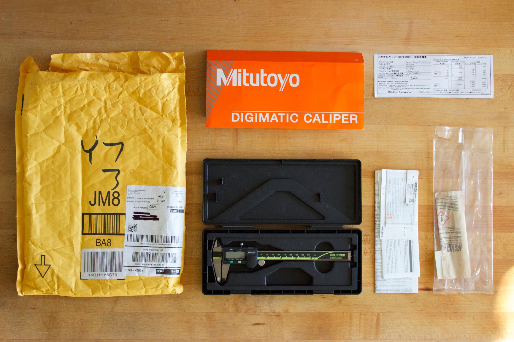

I find myself in need of some new calipers. I've been using a cheap $20 digital caliper from the auto parts store for several years. I know it's not the most exact, or repeatable set of calipers, but it got me by. Anyway, it crapped out on me the other day, and now I need to replace it.
Do you use a digital caliper, or a dial caliper? What calipers would you recommend?

Any of the big 3 brands, Starrett, Mitutoyo and Brown&Sharpe, are good to go. I prefer Brown&Sharpe myself.

Mittutoyo, Starett, or Brown & Sharpe are all the go-to for precision measuring equipment when you don't want to question the tool.
