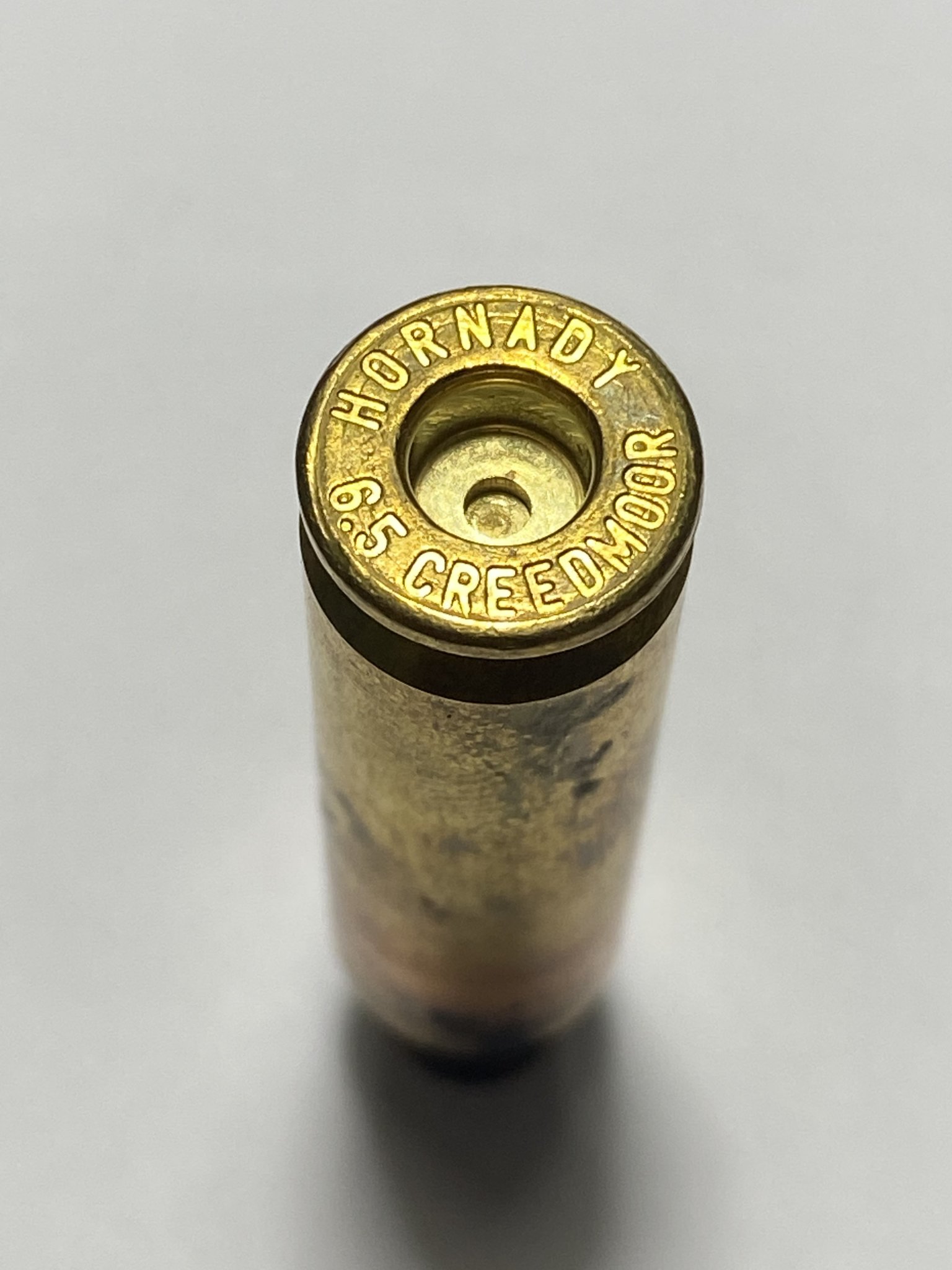

A bit of a reminder of the need to QC with your own eyes, I found this defective piece of brass in a batch of 400 new cases. Probably a good thing it went to a hand loader and didn’t slip through into a box a factory ammo. If your wondering why a new case looks so dirty it was my test piece in the annealer and has tempilaq on it.

What do you think would be the result of firing that round? Think the primer would stay in?
There was a thread on here once where someone fired a piece of brass like that in some factory ammo. I remember it messed up the case head and primer came out. I want to say it damaged the extractor ejector and bolt face also. I remember being surprised at the amount of damage it caused to the brass. I can't seem to find the thread though.
