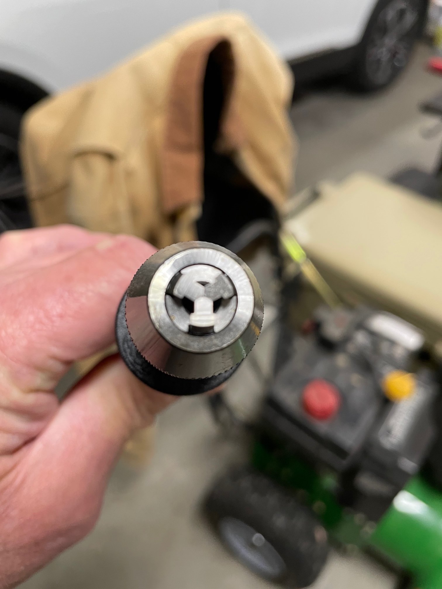

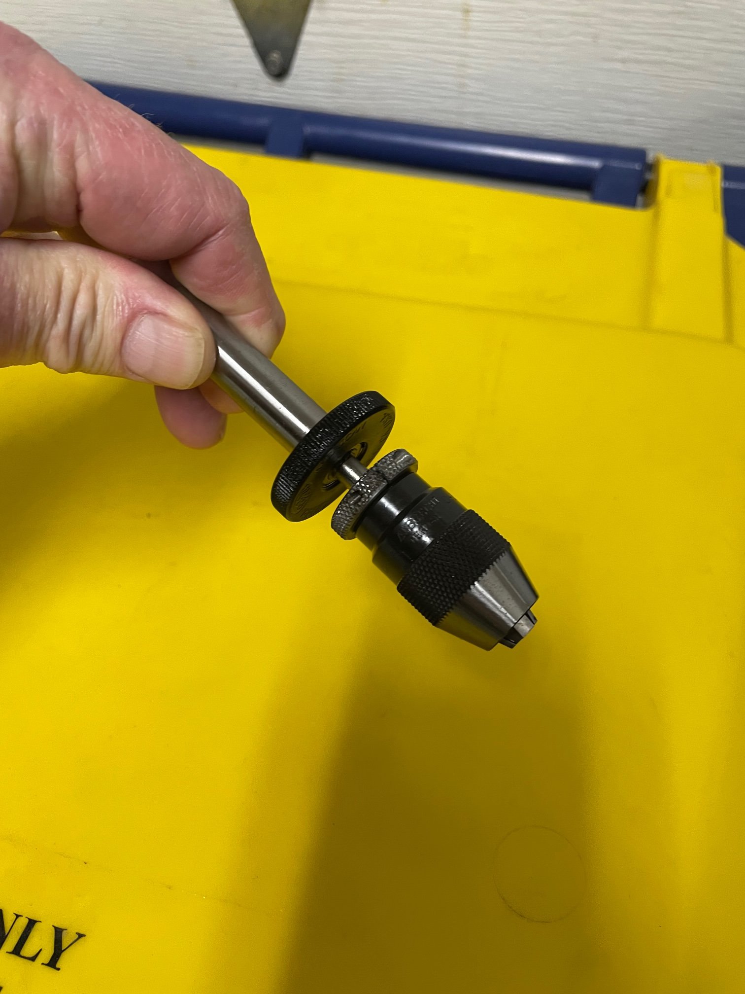

Albrecht, 0-3..........fits any 1/2 chuck..
.........pricey, I think I used it to drill 2 holes.......

Scratched this itch and picked up a used Servo. Smaller than I would have guessed but seems to be well made (ought to be for $2k new!!). 200 - 20,000 rpm and supposedly some way to go down to 10 rpm but haven't figured that out yet or if I'm reading right. And it has the nice little Albrecht 0-3 chuck mentioned above.
