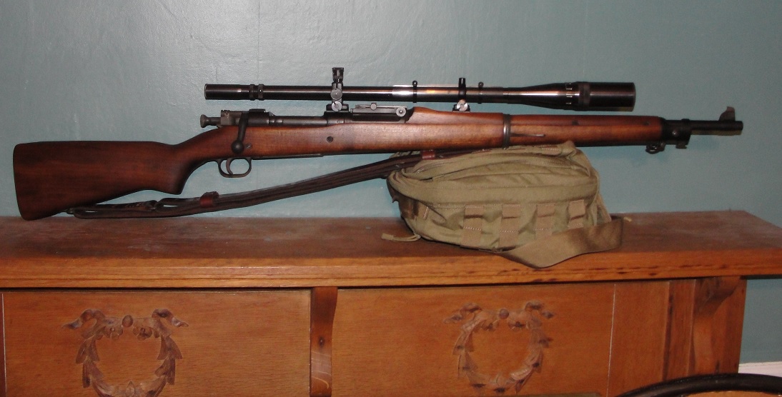

Thanks everyone for the input - here is a pic of the reproduction - Miltech did the build and the scope and mounts where refurbished by Parson's scope service.
Very nice. Glad Parsons worked out fir you, chatter is they are not following through since Mr Parsons passed.
The previous owner told me that this was one of the last projects that left there shop before Mr. Parson passed. The glass is crystal clear and they flipped the eye piece so that the 12x is pointed down. Thanks again for the information.
