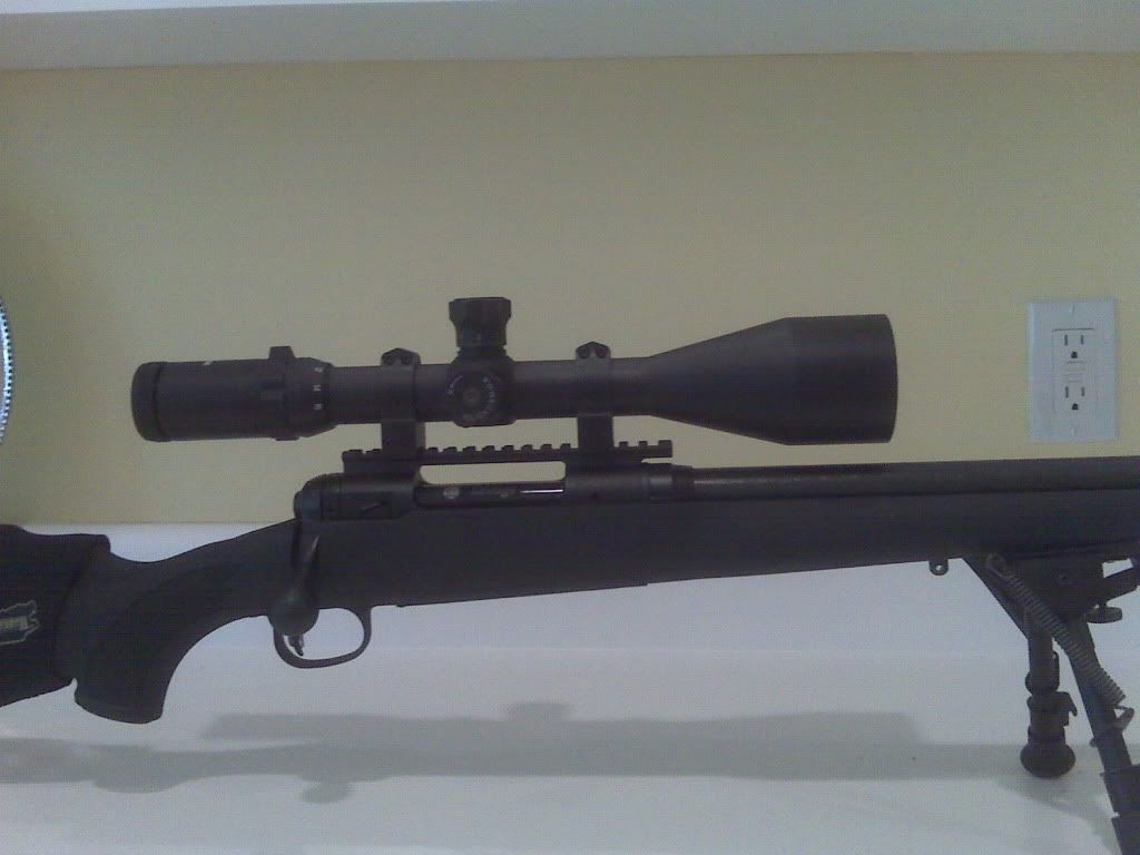

I previously had my Savage 10fp .308 with a Millett 4-16x56 set up on a 0moa two piece Warne Maxima mount in which I coupled with Warne Maxima high rings. I recently installed an EGW 20moa one piece rail so I could enable the scope adjustment to shoot 1000yrds if I ever got the chance. I've found that the new rail actually places the scope higher and I'm questioning buying some lower rings. On my math (which is not my favorite subject) I have .375" clearance from bottom of bell to top of barrel. My high rings measure .525" from base of ring to bottom of scope tube. I believe that I could clear the low rings which measure .25" from base of ring to bottom of scope tube and still have enough clearance for the scope cover (.525-.25=.275 leaving .1" clearance). I understand it is best to mount the scope as low as possible without any contact with the barrel. Is .1" of clearance too close?
Will lowering the scope this .25" make any difference as far as accuracy or would it be a simple asthetic fix? Bottom line: is it worth it or should I just leave it alone?
Here is the scope clearance with the high rings. Sorry for the crappy cell phone picture.
