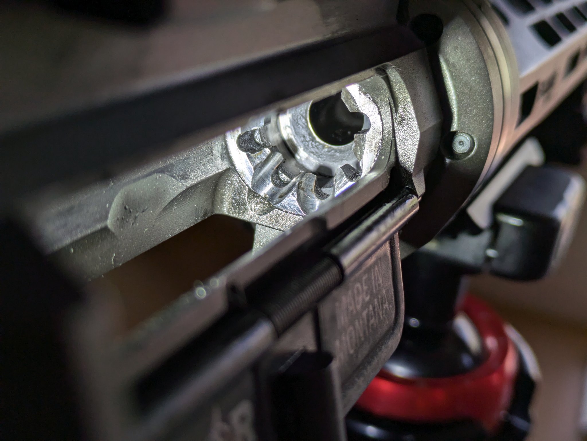

Here's a picture:
I have a feeling that this is the culprit, it looks like its almost a knifes edge:
Ooof. Yeah that's begging for a good polishing/blending job, arfcom has a suprisingly useful ancient thread on the topic here if you want to DIY: https://www.ar15.com/forums/precision-rifles/Hellbenders-guides-to-Ultimate-AR15-and-or-AR10/4-42/
Covers a bunch of good accurizing steps such as feed polishing and barrel shimming (the latter probably not needed in your case)

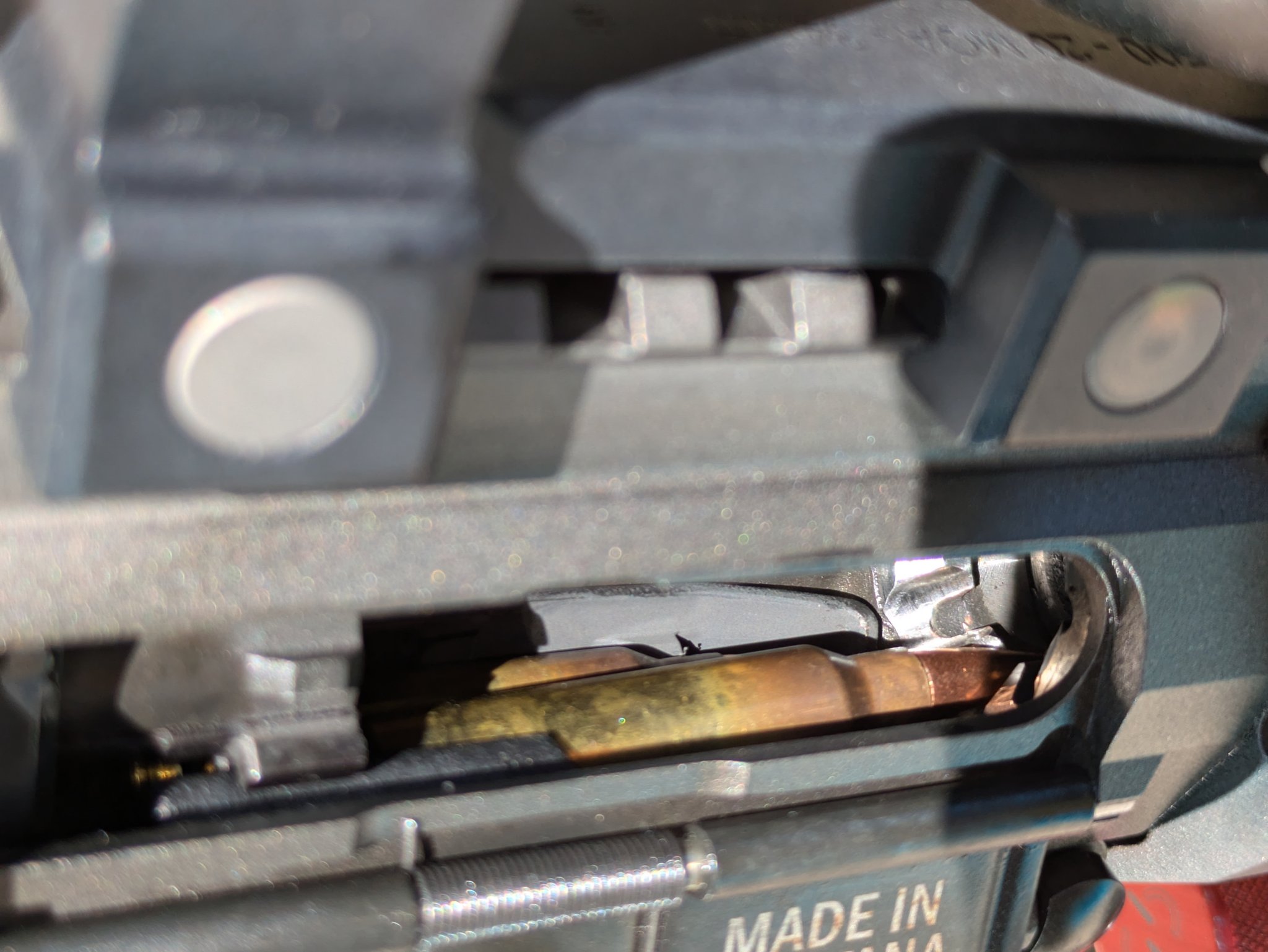

Here's some more pictures, this is what happens when the BCG is ran at any speed less than "full speed ahead":
The ammo gets consistently hung up on the feed ramps.
This is with 20rd pmags, 30rd pmags, metal 30rd KAC mag, and regardless of what side of the mag the ammo is stripped from.

I don’t let a barrel extension near an upper receiver until it is de-edged, blended, and feed ramps polished.
Manufacturers can address this using tumble-polished extensions like BAT used to do/still does?
You can see a clear difference between extensions and how they are made. Most on the market are not in-spec to the TDP, so lug clocking might not even align with your bolt lugs correctly.
But those dings and gouges are normally caused by sharp feed ramps.
The inside forward edge of the lugs in the ejection clock location will also bite into your necks on some cartridges during ejection, so I sometimes will take those edges off carefully.
For companies charging that price point, all of these features should really be baked-into their processes.
