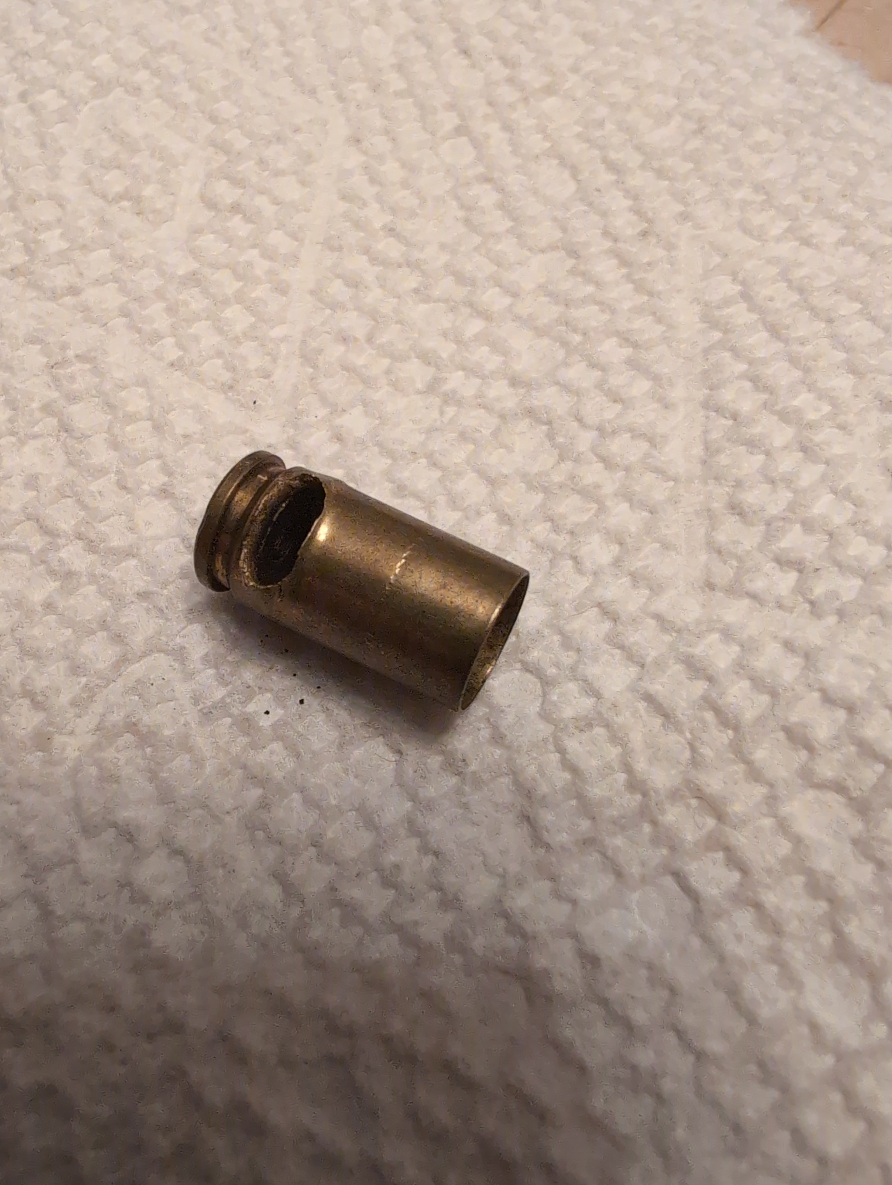

The barrel is short throated and the chamber is deep enough for certain ammo. Had this when the PSA PCC first came out years ago and also with a Faxon barrel.
Yes the PCC AR-9 pattern can fire out of battery.
Still have the scars to prove it.
