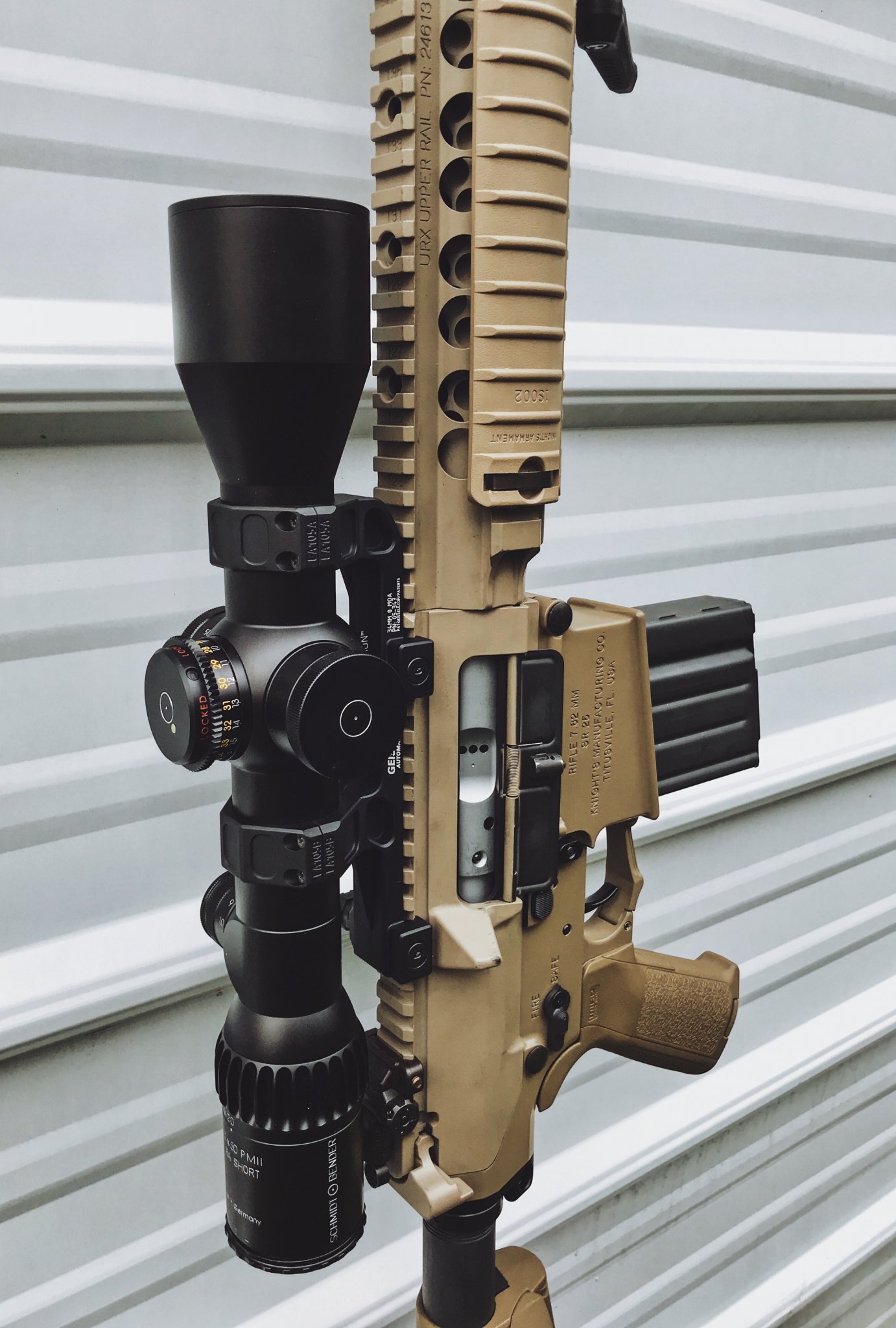

Anyone in here have experiences with this S&B elevation turret?
I have a quick question regarding it. It's a double turn turret with 35 mrad of travel. I zeroed it today and adjusted the turret back to "0". But now I can only max out at 19.2; it wont go any further up. Is this normal? Or did I break something? I read the manual but it didn't mention anything..
The scope base is 0MOA btw.
Appreciated all the answers/helps ?
This is my first S&B with this turret. All my other S&Bs will max out on the elevation after being zeroed except for this one..
