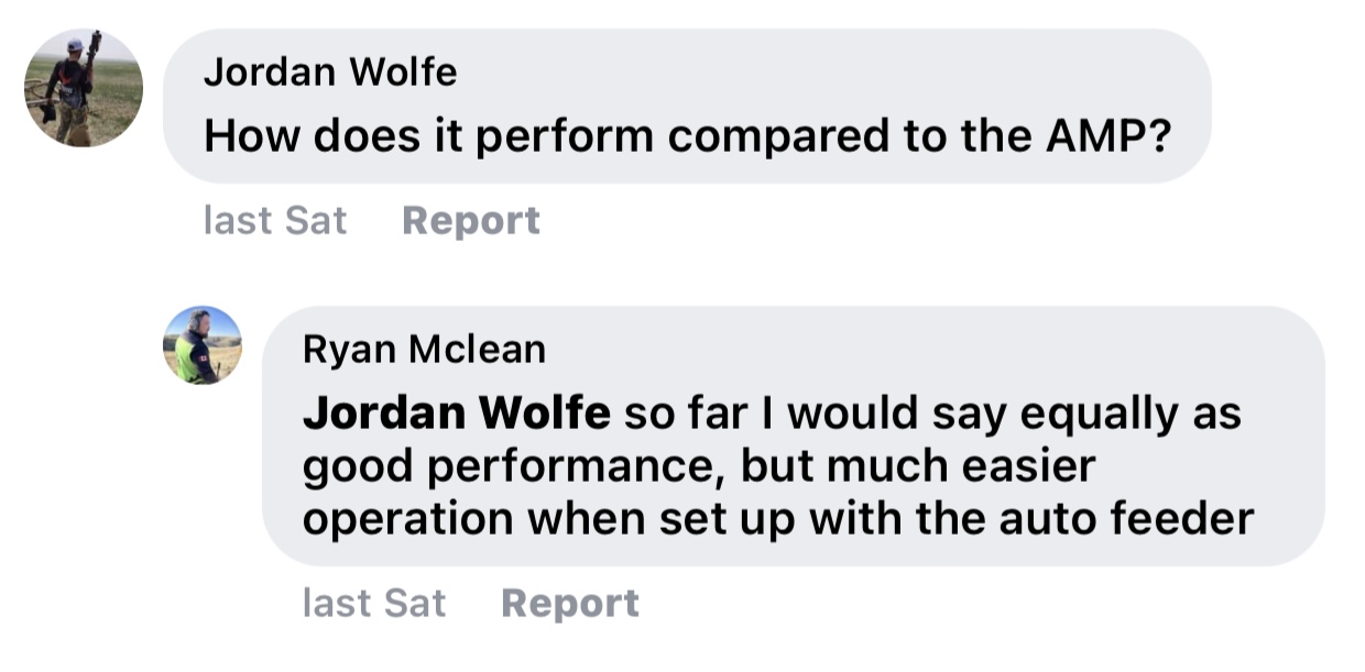

Any real world (not influencer) reloaders out there using the Quick Anneal? Tell us your thoughts and experiences. Especially vs the AMP.

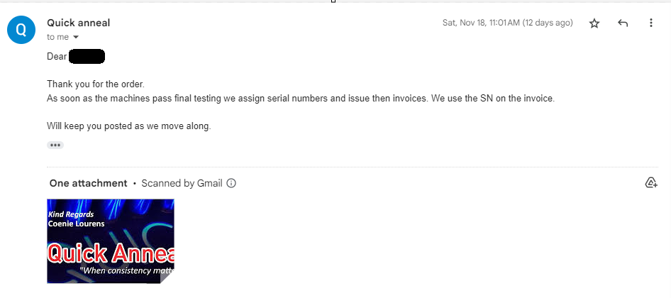

No experience yet, I am placing an order though. Requested an invoice just yesterday but they're waiting on machines to pass final testing and have serial numbers assigned before they're sending an invoice. I suppose it's a good sign that they're not accepting payment until there is product ready to ship.

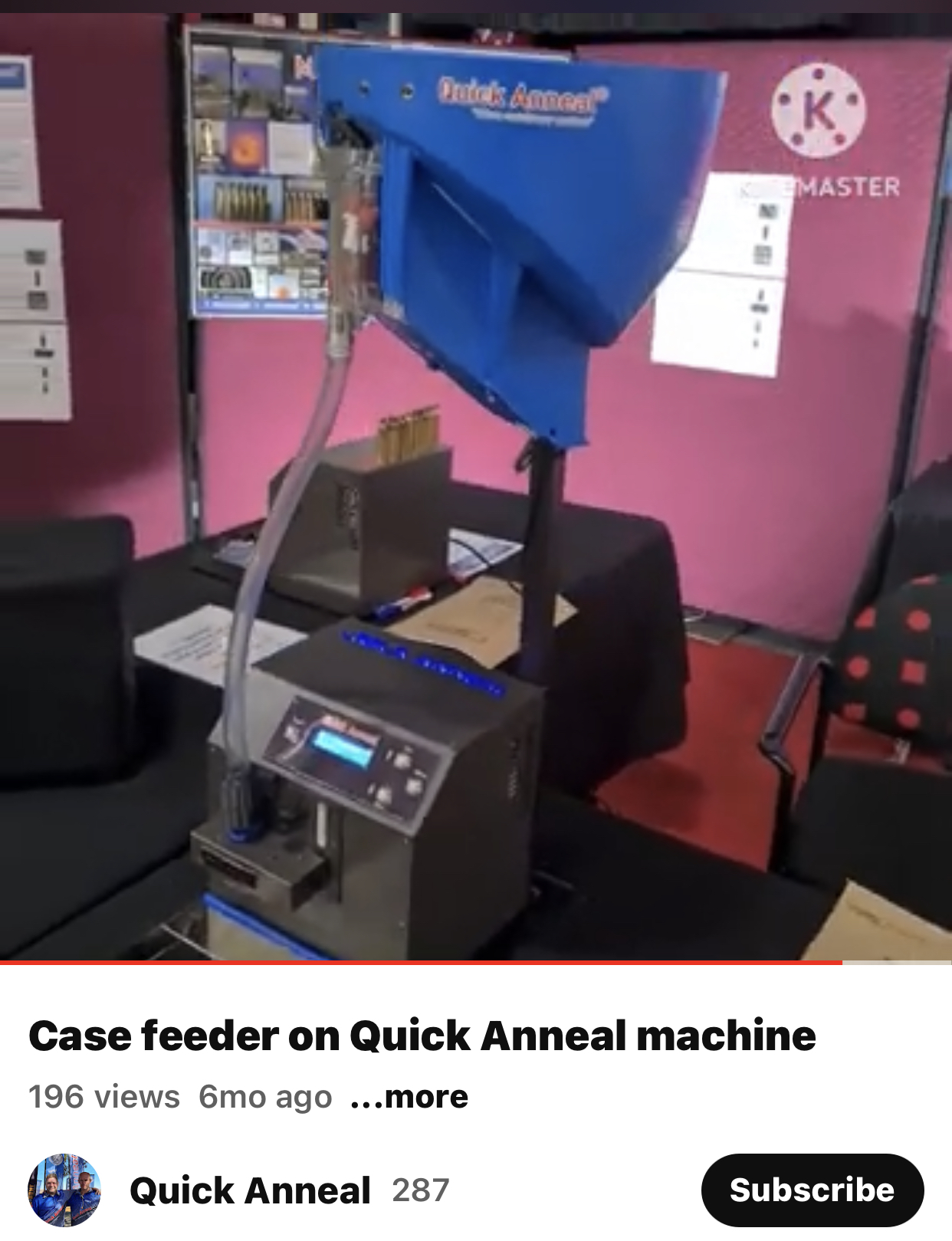

I ordered one yesterday and was told the same thing. Being able to use any variable speed case feeder is definitely a nice feature.

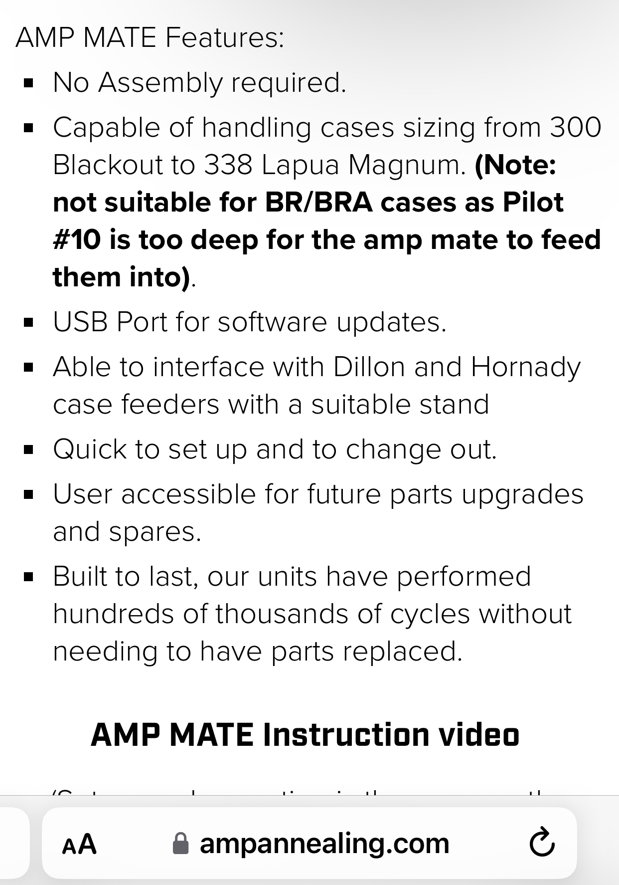

AMP annealers are nice but they do less and cost $600 more . That’s not even factoring in the required pilots or the contraption they call the AMP mate. Which is $450 and requires a case feeder and stand . So somewhere around $700+ extra to auto feed. Even worse yet the AMP MATE will NOT feed BR/BRA cases. Which for me would rule it out anyway.
The amp mate always has been and always will be a proof of concept Rube Goldberg contraption as mentioned above.
It is too difficult to set up, too expensive, and too error prone to be practical for shooters who want to switch calibers.
It is simply way of trying to work around a faulty design that anneals cases upside down; I have an amp and I love it, but that is the God darn truth. The AMP was destined to be a manual feed device by its upside down design.
ETA: so, after thinking about it, I will be keeping my AMP and keeping my GIRAUD because I am not buying a second induction annealer and a separate case feeder, and having $3000 of annealing machines. Nor would I sell my AMP because that thing is just plain dialed and I use it for my lower volume, larger caliber, expensive cases. But if I were starting out fresh today….
I've run thousands of BR through the AMP MATE and it ran them just fine. Well, just fine meaning the same number of fail to feed to the shellholder as all the other cases I run.
I must have missed something. "Being able to use any variable speed case feeder is definitely a nice feature." Were was this documented?
Bottom line If it does what it advertises. Which is everything the AMP does plus more without the need for pilots. While being around $650 cheaper . The AMP annealers may go the way of the labradar. Either way competition always benefits the consumer.

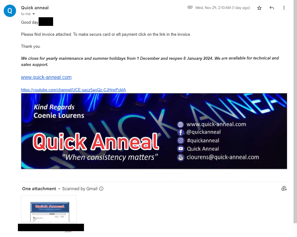

Update - just received an invoice email with payment link to Yoco (a payment processor). The invoice is for R18540 (South African Rand). Something to note that a lot of people might not know is if using a credit card, some cards charge a foreign transaction fee, so if interested in purchasing, use one without the fee to lower your cost. I also suggest if your credit card company offers it, create a virtual account. This would provide additional protection from fraud or breaches. Paid my invoice, we'll see how it goes.
I got added to the back order list. They are closed for yearly maintenance and summer holidays from December 1th to January 8th. But available for technical and sales support.

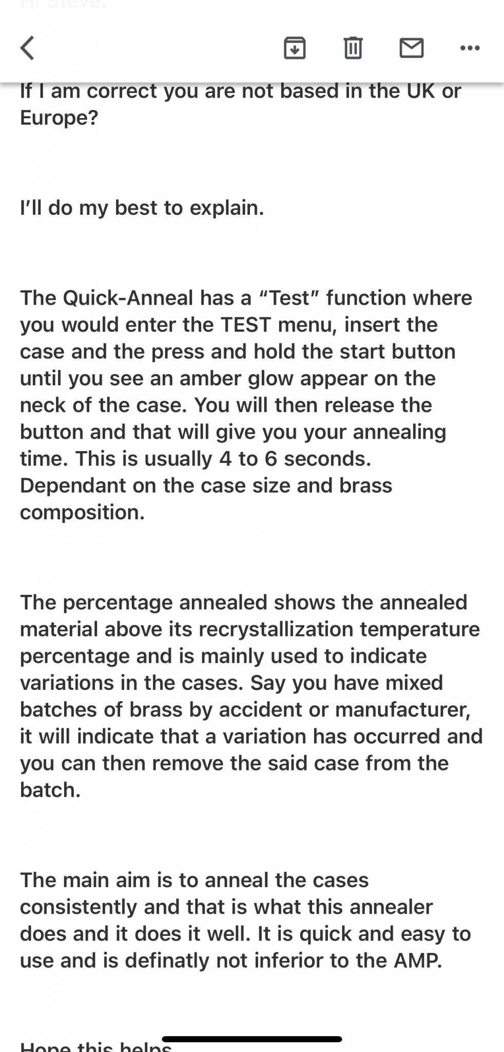

Im curious what they told you. Could you post their response ? I was told anneal time is set by watching the brass until it glows. I emailed Mill Creek Outdoors a couple of days ago . They are their European distributor. They have a couple of YouTube videos detailing the quick anneal . Here is what I was told when I asked how you determine the anneal time . Here’s their response.
Reactions: Rover31
I re-read what they sent back and have responded to them for clarification. Below is what they sent. Reading what you received I now believe it's all based on what we see when annealing during test mode.
Rifle Brass is a special metal in the sense that as you visually see the metal start to change colour / glo it has reached anneal state. This anneal and recrystallisation window has a wide temperature range. Some other brands made it more exclusive smoke and mirrors by software and codes to make it seem special. They only use an ir sensor that is why you need to melt a case for their machine and the software deduct a couple of milli seconds to give you their code
Hence you can accurate anneal the metal by visualisation. We calibrated our machines with the help of lab tests and metallurgist. If you want, you can use tempilaq 750F we don't like it personally, but it is a tool. That is why people start using our machines it is easy to setup and you are in control to achieve certain results that is not possible if you cant change your heat time and the case hight.
They responded already. It is visual.
Yes if you familiar with the gas flame method ours are the same. We only use induction as the heating source.
Tempilaq 750 can also be used to very.
We do not bother as the units is calibrated and brass alloy metal starts to anneal as soon as you see the discoloration of the metal / color change.
You are in control and van therfore adjust your initial time to control springback / neck tension.
The lab and metallurgist told us when in doubt a bit hotter is better. So if you not sure adjust the time by 0.1 - 0.2 seconds longer.

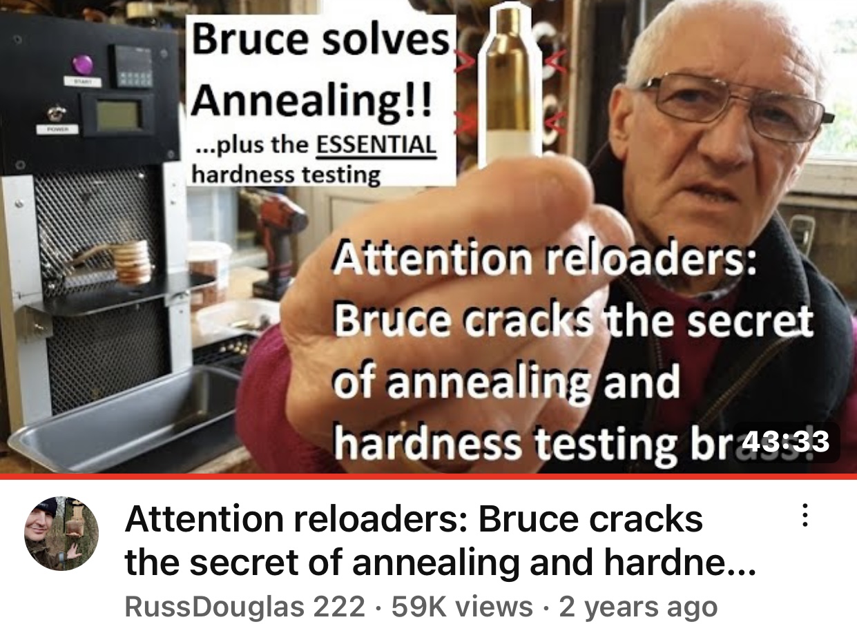

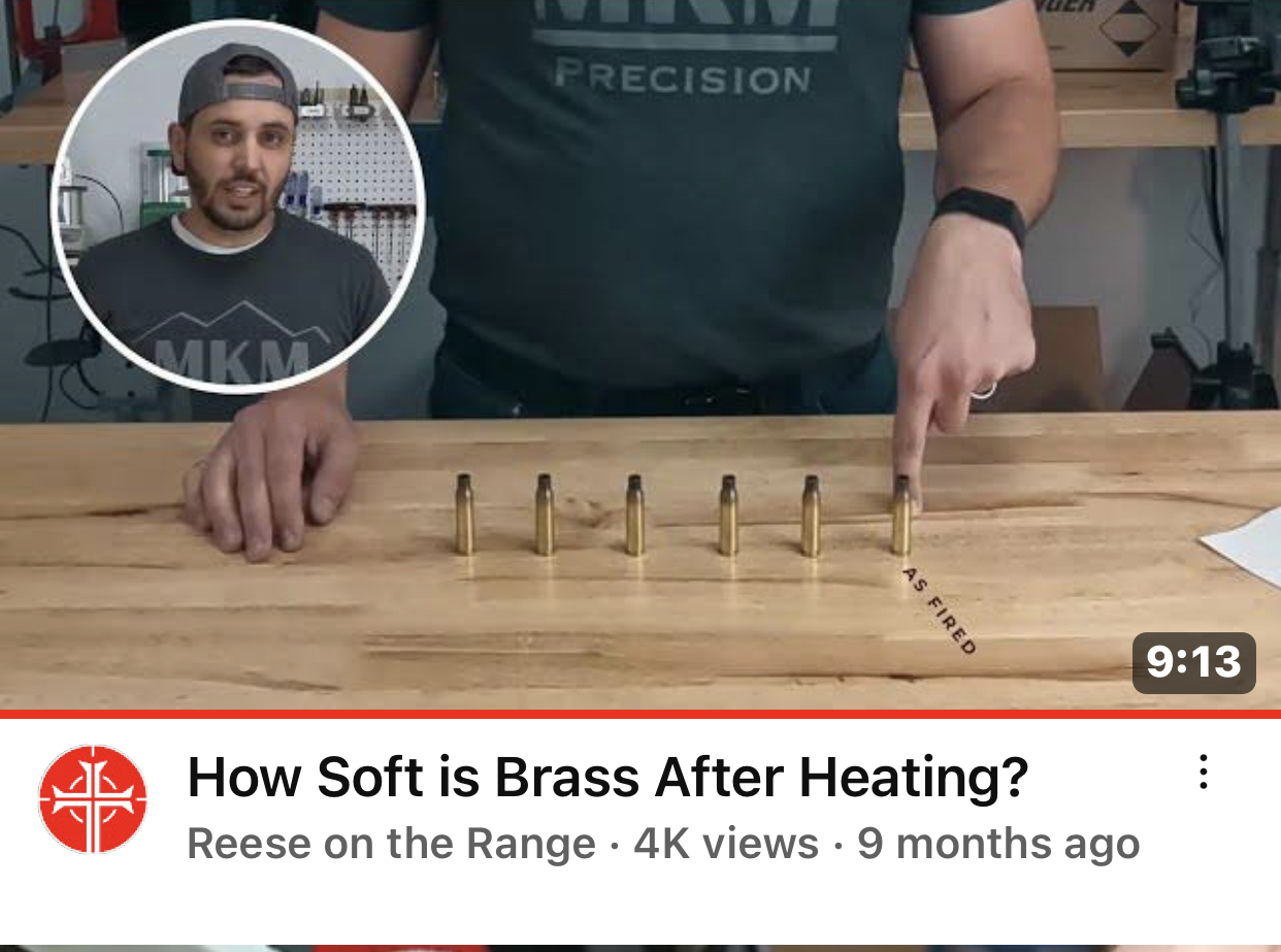

I agree there’s 2 really good videos on YouTube. I don’t know how or I would link them. Basically once you get the brass to between 90-105 hardness which is what AMP shoots for. This is around the time when the neck begins to glow. Also once you run that same piece of brass through your sizing die it’s back to basically virgin brass hardness. I spoke to a few accomplished short range Benchrest shooters. They told me they don’t bother with annealing
.However they said that the the long range guys do anneal because they are more concerned with ES/SD. Actually I’ve read where a coupleoc sr Benchrest shooters said they had to refire their brass after using an amp to get it to agg. again. Definitely interesting.

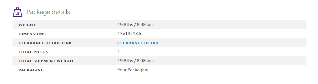

Midwest US. The package will likely get processed through Chicago (O'hare Intl Airport) Customs brokerage hub due to it being the closest. It either gets processed at the facility fast or it gets stuck in a multiple week limbo, before it gets sent to the closest FedEx hub and onto a truck for delivery.
First email was for a price quote shipped to the US, Nov 18, 10:30am CST. Requested invoice same day and received below as response.
Received invoice Nov 29th, 2:10am CST, paid invoice around 9:14am

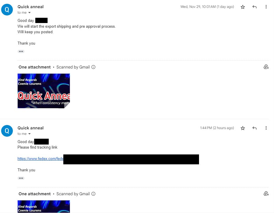

Received very quick response after payment about shipping. Then received tracking today via email, although technically I knew about the tracking number already since I have a FedEx account and was sent an automated email.
