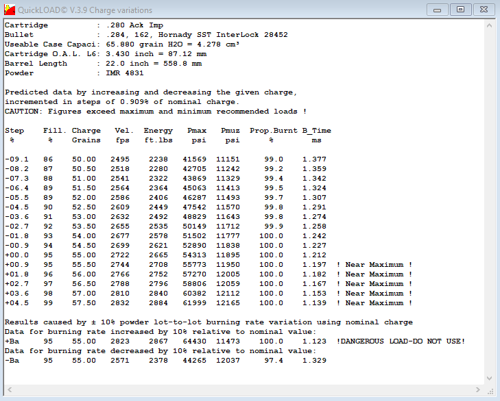

I decided to let the sitting administration buy me a hunting rifle with the money I didn’t ask for-
I’ll be picking up a Savage 110 High Country in 280AI this weekend from my FFL. Of course I decided to get a new caliber in the worst time to do so.
I’m not looking for a discussion on the merits of my choices, or better bullets/powders, 280vs this or that, etc-just curious if someone could help a guy out with the data.
I’ve been able to get IMR4831, Hornady 162SST’s, and Nosler brass-and feel mighty lucky to have found a decent amount of each.
280AI seemed the best fit for my lack of an “anything in the lower 48 I may hunt” niche, and the model I picked at 8.1lb plus scope will make my shoulder surgeon happy. I am looking to save time and materials with what I have using my favorite OCW/OBT practices and have scoured the internet, but there’s been no shared QL data for my combo, especially the 22” barrel
If someone could run these numbers I’d be very appreciative.
-280AI, 65k psi max
-22” barrel
-162gr Hornady SST (a run for 162 Eld-X would be awesome in case they ever resurface)
- 3.430 OAL
-IMR 4831
-Nosler factory brass (73.8 H20 capacity)
**a spread of all powders that run 90+% case fill and 95% powder burn for 22” with 162 ELDX at above variables would be extremely helpful for future load development as powders become available also
Here's what I get with those inputs, starting at 50gr and going up in 0.5 increments. If you want a different start or increment ... let me know.

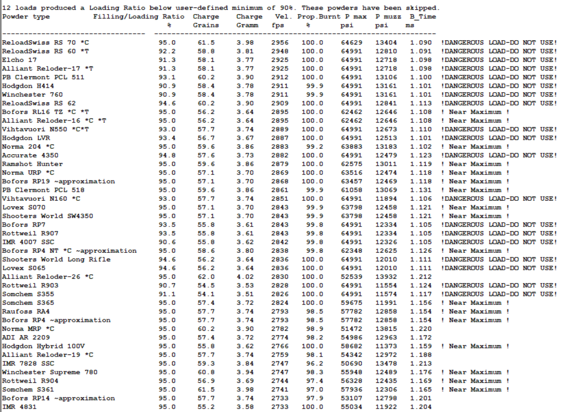

If you’ve got time to a spread of all powders that run 90+% case fill and 95% powder burn for 22” with the same case/bullet variables that would be awesome for future load development as powders become available.
Thank you sir!!!
Um ... not really ready to be your "Load Data Bitch" ... but happy to give you the QuickLOAD purchase link if that will help. :ROFLMAO:

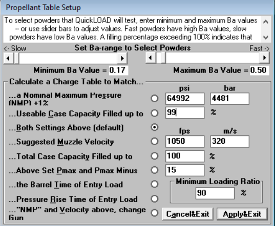

It's easy to get a run of powders for a specific fill % and max pressure, but not the combo you're looking for:
Here you can see 95% fill and check for the powder burn %
Seriously though ... if you have another specific run you'd like, for a probable second choice, I can do that for you. But shopping powder inputs through trial and error isn't on my weekend agenda. LOL
Rusty
Fair enough, I appreciate you taking the time you did!

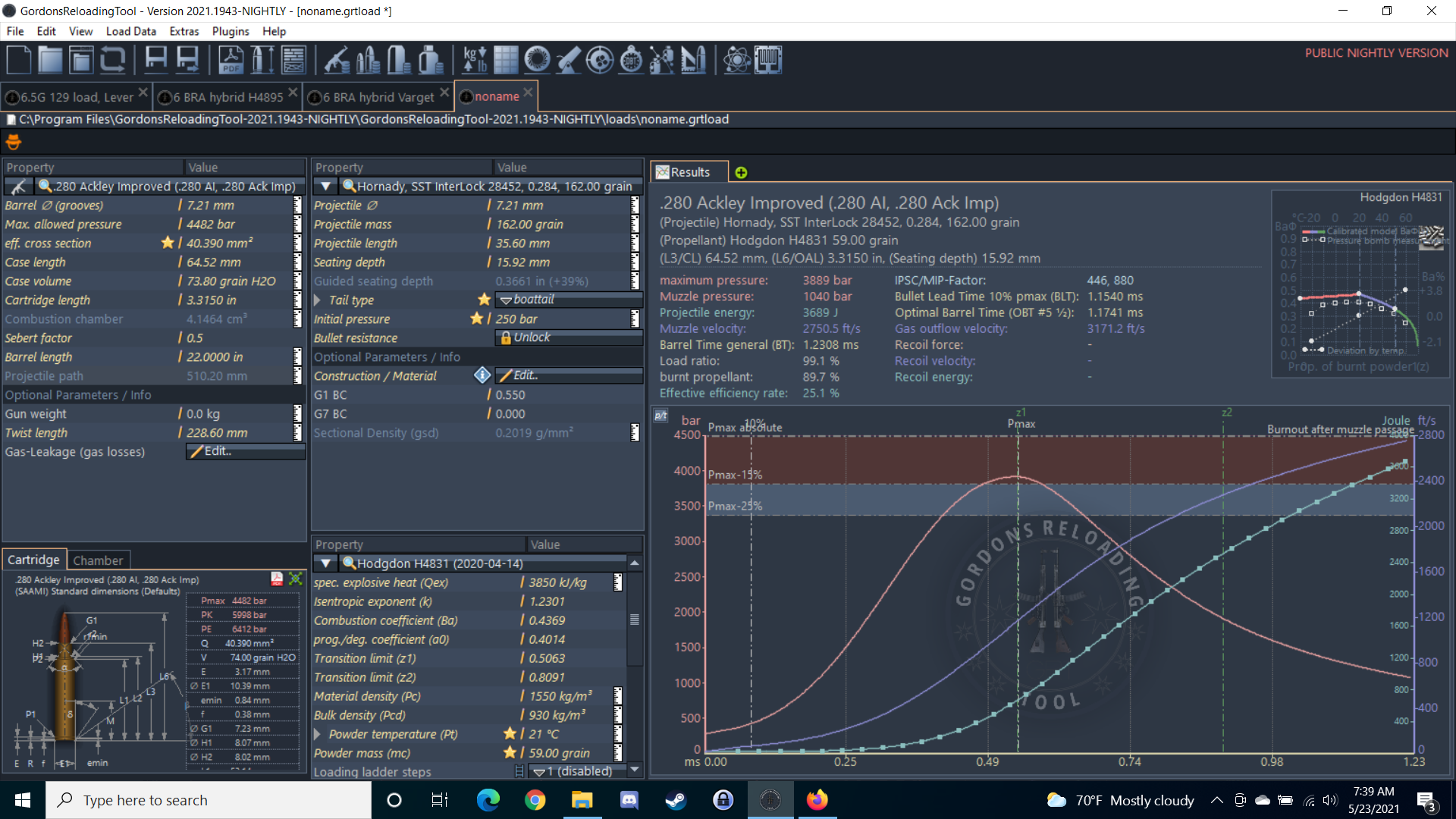

Anybody asking for Quickload data should really download GR Tools for free. I don't have the former but the latter is definitely more modern, full featured, and is reasonably close to my loads.
Edit: GR Tools is lacking any data for IMR 4831, but here's H4831:
This is what I use and it’s usually quite close.
Pretty cool, I just ballparked case capacity off Nosler’s site-any other reloading manuals give case capacity with seated bullet (I used brass capacity H2O and pressure seemed way low)
-edit: I just trimmed URL to find home page and instructions, then watched the bloke’s video on measuring usable case capacity-pretty slick!
