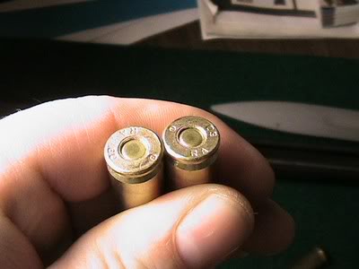

    The RA Brass I have all have rather deep primer pockets. (See Photo) Other than that they shoot just fine.
    Terry
