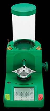

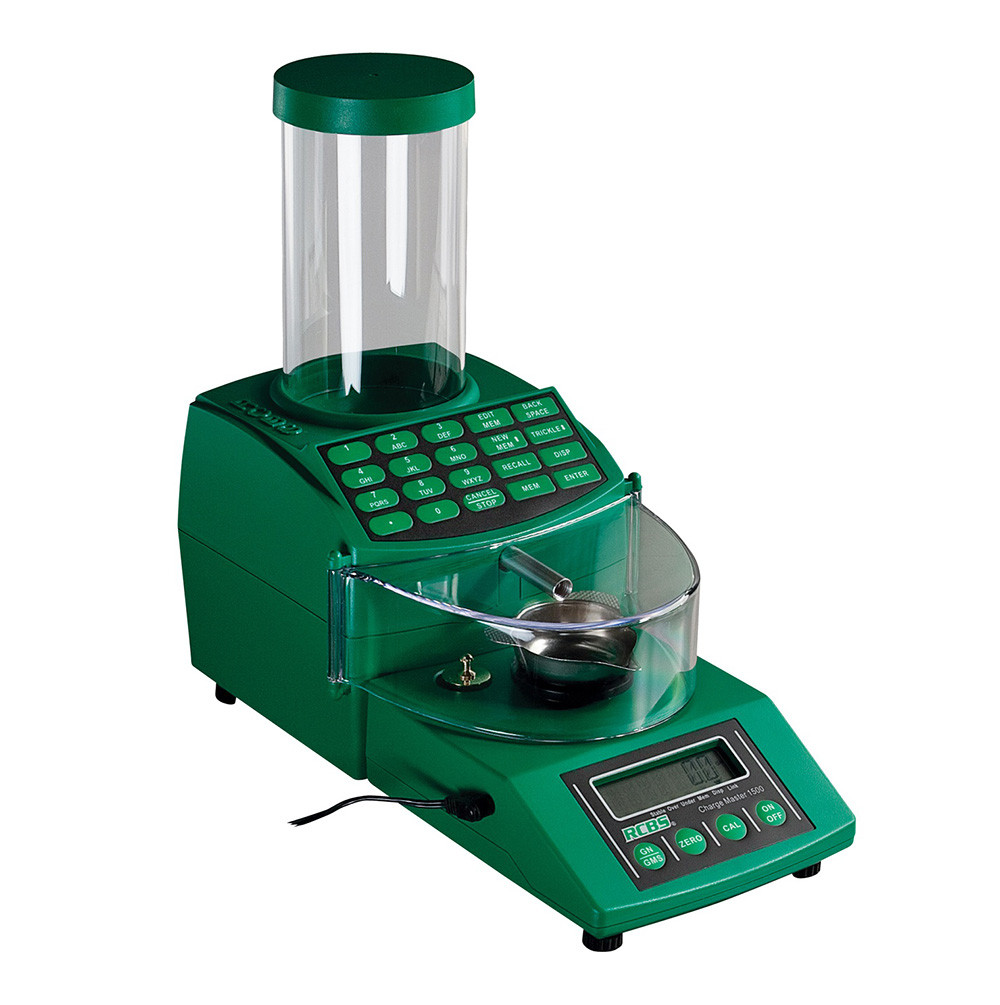

Thats a really confusing post.... but basically there's two Chargemasters:
The Chargemaster 1500 "combo" which is what you linked and is the original and more expensive unit
The Chargemaster Lite, which is the same thing but slightly smaller, all digital and about $100 cheaper.

I have a 1500 and it works well. I had some issues with extruded (log) powders until I added a piece of drinking straw to the dispenser tube. The dispenser tube is threaded and the extruded powder tends to clump up on the threads and fall out in chunks. There are also some more professionally manufactured devices, but the straw works fine for me.
The main original is the chargemaster 1500, which is usually 225-300 depending on the sales and rebates. Its a combination dispenser and scale. It is .1 grain accurate and when dispensing it has a variable speed motor, it goes fast when it starts and then steps down to slower speeds as it approaches the entered charge weight to speed up the time between completed charges.
There is the chargemaster light which can be had for around 175-225 depending on the sales. Its the smallest and slowest as it isnt a variable speed motor and I dont think its programable but it reads to .1 gr of powder just like the 1500.
