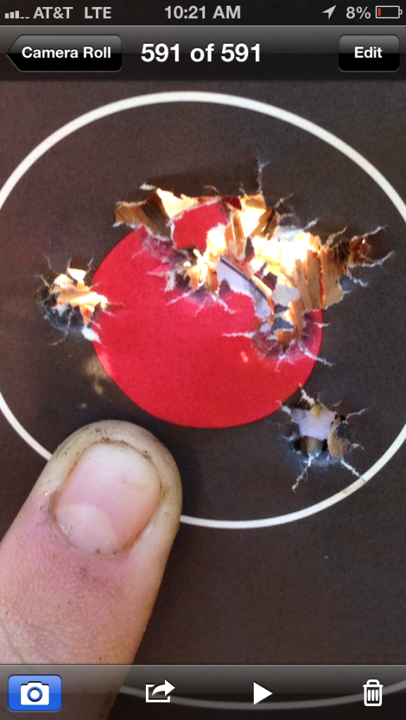

    I recently bought an AICS 1.5 for a build I was working on. For the hell of it I dropped an sps Tac .308 in it. It shot great. Even took it out to 925 yards with no problem.
    15 shots at 103 yards
