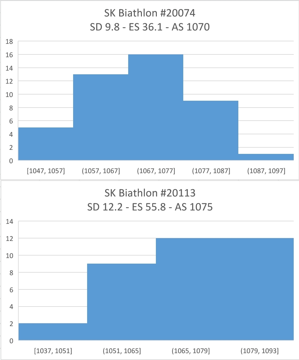

I am going to put real data here.
My sister, having no previous shooting experience and having shot my Quad earlier 4 weeks ago approx 100 rounds.. She shot this paper on Sunday and it includes warmup group (center target). After wind settled for a moment she emptied 15 rounds and got that within 1,5".
And these SK Biathlons do not run the best in 55yd testing either, barely 0.5"
I believe you NM.
I had a couple boxes of the SK Biathlon Sport, did surprisingly well at 200 yards.
Very tight ES, less than 40 fps for 50 shots each box.
Ordered a brick for further review, results not as good.
Better than bulk rimfire, but like all the SK line, these are midgrade 22lr.
Some boxes will produce results above their grade, but not all of 'em.
To be expected with 15 to 18 cent per round 22lr.
Reactions: Near miss
I believe you NM.
I bought 2 boxes, got 2 lots.
Tested around 50 of both and got good results. But accuracy is not there. These could be killers at 100 and beyond from another barrel.

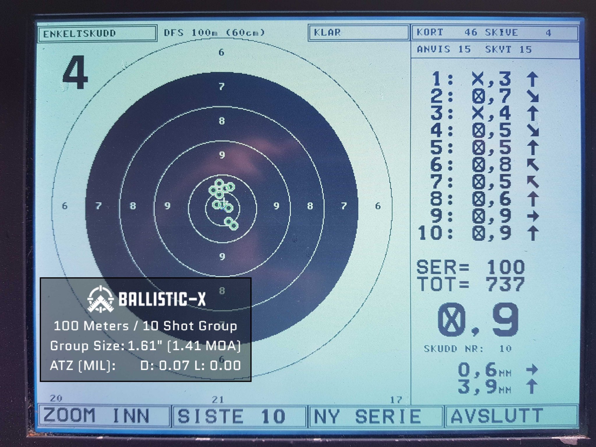

As another who just started with rimfire.. (1 year ago, maybe 12000 rounds in.)
A shooting advice, keep it together. 2MOA is ok, shooters and ammo have ups and downs. And progress does not always go forward or just stalls.
I concentrate very much to the accuracy of the "background group". If I shoot 3 good groups but they are not in the same POI it is not a great win.
This is why 6x5 is a worse measuring way than Justin's 50 at same target. (Not bashing 6x5 thread, I will be posting mine in near future)
When I leave the range I take the worst groups with me and analyze them later on. In my opinion it is not the amount of good groups that make a good shooter but the lack of bad groups.

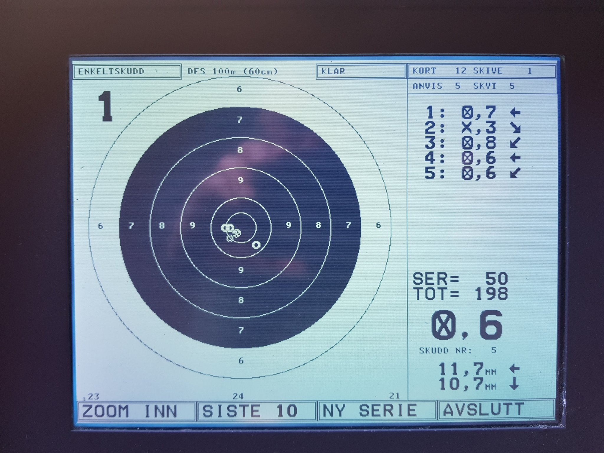

I have a CZ 455 varmint and got the best 6x5 of my life with it. I could never reproduce it. I'm convinced it was a fluke as my gun is a 0.6" average gun, on that day it averaged far better. As my shooting improved, my frustration with the gun went up. Gun is on sale and will go soon. My point is, you can't expect a $500 gun to knock your socks off in any category. It's a $500 gun and for that it is a great gun. I loved my gun when I first got it. That love affair ended once I started to see that my groups would open up and there was nothing I was doing to cause it. I could spend thousands trying to improve the CZ...I'm about 1200-1300 into my CZ. Without a new barrel! I'm sure if I put a new barrel, custom fit, ferry magic dust by the big name gunsmiths, and another 1000-1500 into it, I would have an awesome gun that shoots .2-.3 consistently. I'm just not the guy for that. If you look on the FS forum, there is a guy trying to sell a DJ rifle that he has damn near to 3k into it for 1900 and its still there. I think its been up for sale for at least 9 months or more.
I think reasonable expectations for a factory CZ is 0.6-.9" groups @ 50. Anything smaller then that consistently I would consider an excellent gun. Enjoy your gun. Have fun, keep at it and you will find yourself going down the rabbit hole like the rest of us....22LR will drive you insane. :)
@EddieE thanks. that puts things nicely in perspective, and i see others have agreed with what you wrote. Helps me not to feel totally incompetent :-0

My goal is to be as accurate a shooter as i can be. first prone/benchrest (mainly so that i can find out what the limitations of the gun are) then kneeling, standing. PRS looks like fun but we don't have anything like that near me - all competition here is 6.5x55.
Hummm... just learnt something fundamental - many thanks for your section on calling the shots - i thought i was already doing this, but now i have to rethink this :cool:
