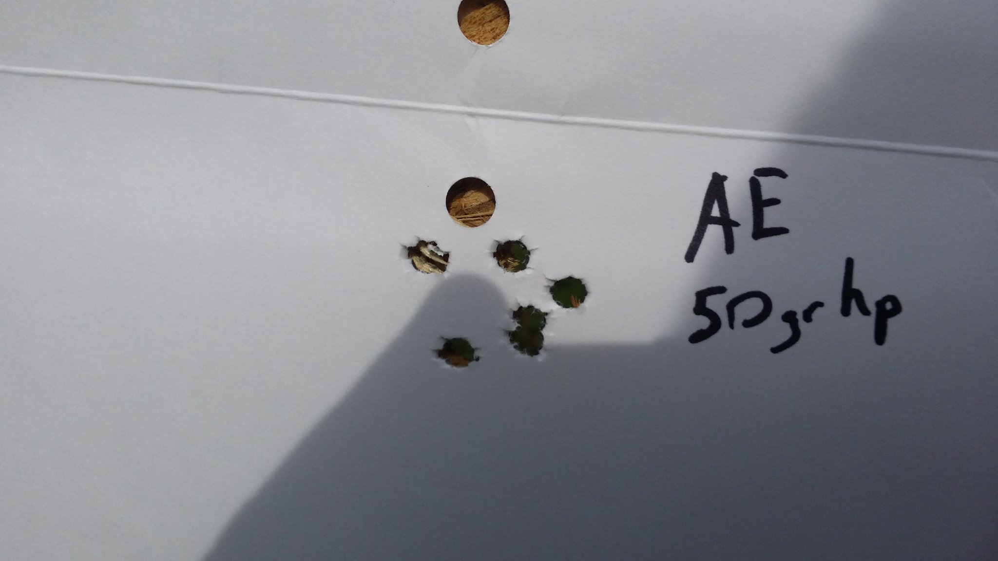

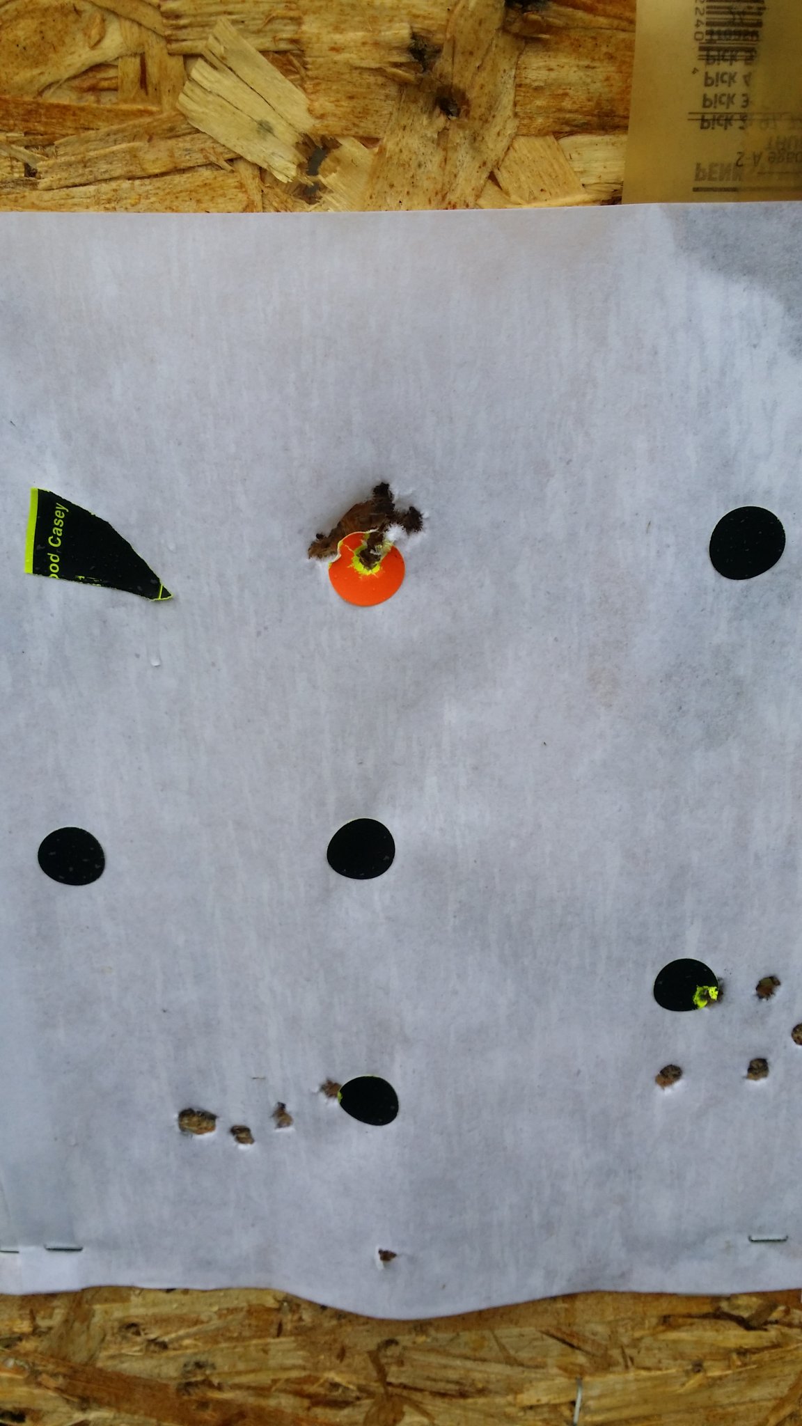

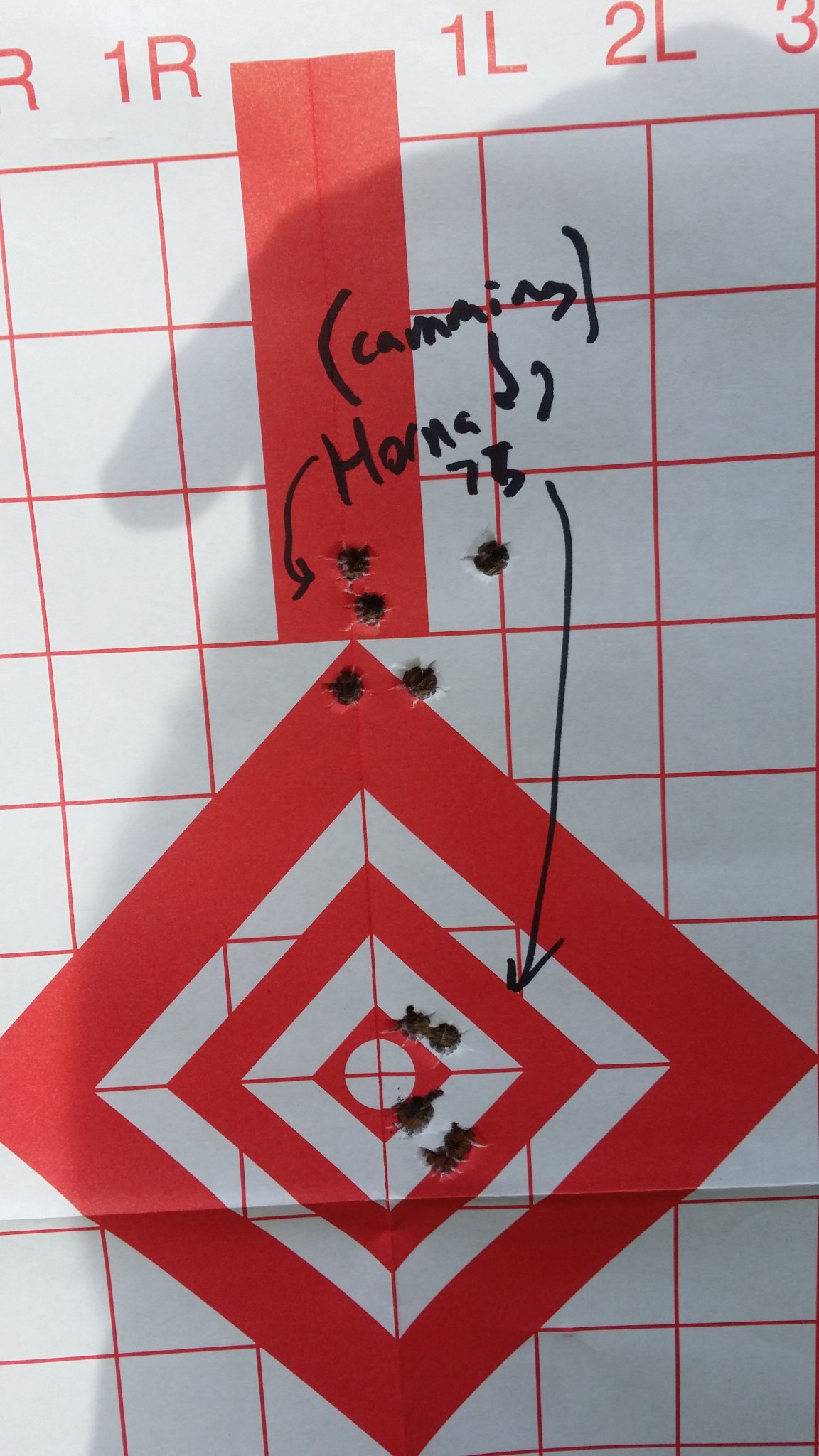

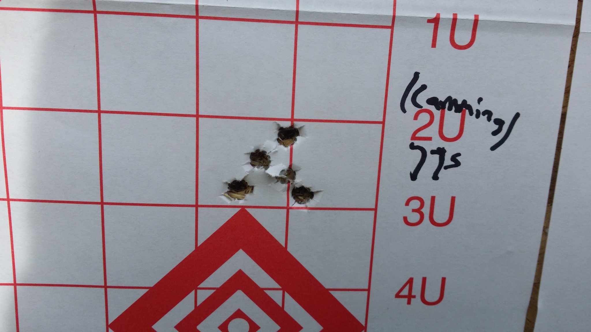

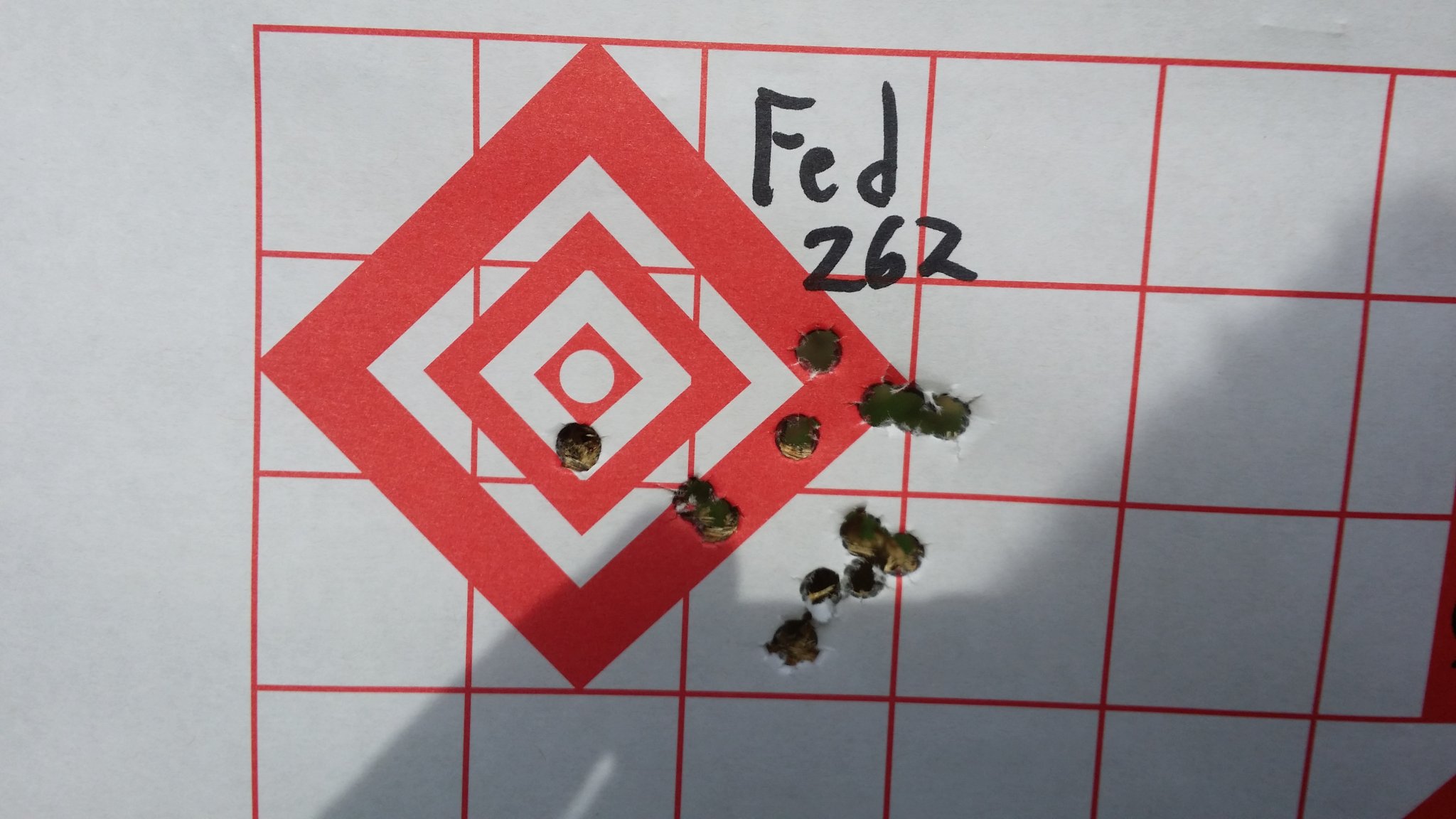

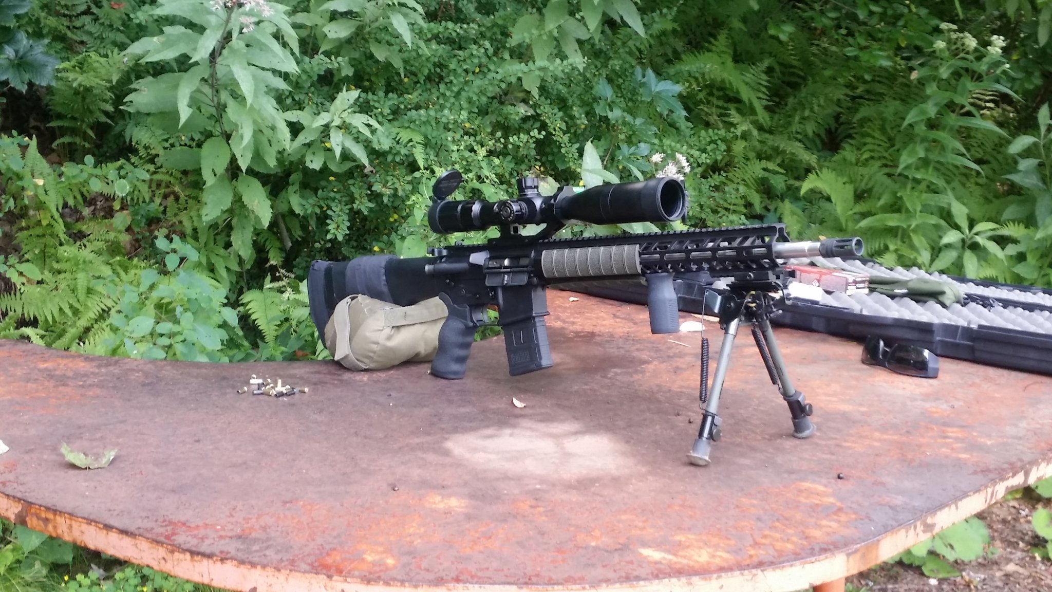

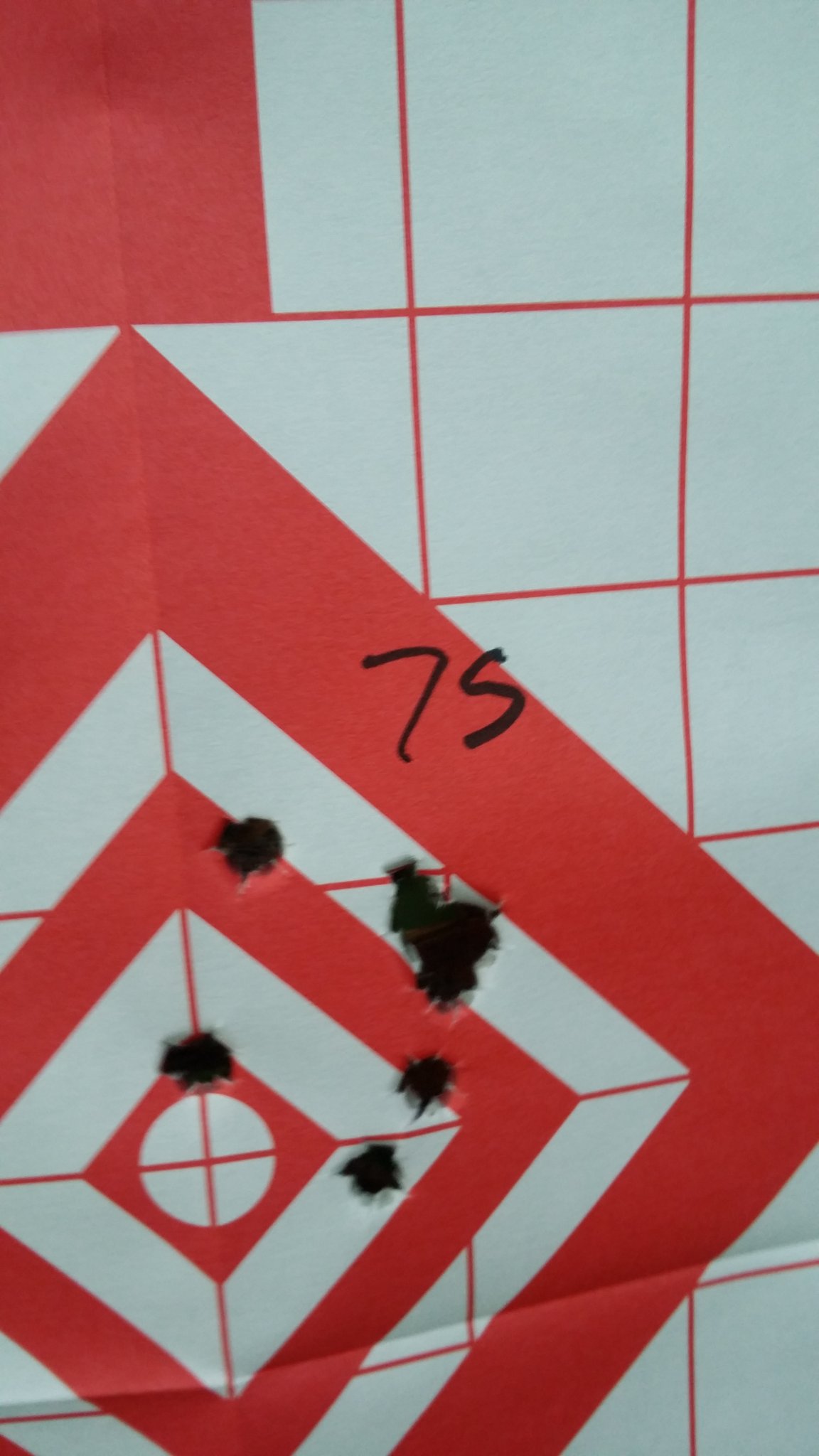

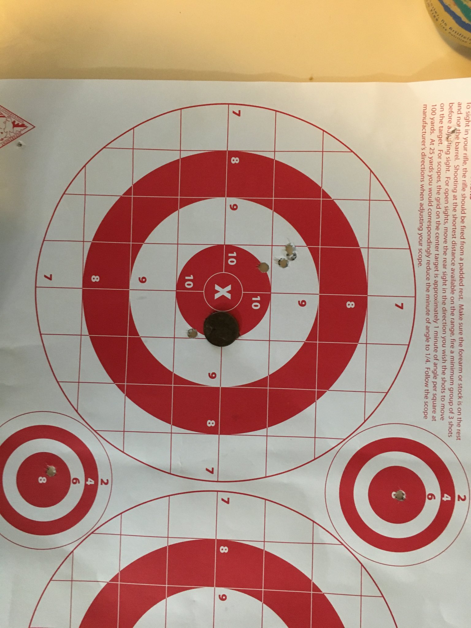

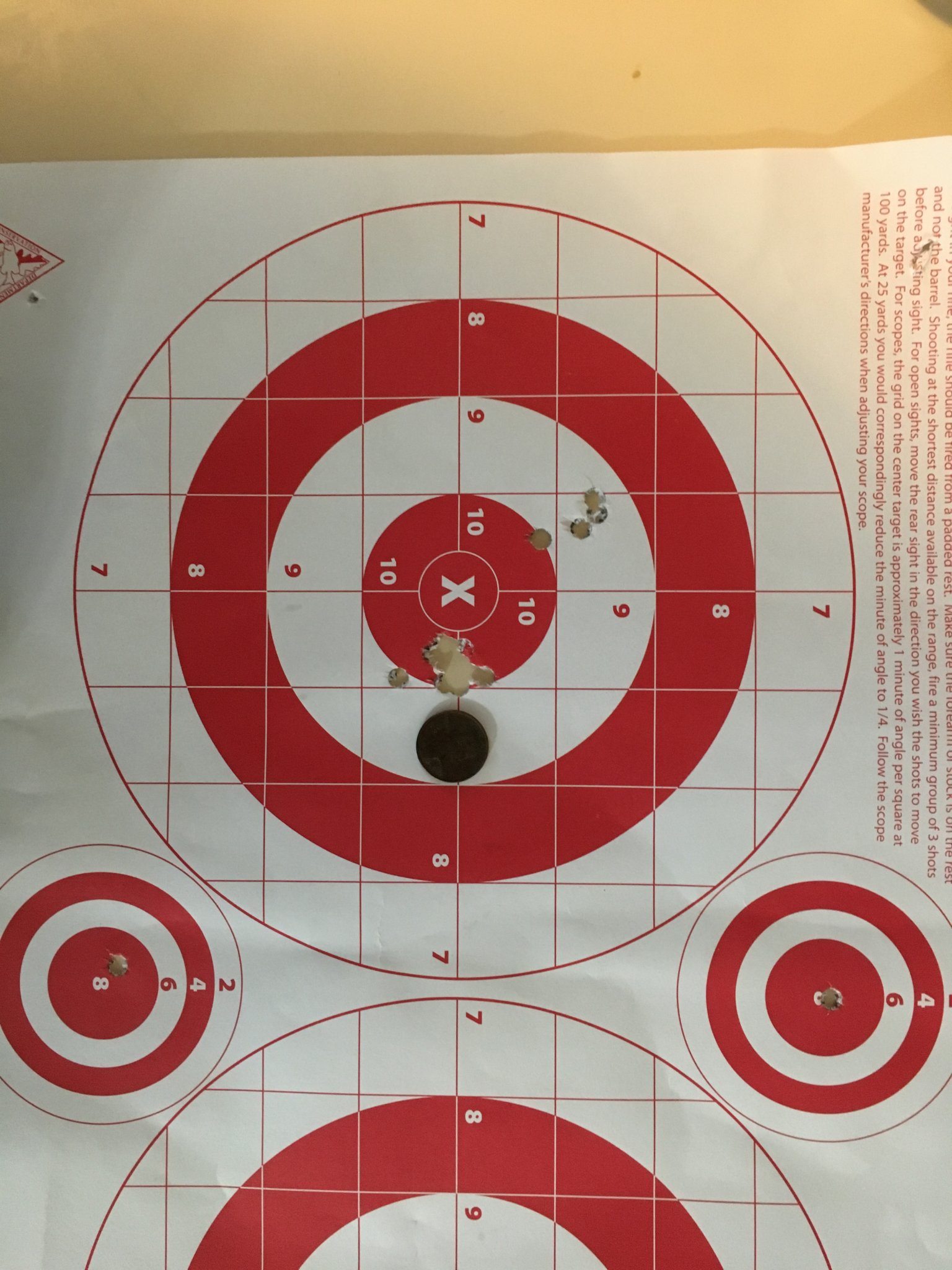

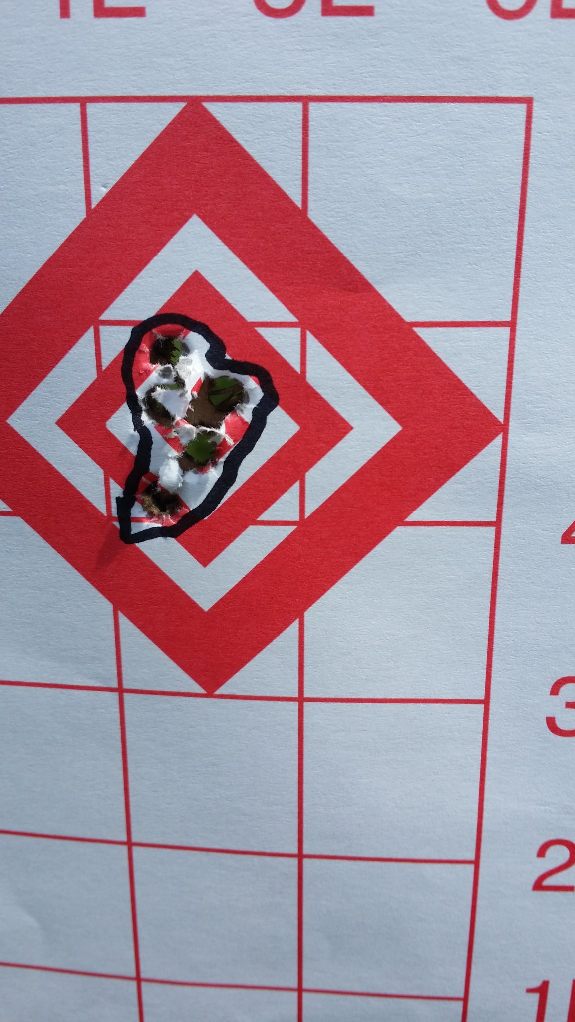

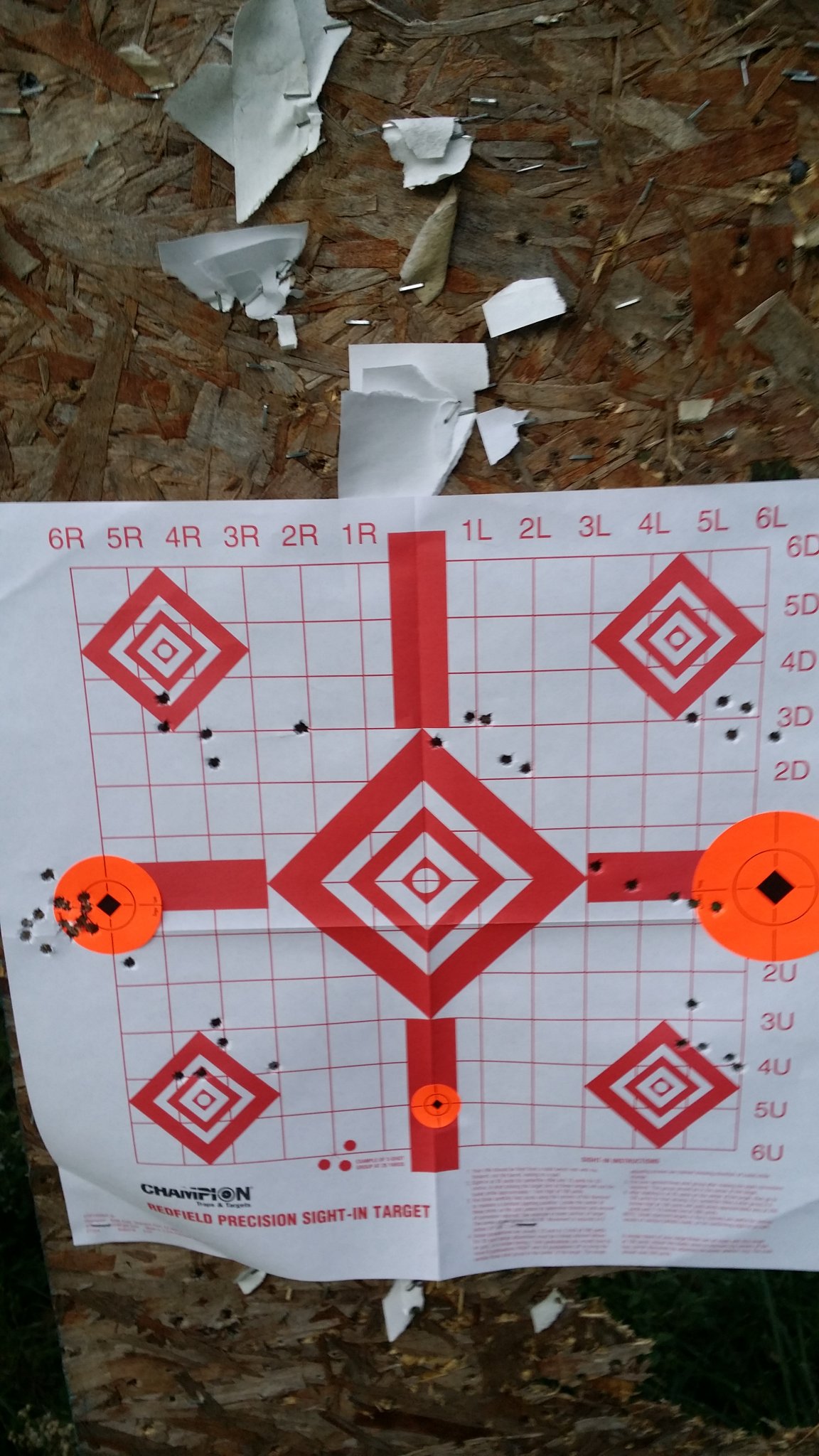

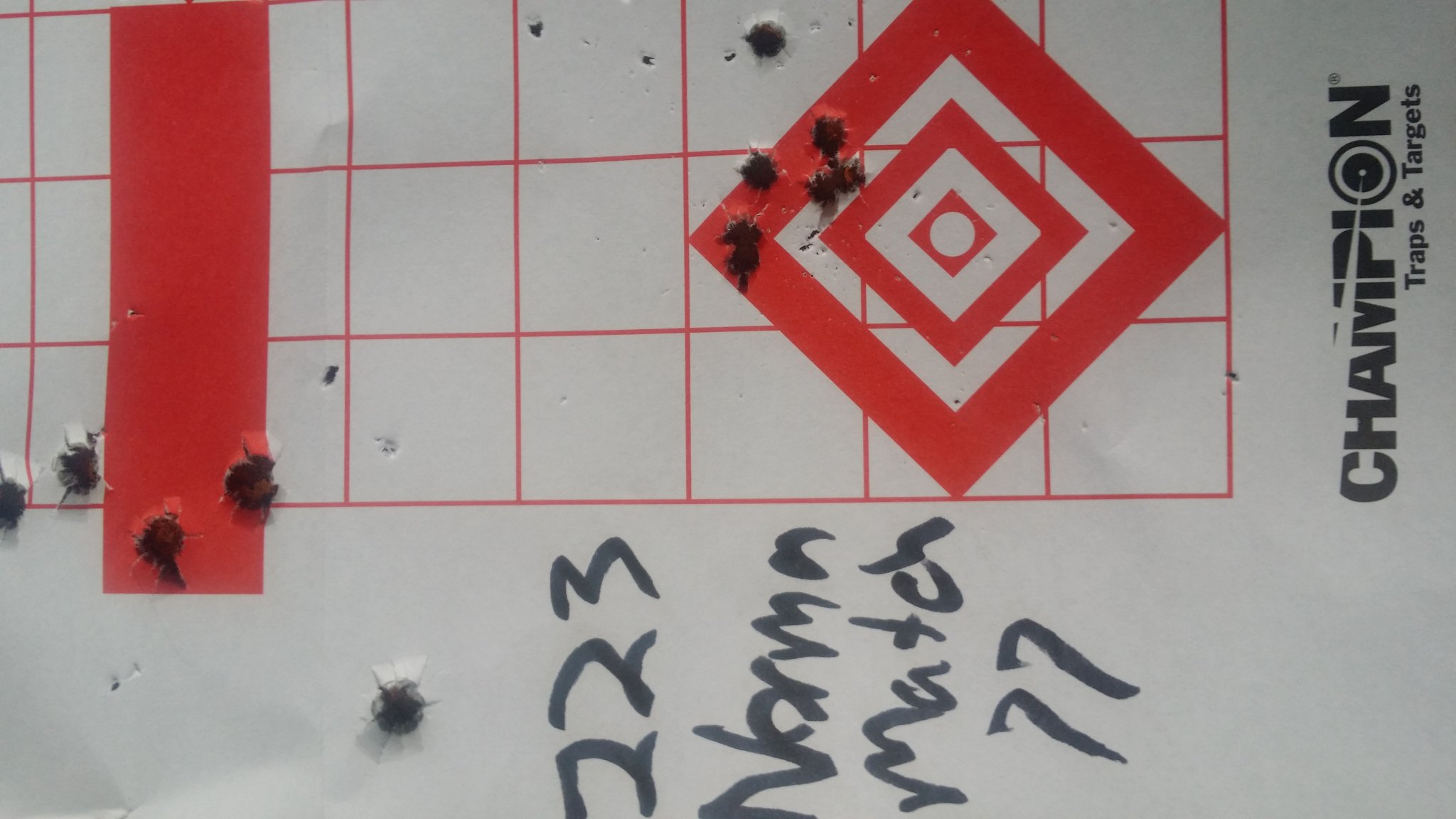

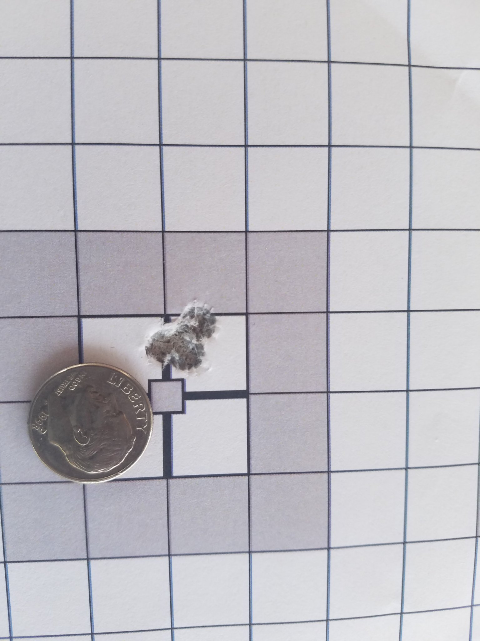

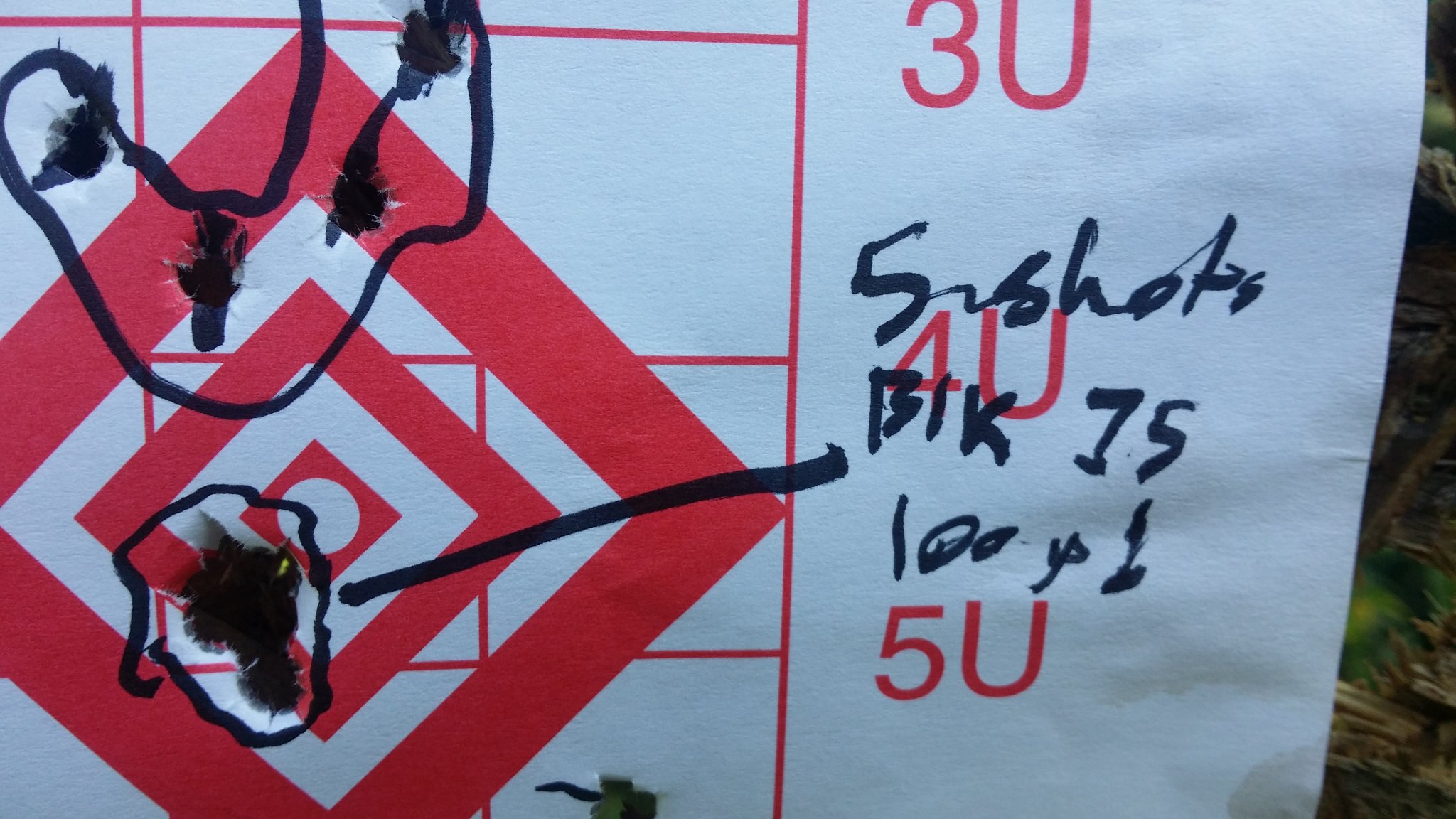

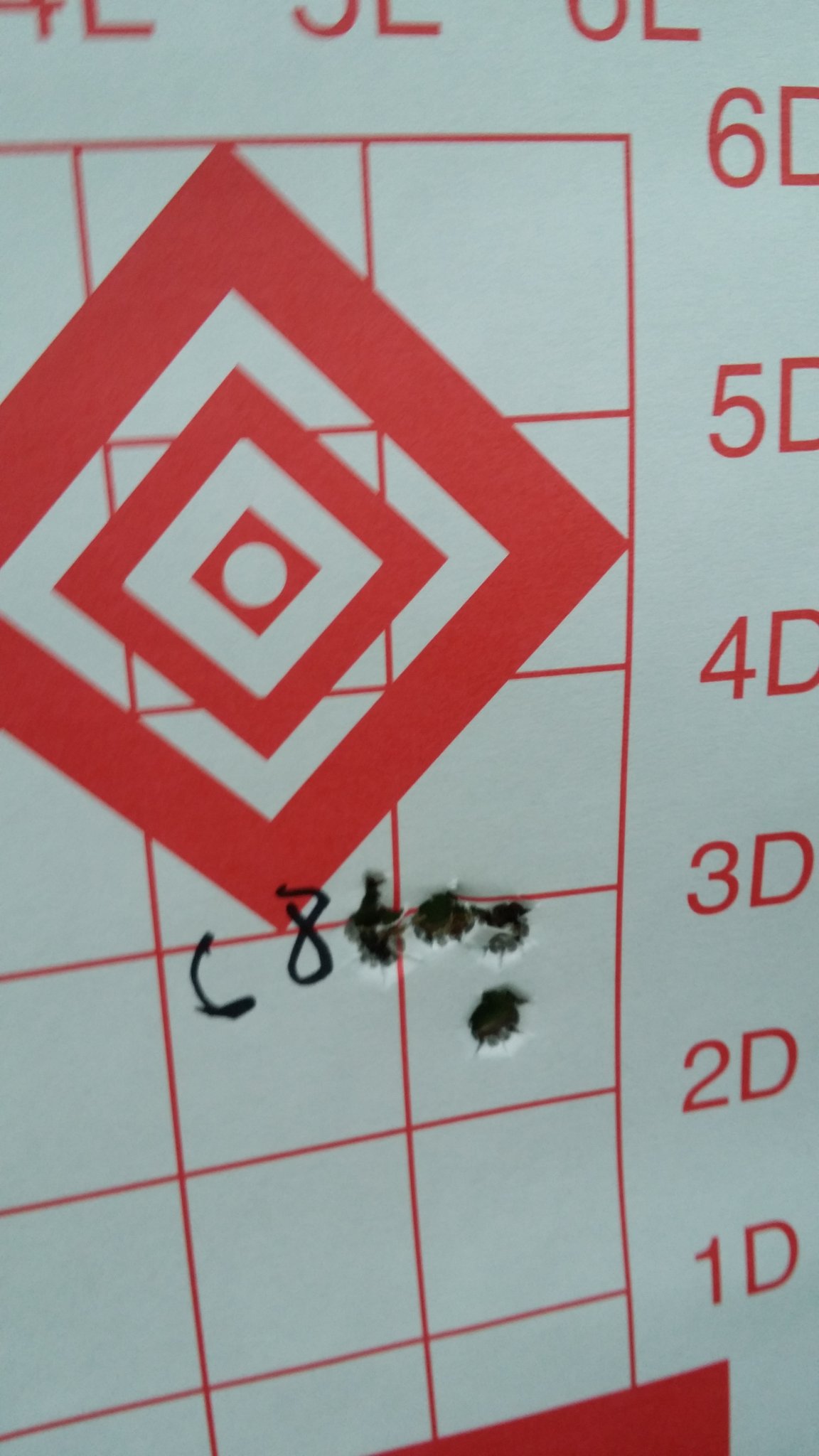

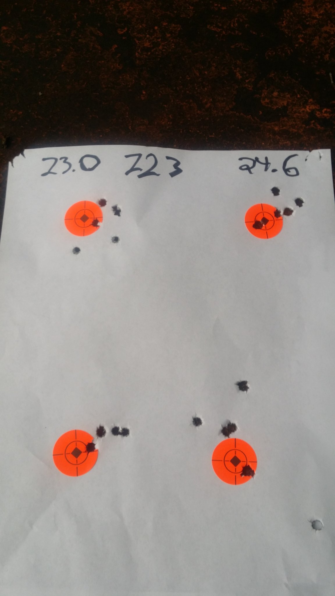

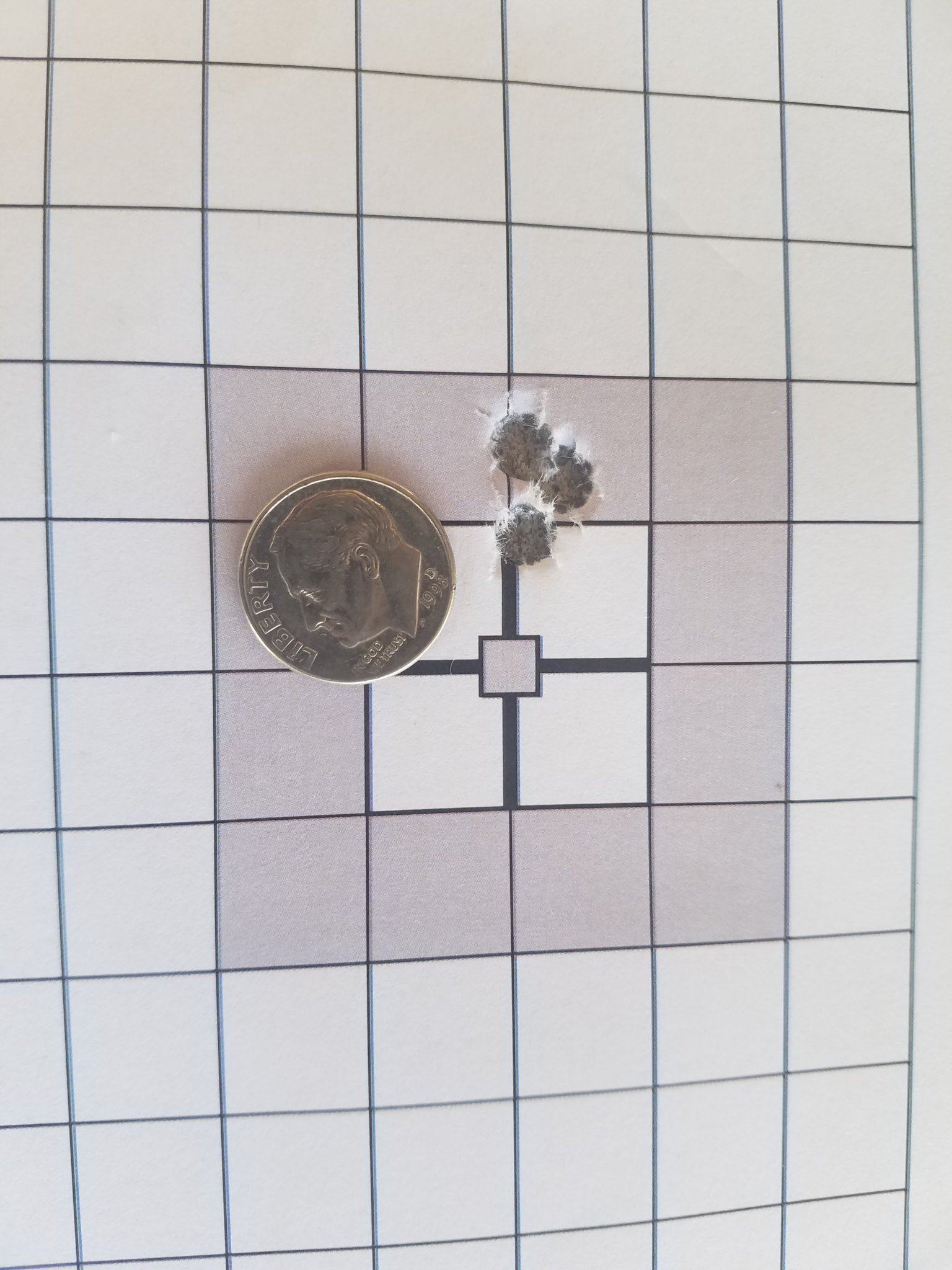

Just started handloading for my 18" 223 wylde SS PSA gun. Using 77s and 75s. It has shot manu sub MOA groups with Hornady Black being the favorite out of all the factory ammo even better than Hornady Match 75s. I assume because the gun likes slower ammo. Here are some groups of my first try at handloads with Hornady brass, CCI br primers, varget and 77s/75s. And the one tight group is how it shoots with hornady black about 1/3 of the time. Also a group with Norma match which it seems to like the best.
I dont care if the load it likes ends up being a little slow I just want some accuracey 99% of shooting is 700y max.

If you’re asking what’s reasonable to expect day in and day out, I’d say .75 moa is very attainable. A good, accurate rifle, that is still very reliable should be able to lay down .75 moa. Now, if the shooter can do that or not is another story. I have AR’s in both large frame and small, and shoot gassers more than my bolts. I don’t personally feel under accurized when I’m shooting gas guns, BUT, most will shoot a bolt gun better. When you’re talking about locktime speed, follow-through, unusual positions, etc. that all favors bolts.
I guess I’m saying this: a gas gun can be as accurate as a bolt, but day in and day out, bolts are easier to shoot accurately.
Shooting gas guns as precision rifles is challenging. When I shot long guns for a living, I could routinely hold under 1/3 MOA with bolt guns. In some cases I was better than the gun. That was never the case with gas guns.
These days, given how comparatively little I shoot, I'm satisfied to hold 1 MOA with my 5.56, 77grn BTHP.
Ohh and don't beat yourself up too bad comparing your groups to others'. Most shooters slightly exaggerate their ability, and they rarely post groups they are ashamed of!
Assuming the trigger puller has his act together and had done good load development, accuracy is going to be determined by the barrel. I've had many WOA barrels that would readily shoot into 1/2" consistently. I have one JP barrel that shoots about the same.
I've also had barrels that were good for no better than 2" no matter what I did.
My personal expectation in a precision AR is that I want to hit the 1/2 minute mark pretty consistently. I'm talking about true accuracy testing, not field shooting. I do my testing indoors in perfect conditions to eliminate as many variables as possible. I'm living with 3/4 minute in a particular rifle that has a particular purpose, but I'm not happy about it. The last rifle I had that didn't meet my expectations went back to the manufacturer who is re-barreling it as I type.
As you are surely aware, it's difficult to judge the accuracy of a rifle if you're not confident in your fundamentals. It's a tough problem to solve. In my case, I frequently take a known great gun with me when I'm testing something new. In my case, it's a JP. I flop down on that first and make sure I'm still shooting groups in the 3/8" range before moving on to the new gun. Without that luxury, you're left wondering how much is you.
Reactions: DeftSystems
Imiss finding that it's all in how you load, setup and handle the fun. I'm finding tighter groups when I cam in to level the bubble while loading the bipod taking out tthe slack between upper and lower.
For an off the shelf rifle, I'd expect 1MOA or better, 1.5-2MOA from an inexpensive gobang-toy and mil-spec ammo; and if you can get that off the shelf rifle down to 1/2MOA you're doing especially well.
For the most part I've got factory rifles and uppers of several flavors, and work at marksmanship skills and load development to draw out the Rifle/Upper's better potential. I'm becoming a fan of the 1/7" twist, yet have had good experience with 1:9" and 75gr HPBT Match in a 24" barrel out to 600yd, holding the 9-ring or better for 20 rounds.
Some tell me the AR's are harder to shoot well, but that's not much been the case for me, using bipod and bag or machine rest and bag.
I find that a good barrel and a good trigger are the best upgrades for me. That's not especially news. The Hornady 75gr HPBT Match and Varget (23.5gr to 24.4gr) are my development components, but when going with the shorter barrels, I prefer a 1:8" twist or faster).

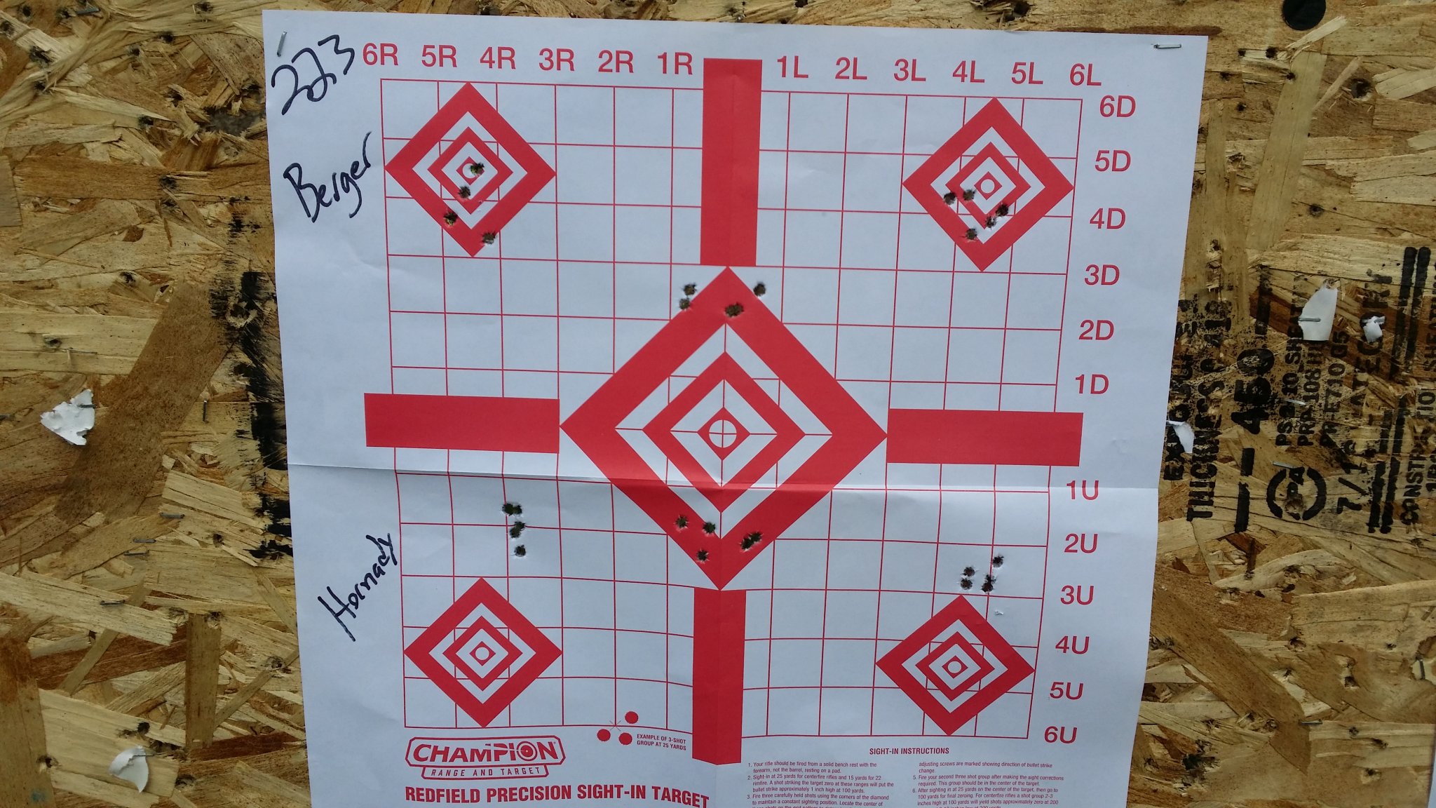

I think a nice trigger makes a difference as well as the ammo. How does it shoot at distance? I have a bunch of groups that are 4 in one hole and 5th shot flier.... heck sometimes the third shot is the flyer and the others are in one hole. I like to blame the rifle and ammo, but at some point I have to admit it's me :-/ But, I can still hit a hanging chain (steel plate fell off) at 400yrds pretty easily with PMC ammo, so at the end of the day, I don't complain.
Working up some hand loads with 75s, 77s and berger tactical 77s. Also surprisingly my 18" 223 Wylie 1:7 gun shoot American Eagle 50gr hp extremely well.
It's definitely how you drive the gun. Got a LaRue mbt 2 stage a month ago and frickin love that trigger. Prone I can consistently bang an IPSIC at 700. Going out to a range with steel out to a mile this weekend with my AR and .308 howa. Brings lots of stuff, 178 elds, 185 juggs, 178 bthps, 155 bthps, 155 elds and all the afore mentioned 223 stuff plus some Norma match 223 my gun likes with 77s.
I have found my 4150cmv PSA barrels to much prefer the lighter bullets in my reloads. I'm sure with time/testing I can find a heavier setup to work, but I'm still working on that. I'd say 1MOA or just under is a reasonable expectation with that barrel/combo. U seem to be hitting that :).

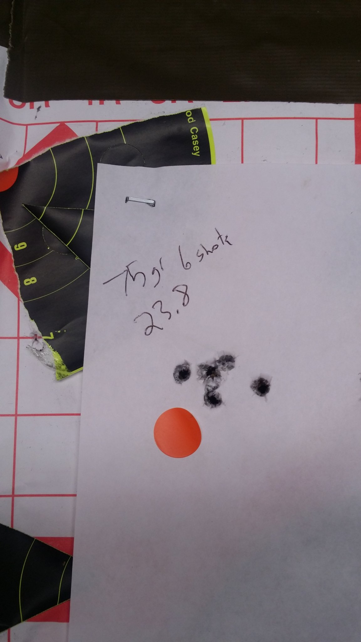

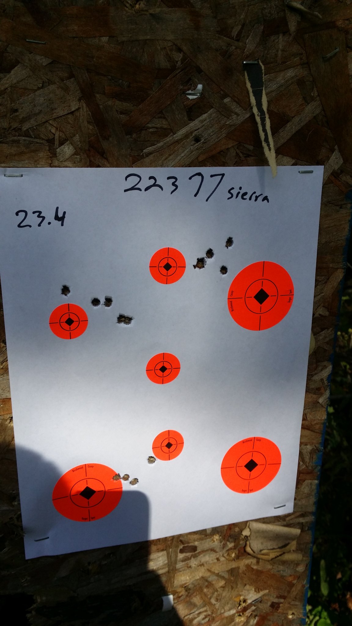

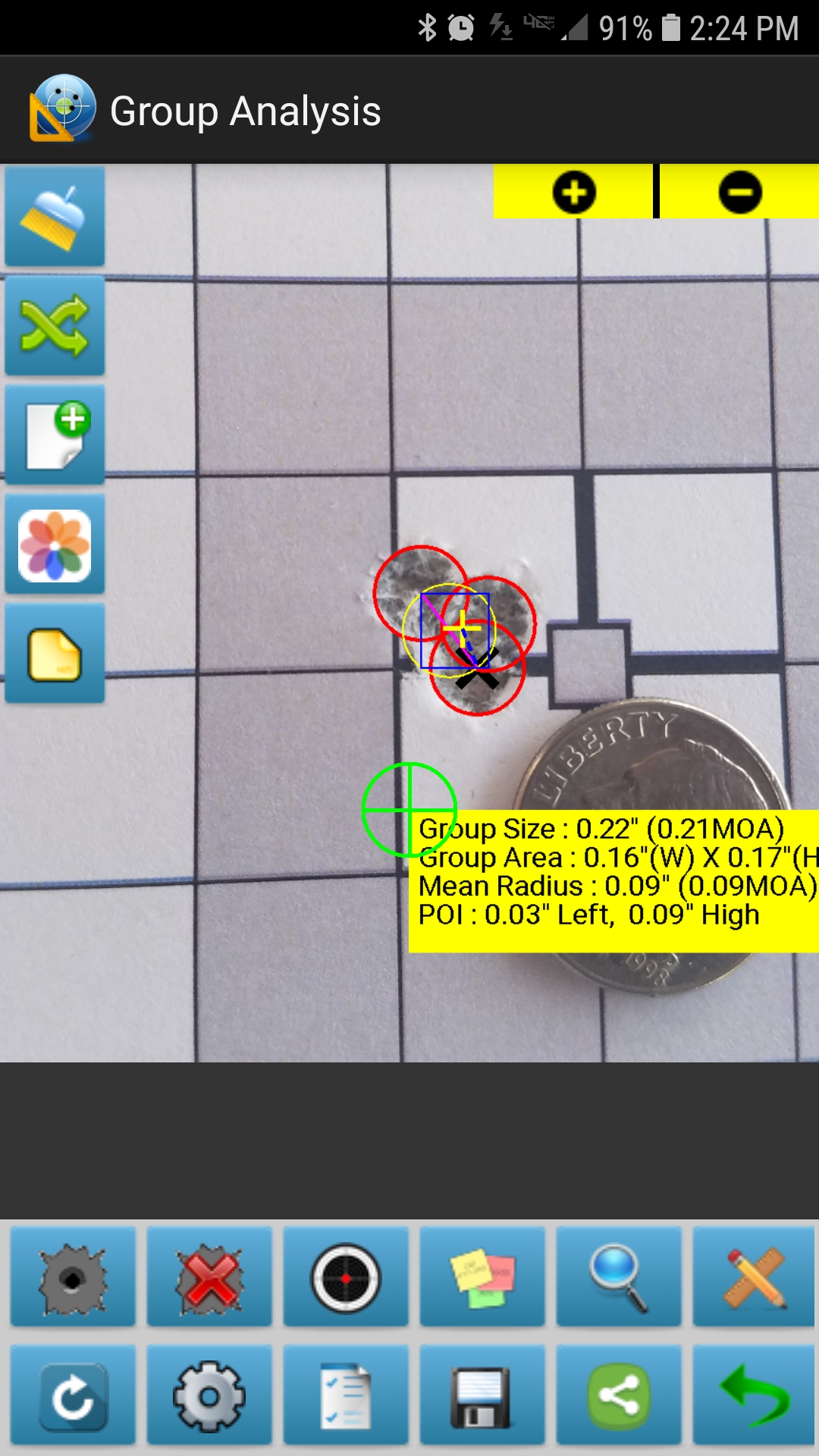

I found my load, 23.8gr varget, 75gr bthps, LC brass, CCI br4, loaded to mag length. Been shooting consistently like this. Anybody have any guess as to what velocity I'm getting out of my 18" barrel?
As for semi auto... Really depends on the rifle and it’s purpose... but for a precision semi auto with reloads. Below is realistic

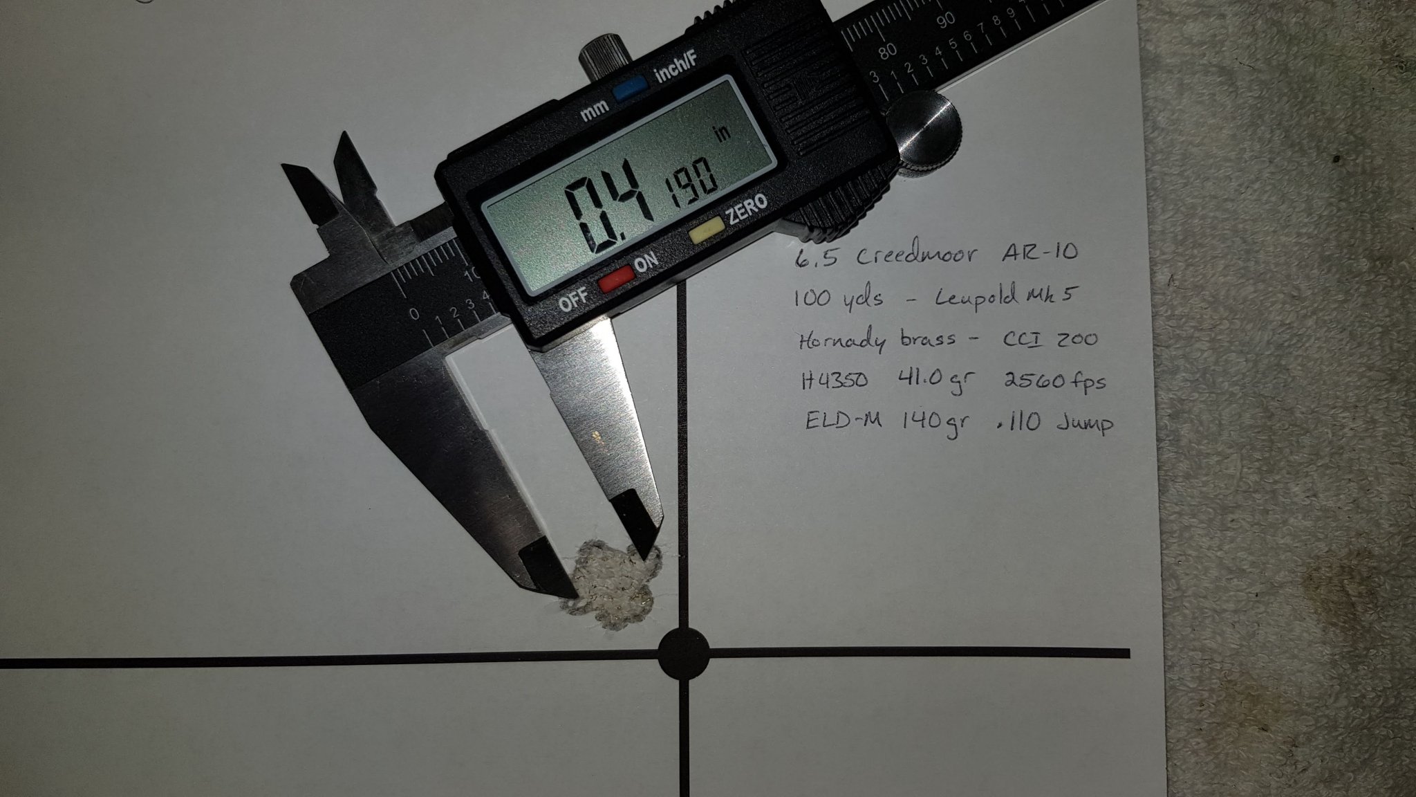

I’m not sure if it is reasonable or not, but I recently did some load development for my 6.5 Grendel. Loading in 0.2 gr increments I had 6x5 shot groups that measured 0.64, 0.68, 0.95, 1.00, 0.76, and 0.88 moa at 200 yards.
Reactions: AMP!
I just sold one Grendel I got MOA consistently out of. I have another one with a Geissele (other was a mil spec.) and haven't tried her out yet. I'll take a video of it and some live shooting for groups later this month.

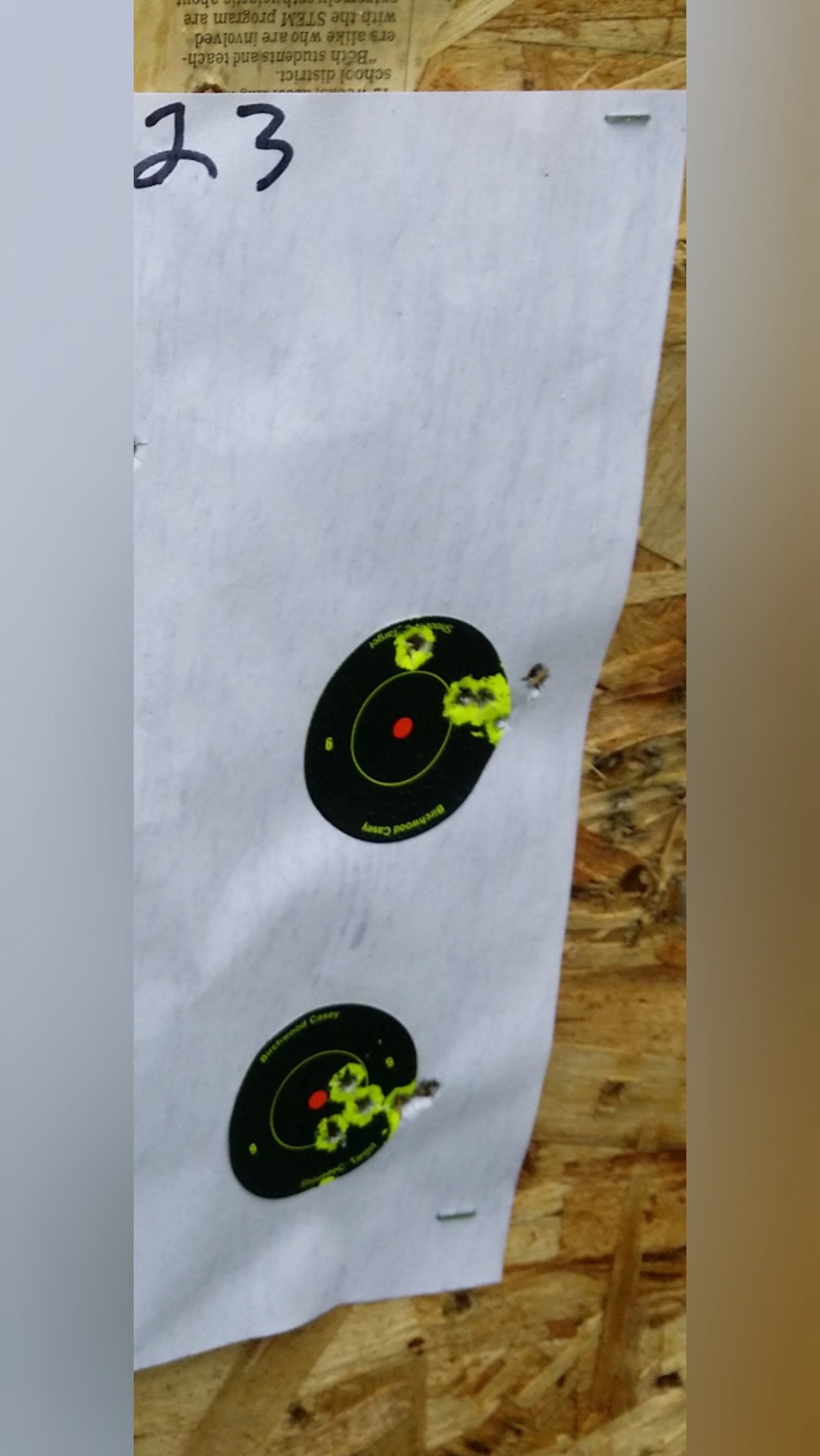

Most of us think that MOA is good under an inch, BUT here is a short story about my son., Got a phone call from him from Afghanistan wanting to know what he should expect out of his M4, seems that he was on the roof of a guard tower and had a target out at 100 yds sighting in , quick response without thinking I told him 1 moa would be good, then all of a sudden I heard sh-t this and a few others before I could get in a word. finally he listened to me, I told him I forgot he was using Military ammo not civilian stuff and that 2-3 MOA would be great with military crap, he calmed down and said thanks, sometimes we just have to work with what we have at the time.
Reactions: jLorenzo
Got that right, ammo can make all the difference. Sometimes I shoot military ammo from my .50 BMG (it's more affordable) but it's certainly no better than 2-3 MOA, whereas Barrett ammo will hold sub MOA easily. Anyway, I digress...
My personal experience with AR style rifles is that ammo and loads can still make all the difference. I have a 6.5 CM built on an AR platform that shoots 1-1.5 MOA with factory ammo. My handloads didn't shoot much better initially, but once I played around with seating depth I was able to find a sweet spot that my gun liked. One challenge with an AR is you're limited by your mag lenth, can't seat at the lands. I backed mine off in increments until I found a happy place at .110 jump.
So, for what it's worth, I've found that accuracy is attainable with an AR, however I've also found that it takes more tweaking than you might have with a bolt gun.
