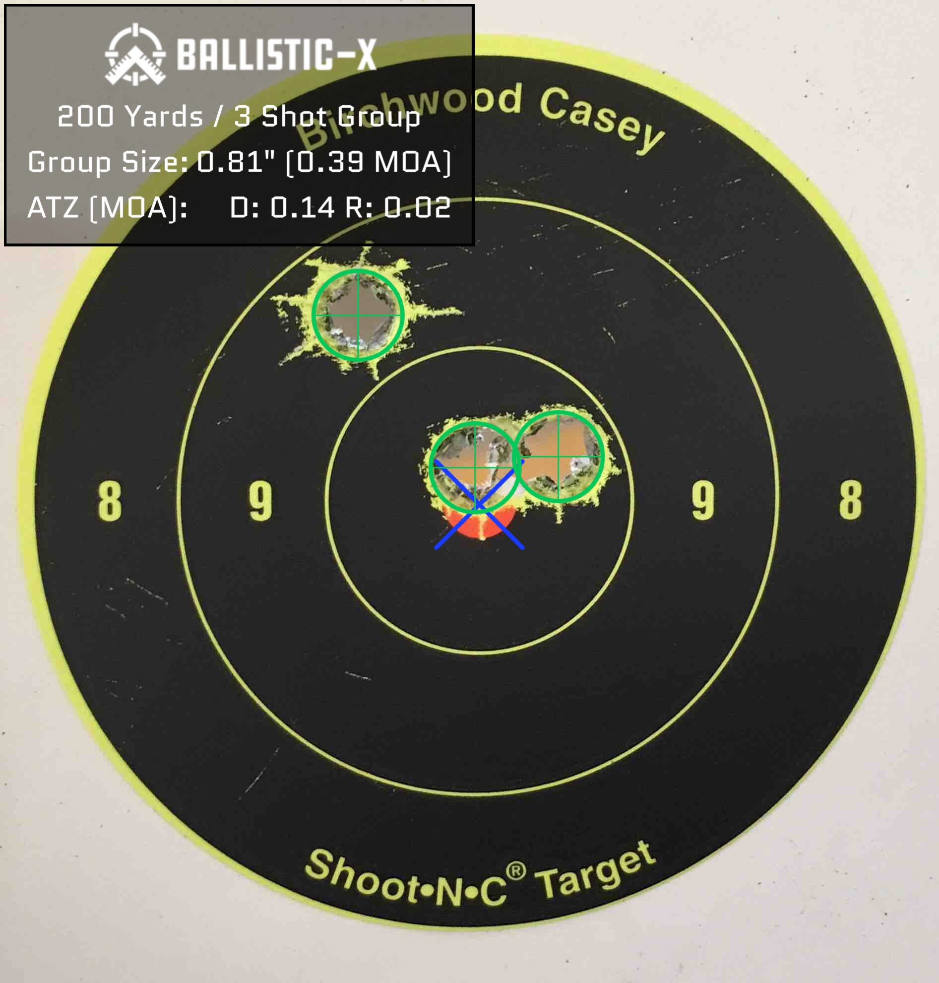

The most important factor that I've found in shooting a gas-gun accurately is recoil management, and more specifically follow through because of the elongated recoil impulse. A buffer system will certainly affect the recoil impulse, which most likely helped you manage the recoil better and thus the better groups.
When I put together my first large frame AR precision build, it took me about 400 rounds to really understand how to manage the recoil and print .75 or .5 MOA groups. It's completely different than my bolt gun too, I definitely have to increase grip strength and forward load pressure as well as over-extend how long I hold the trigger back on follow through.
Both groups below were at 200 yards on the same day. With my gas gun, I'm happy with 3/4 MOA
