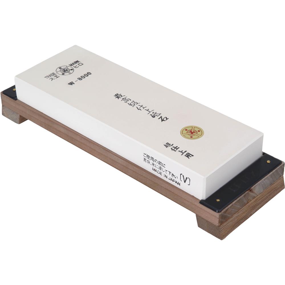

Grow up and get some Japanese water stones.
4000 grit to start (not a typo, 4 thousand grit to start).
Then 6000 grit.
Then 8000 grit.
Then 10,000.
Then 12,000.
You have to soak these bitches in water for at least 20 minutes and then liberally wet them as you're using them.
Go learn some *real* traditional Japanese sharpening techniques....not that fake ass spewtube bullshit, the real way to do it.
Don't even think of saying your (X) whatever machine can get it just as sharp....it's BS, you know it, I know it.
NOTHING comes close to a real Japanese water stone.
That's why they have been in use for thousands of years and are still in use by anyone that knows what sharp is.
