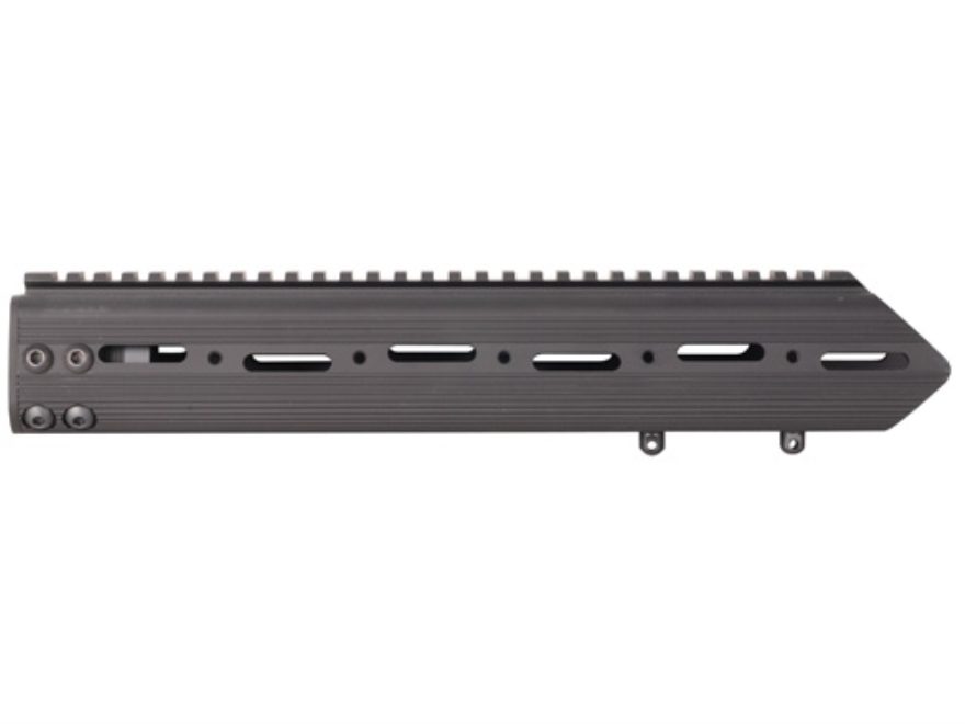

If you can find one, Badger Ordinance made a handguard for LR-308 pattern uppers that had probably the widest, flattest bottom out there. It was called the "stabilizer" and they were a quality forend. Heres what they looked like:
They were square in shape and were definitely solid. Longest length was 12" if I remember correctly. I had one years ago on a 20" 223 upper. But sold it with the upper.
If you can hunt one down that would give you the most flat real estate on the bottom of a 308 handguard. Theres also the PRI Delta, they make those for LR308 pattern and they are pretty flat on the bottom:
They are about $350, made of carbon fiber and another really great handguard. May be flat enough to get your RRS mounted?
