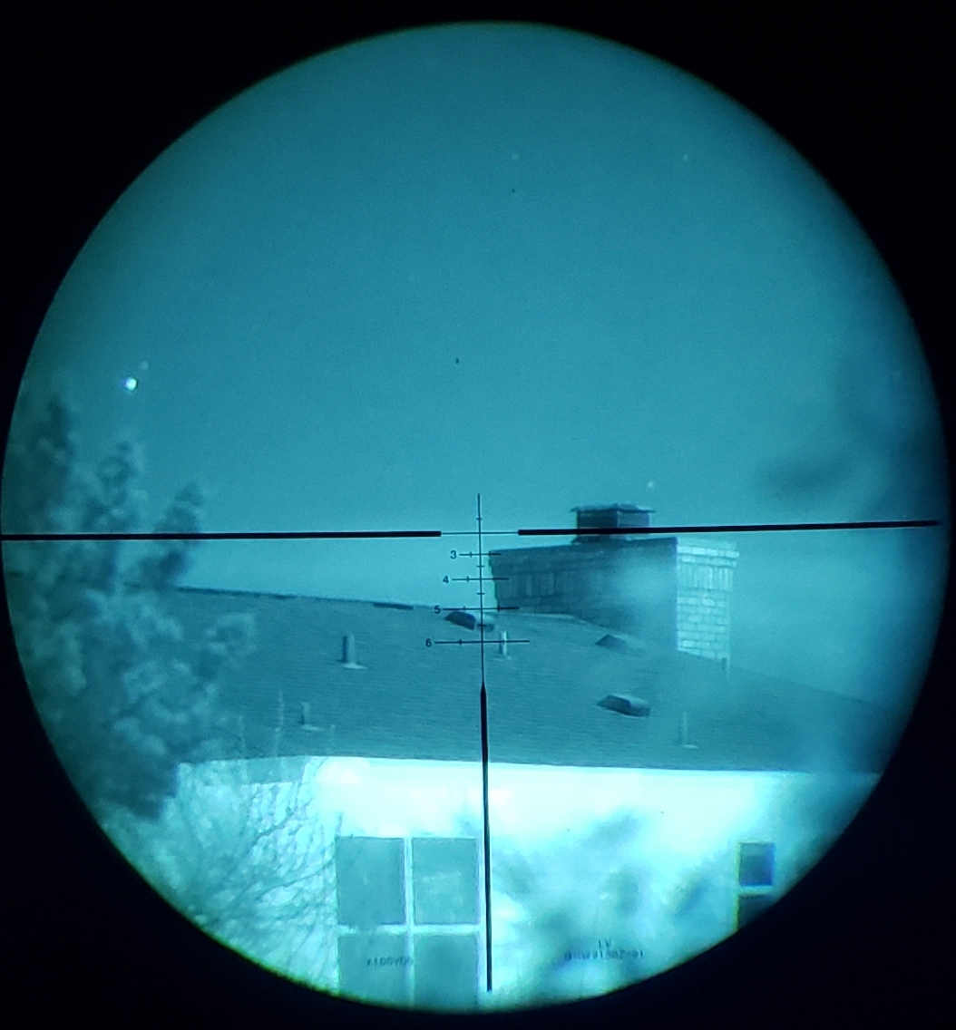

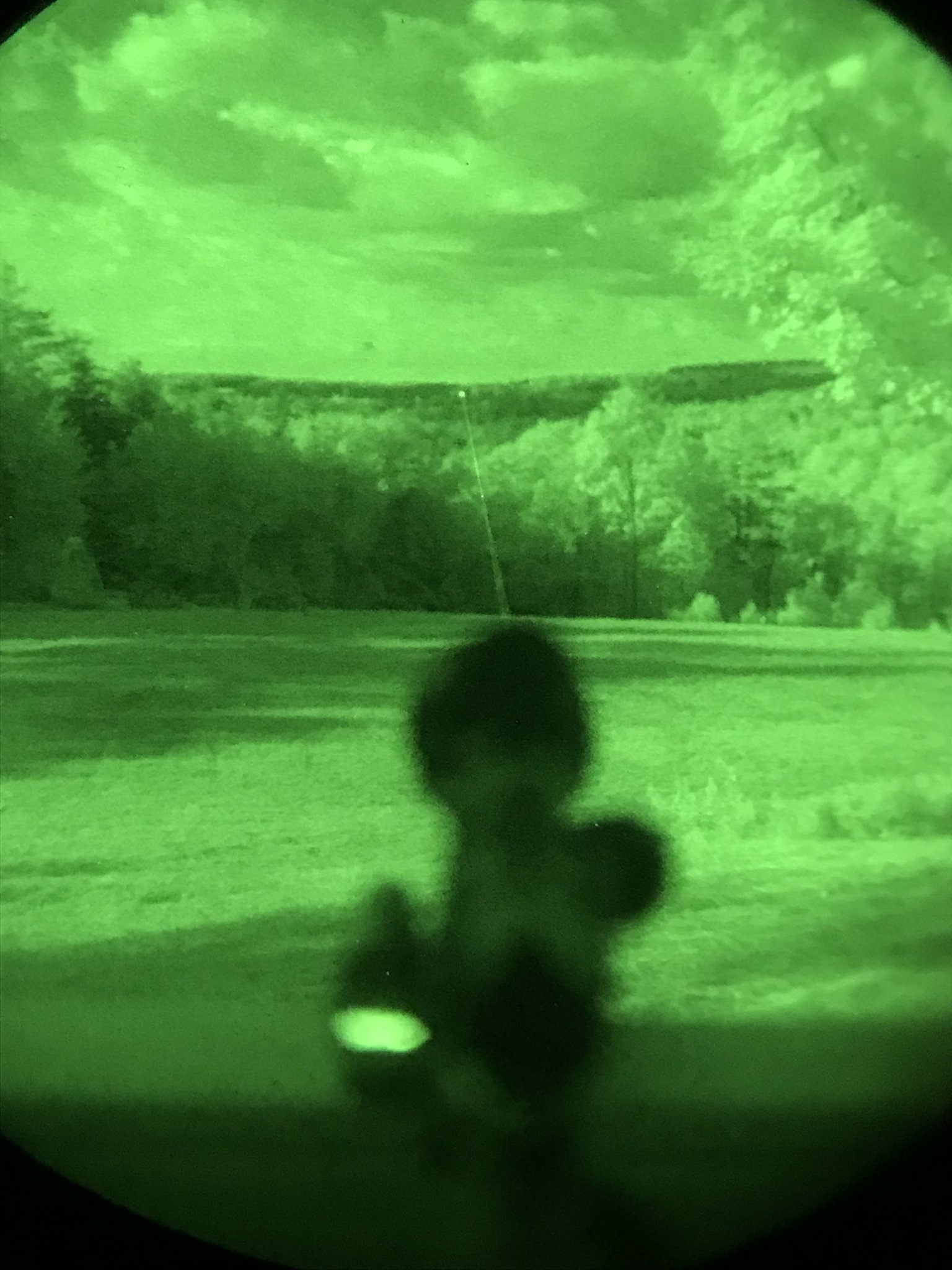

I've been playing with a loaner white phos cnvd-lr for the past few months, and the resolution is unreal. If you've got the money they're probably the best thing going for long range clipons at the moment. That being said, my buddy picked up a lightly used pvs 27 for slightly under $4k and it keeps right up with the cnvd - might even have slightly better light gathering ability with the larger lens, but image quality at long distance isn't as good. We're easily seeing targets at 800 yards with either unit.
I'm certainly not the most qualified person in this discussion, but as alluded to above, the quality of the tube is probably going to make the biggest difference. Most of the 27s and 30s floating around for good prices are thin filmed green, vs the unfilmed white you'd likely get in a new cnvd.
At the end of the day it's a question of how much money you want to sink into a clip on. A used 27 or 30 should serve you well for most purposes, and for likely half the cost. Another consideration is that clipons aren't easily serviced like a pvs 14 or set of goggles. If the tube goes bad the whole center section of the unit likely ends up getting replaced (big $$).

Great contribution and pics, I know firsthand how hard it is to get good pics like that. Out of curiosity, what is the day optic from those shots and what magnification? I remember being positively shocked the first time I got to shoot beyond 500 yd at night w/ a quality gen 3 clip-on, it made the seemingly impossible appear relatively easy... just expensive :cool: And then there are laser illuminators...
Happy to share my experiences! Truly amazing what these things can do. Those pictures are through a Bushnell lrts 4.5-18. As we've played with the clipons more I feel like I want a lot less magnification than I do in the day (probably something to do with the tunnel vision effect). Not sure what power that was taken at, but I'll try to get some more pics this weekend, hopefully one through my S&B.
And one more pic for good measure. Tree line is 1,000 yards away.

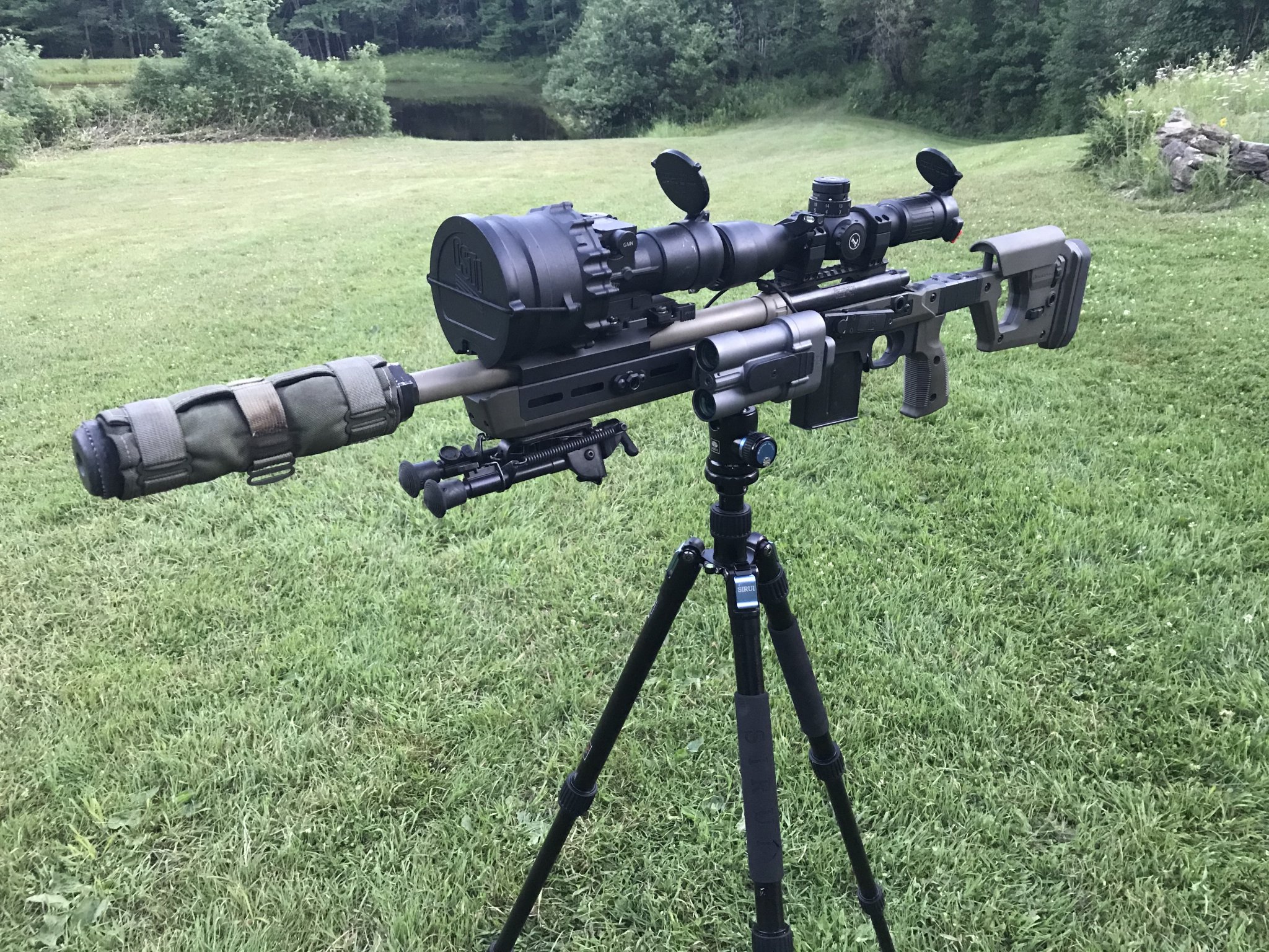

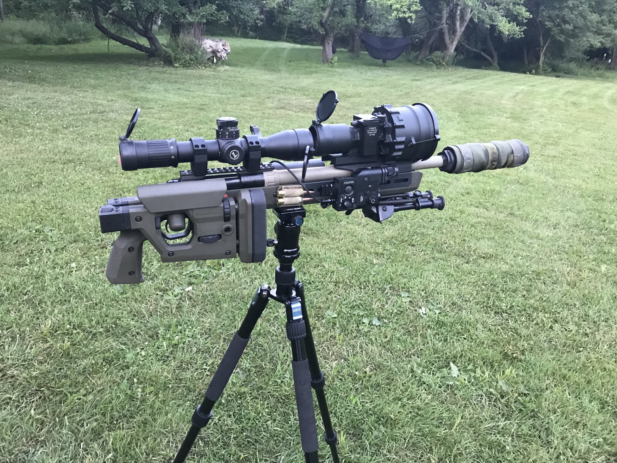

@WillHugh threw up the pics already and did a great job capturing the difference. The one thing that made me lean towards the pvs27 or pvs30 was the ability to handle recoil. If you ever want to put the clip on on a 300WM or similar, the CNVD is out of the picture. Also, I had ZERO point of impact shift with my pvs27 on a handful of different rifles. The CNVD was very picky about scope ring height and that seemed to affect the POI. If you don’t want to have to catalogue the POI for each rifle and spend hours confirming at night, the pvs27 is the way to go.

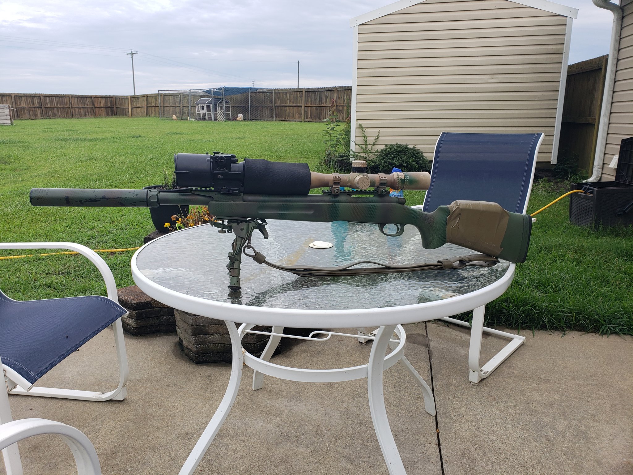

I managed to snag a brand new pvs27 on here for 4K. I have seen used ones for 3500. I will say that the anytime you add a clip on to the rifle, you realize that you now have to adjust how your rifle is set up. For example, a pvs27 makes it more difficult to mount an IR illuminator at 3pm or 9pm on the rifle next to the clip on. Fortunately, I havent had any issues from IR spill moving my Perst 3 back slightly.

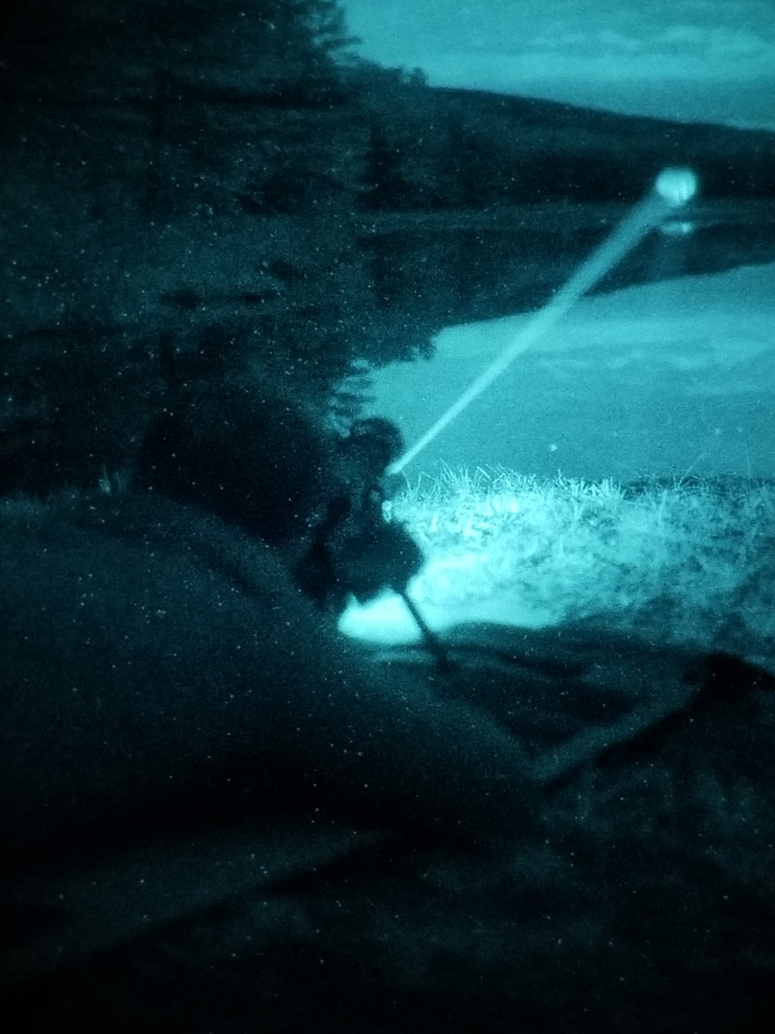

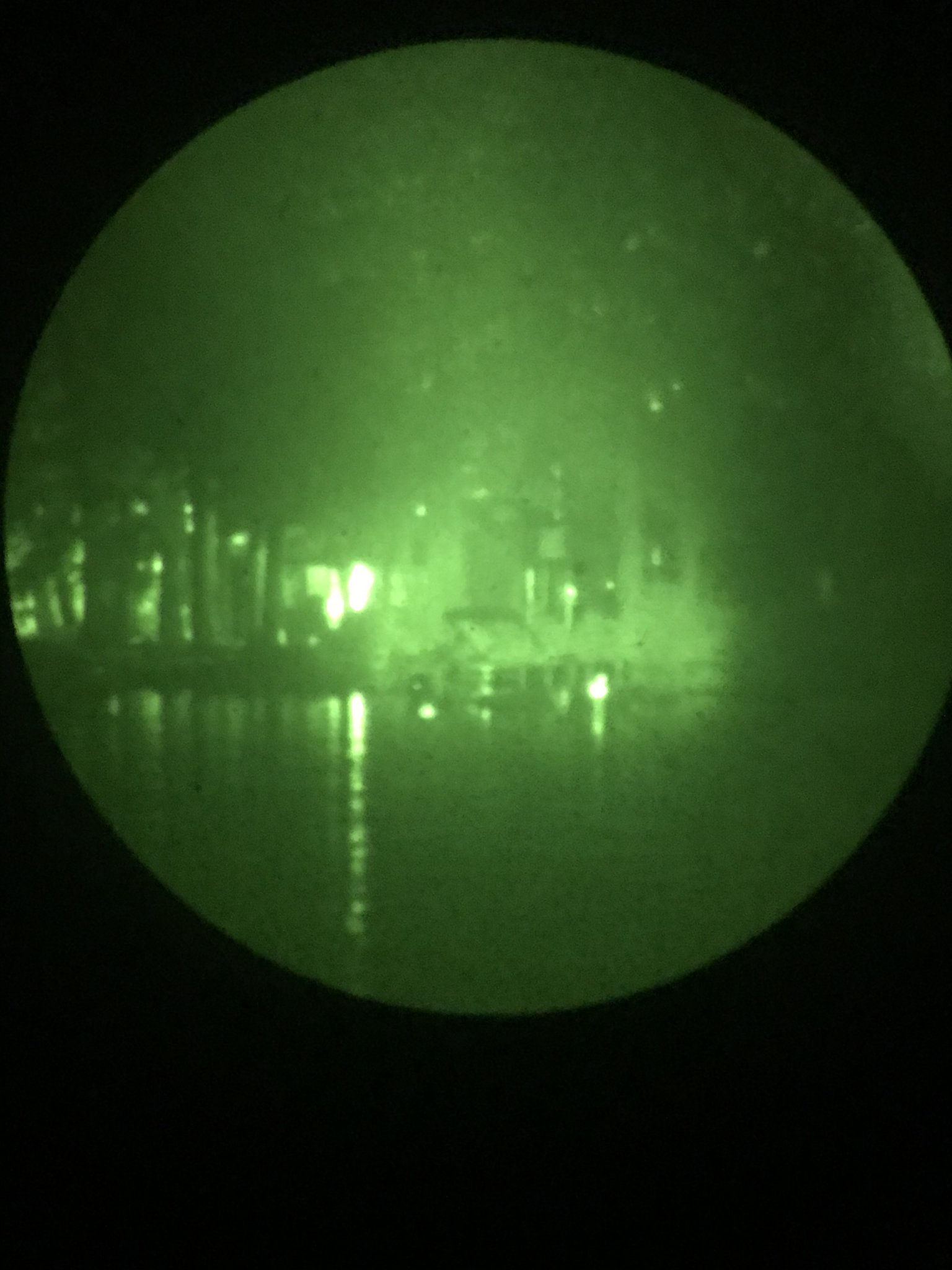

Also - i have been able to easily see things at 900 yards with the Perst 3 and no other ambient light. Below is a picture of a party boat on a lake at 903 yards through a SHITTY BUSHNELL SPACEMASTER spotting scope at x15 zoom!
Shooting this past weekend, @WillHugh and I were easily able to see windows on a church cupola at 1946 yards under the full moon without an illuminator. And with incredible clarity, it wasn’t grainy at all. That was through a Leupold Mk6 around 10-12x magnification.
Also was able to range that distance with a SilencerCo Radius. Farthest we got a read on a non-reflective target at night was 2205 yards (trees). That range finder seems good on non-reflective targets to around 900ish during a bright day.

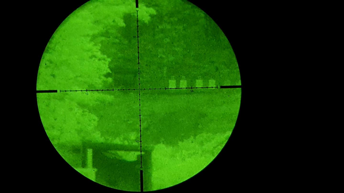

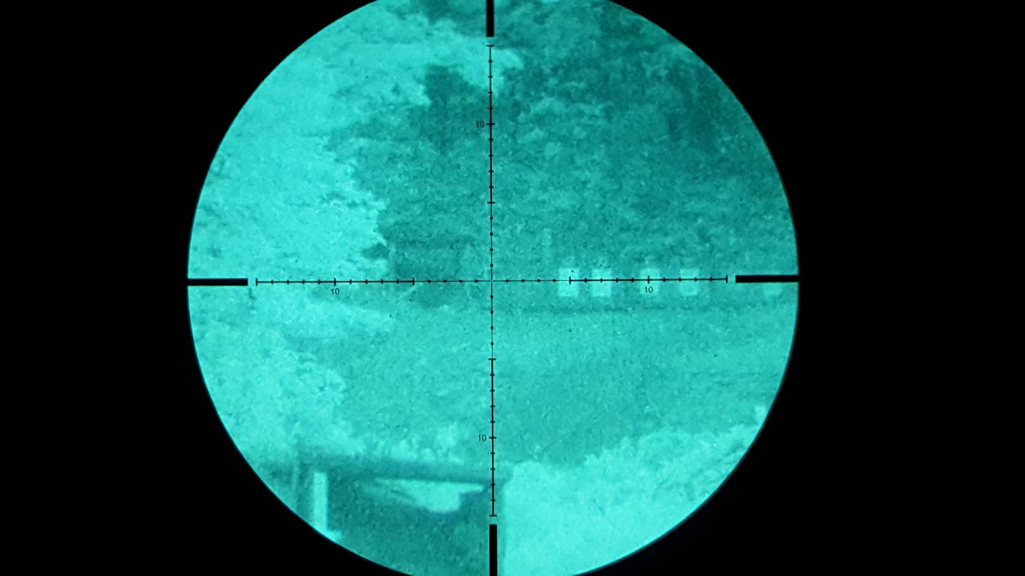

27 image looks better to my eye in these pics
I agree, in that picture they are very similar, with perhaps a slight edge to the 27. In actual use the cnvd looks better, but not enough that I'd shell out the difference.
As I mentioned above, service ability is a serious concern with clipons, as they're significantly more complicated optically than something like a pvs 14. While the pvs 27 is heavier, I think it would survive a fall down the stairs. The cnvd on the other hand is lighter, but more sensitive and supposedly prone to coming out of alignment, and once either unit has a problem you're looking at big money to fix it. For that reason I would probably stick to a 27 or 30 if it's for personal use and not being bankrolled by a big budget. I don't work on them personally, so this is second hand advice I received from someone in the industry.
