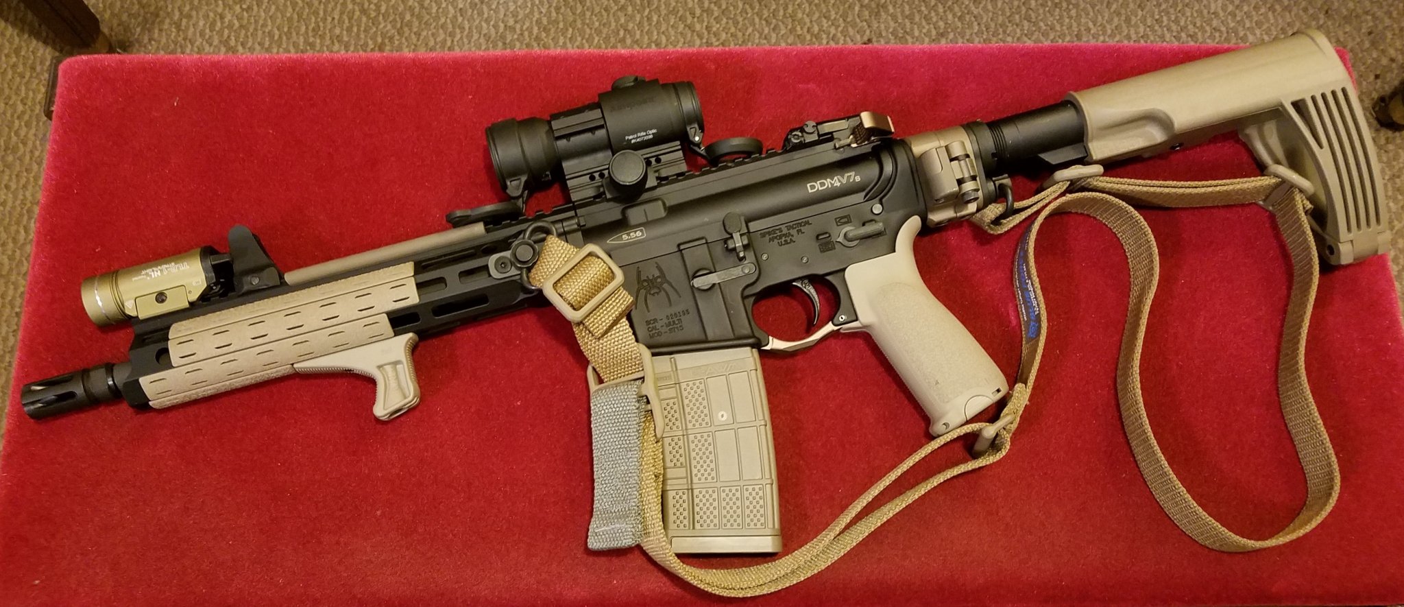

Bcm kmr has done me good. Few thousand rounds through it and can’t remmeber having a single malfunction. It’s an 11.5, which bcm found to be a great length for an ar pistol, as saving an extra inch in the 10.5 in 556 comes with a ton of velocity loss. Running a heavy buffer with a battle arms lower.
Spikes lower with Spikes lower parts kit
Tailhook Mod2 Brace
Law Tactical folder
Fixed DD front sight
MBUS Pro rear sight
TLR1-HL
BCM KAG, Rail Panels and Mod 3 grip
Aimpoint Pro(it is currently wearing a Eotech EXPS 3-0)
Geissele SSA Trigger
Geissele Super Charging Handle
Geissele Super 42 Buffer Spring with H1 buffer
Complete Daniel Defense DDM4V7S 11.5" upper with DD BCG
