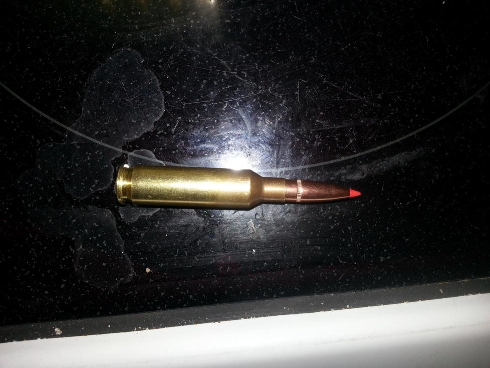

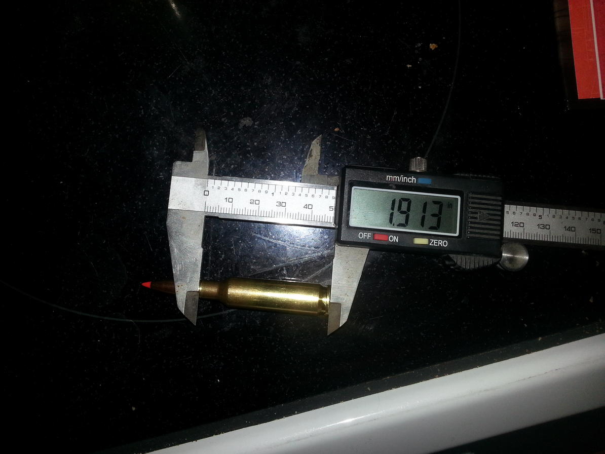

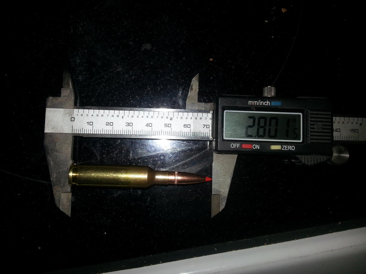

been stalking for a long so here I go. I have a 6.5 creedmoor and was doing some reloading tonight. (im a novice) Im using new hornady brass hornady 123gr sst and the crimp on the bullet sticks way out from the case.
my case length is 1.913, oal is 2.801. it doesn't look right just wanting some other opinions thank you jeremy

Yeah, If the bolt closes when you chamber it and there are no land marks on the bullet when you pull it out, you're good.
You dont really have to trim your brass that far, I trim my creedmoor brass to 1.917"
Ditto what others said, ignore the cannelure. IIRC, the 123gr was made for the Grendel, so the cannelure is probably intended for that case's dimensions...

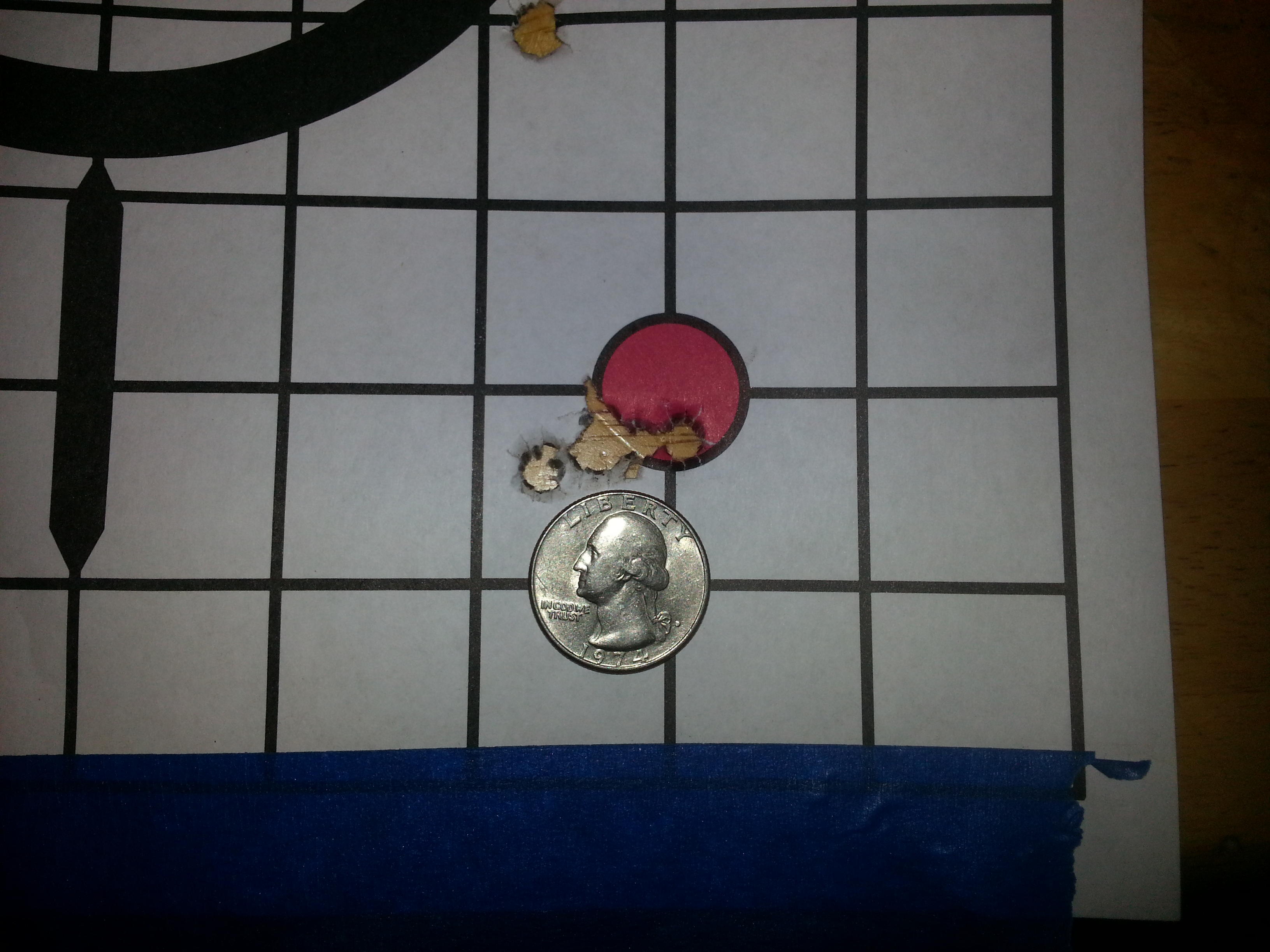

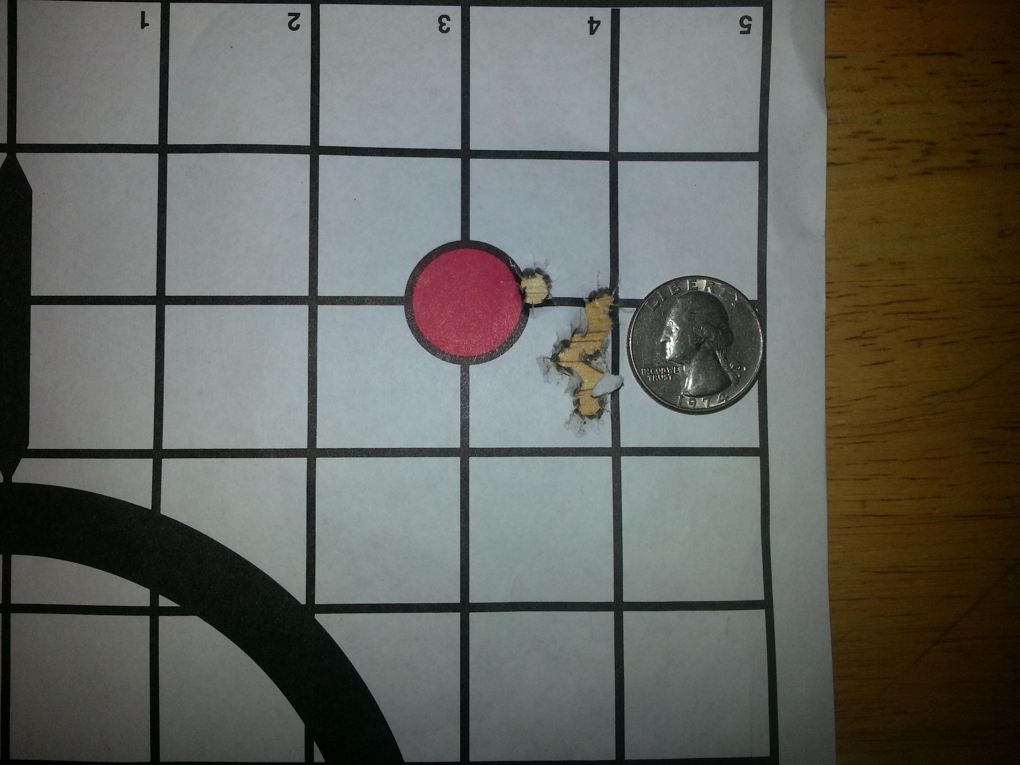

I finally got to the range today. got the barrel broke in and here are my two best groups. now I need to adjust the load a little to tighten it up
