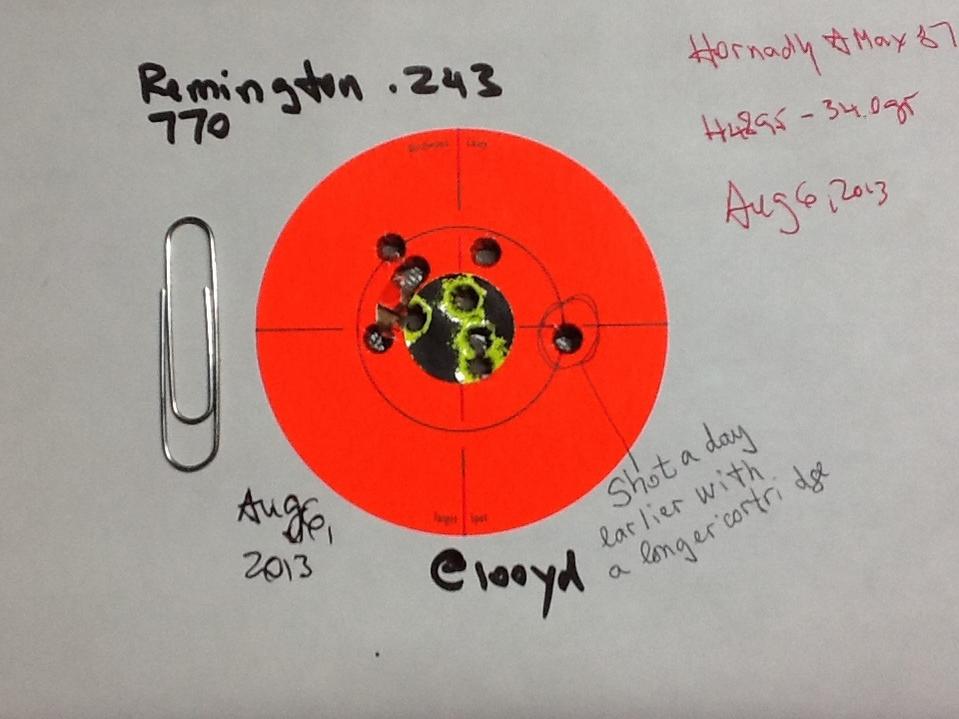

Hey, I have done all the things you guys suggested. All went pretty well with the loads including getting the bolt in my 308 to close properly now. However, as always the case another problem arouse and I need your assistance/advice. After shooting a cartridge (this happened all day today and increasingly lately) from my remington 770 .243 the bolt seems like "welded" in place. I have to exert massive force to pry it open...and as you mentiond before anything that requires force is probably not good. Can it be the overall length? I checked before I poured the powder and after resizing and I was within the parameters. I tried to reload the empty case after I force it out and it appeared to be rather difficult to re-chamber. What might I do to alleviate this new dilemma?
Stop now! The hard opening symptom is an indication of a potentially dangerous overpressure condition. Symptoms like hard to open bolts are danger flags. If they happen once, they are cause for concern, if they happen again, they are cause for alarm. Proceeding beyond that point is very unwise. This report of yours scares me, and it should scare you, too. This is one of those instances where any of the unfired ammo should not be fired, but should be disassembled instead; there's a good possibility that the load you were using is not safe.

Thank you Greg,
None of the issues you have mentioned as potential red flags were present during the episode I related to you. The headspace was checked, the overall length and cartridge measured to the ogive and to the tip was properly checked plus I measured the empty case before I poured in the powder and it was according to specs. Whatever caused that did not happen at the beginning of firing when the barrel was colder. I shot very same cartridges with no problem opening the bolt. I waited for the barrel to cool off but still after a while the problem mentioned occurred. I tried immediately to re-chamber the fired case and encountered resistance opening the bolt. I checked the same cartridge later and discovered I could close and open the bolt much easier. Understanding and respecting your concern I am in this quandary which I am sure has a plausible explanation. Again none of the issues you enumerated as red flags were happening.
Take the fired cases, rifle, and (if possible) a validly representative sample of the unfired loads to a competent gunsmith for proper evaluation. This issue needs to be definitively diagnosed and resolved.
Other possible causes: dirt in receiver bolt locking recess(es), insufficient bolt lug lubrication, galled bolt locking lug(s).
