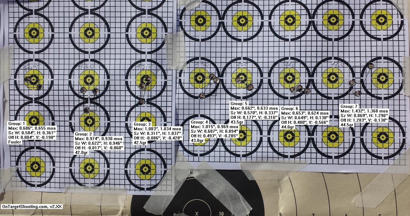

    Ok guys, fast forward a few months and I have started load development. I bought 1x fired brass with crimp already removed (mix of LC and SBS mostly). The biggest portion is SBS so I started with that. Looks like my node will be around 43.5-44.5gr varget behind my 175smk's. I seated the bullets to be 2.815 which is the standard semi 308 size.
    Here are the results:
    I'm fairly sure the 44.5 flier can be disqualified because the primer backed out on that shot. I don't think its from pressure, but rather the pocket was probably over swagged.
    Anyways. Whats my next step? On my bolt rifles I would generally just pick a charge in the middle of that node, like 44gr and then load a bunch up of different seating depths. However, seating depth seems pretty set on ARs, right?
    What would you guys do next?
