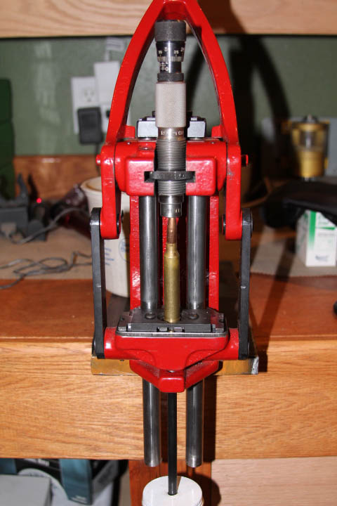

here is a pic with a micro seater in the co-ax and a 300 win mag case and bullet. the handle is straight up on the press with the least amount of room at that point it clears with no problem.

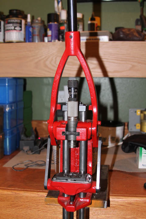

Attached is a Co-ax on a strong mount, with the seating die. The strong mount is very nice, as is the light.
Jt
Sent from my iPad using Tapatalk HD
I like how you mounted your presses to the table. Can you explain that more? Where did you get the materials?
It looks like a specialized table with a built in rail system, ways, kind of like you have on a Bridgeport mill. Otherwise, I can see no benefit in lugging the presses down, unless you happen to own a bench like that? BB
