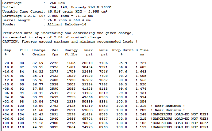

I was wondering if anyone has any load data for .260 Rem with Reloder 16? I was able to pick up a couple pounds locally and would like a starting point for 140 ELD-M, only data I could find on line was for the 142 SMK.
Here are some number out of Quickload that will give you a starting point.
L
Thanks a lot for that Layton. I think I'll start at 37.5 and work up slowly to around 42 or until I see some pressure signs. Everyone has told me to use H4350 but I could not find any, as others have found. Was told that RE16 is very close, maybe with slightly higher fps, we'll see and I'll report back.
