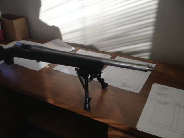

After Barrel was cut down and Threaded

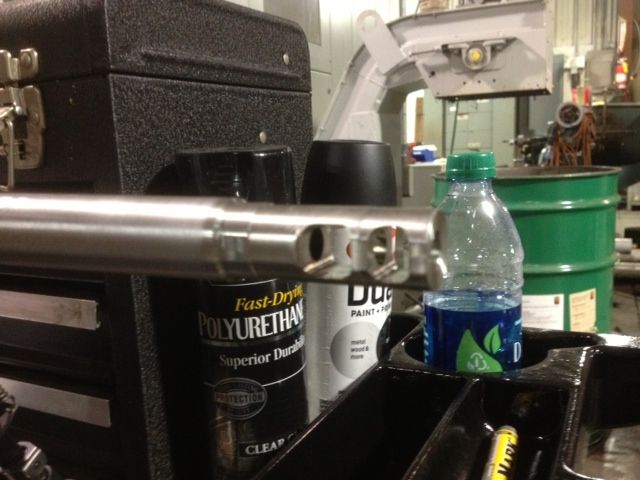

Close up of brake after being machined and installed.

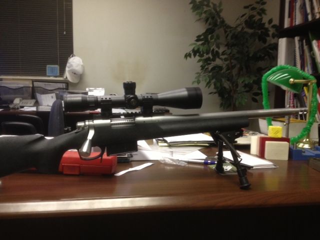

Rifle back together, badger DBM fit and custom bolt knob installed. (Has old bushnell scope for test firing installed)

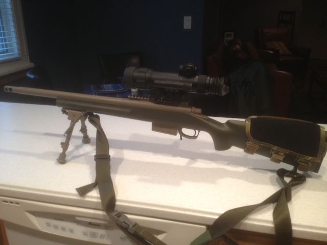

Final Product after Cerakote and installing nitevision, stockpack and sling.
