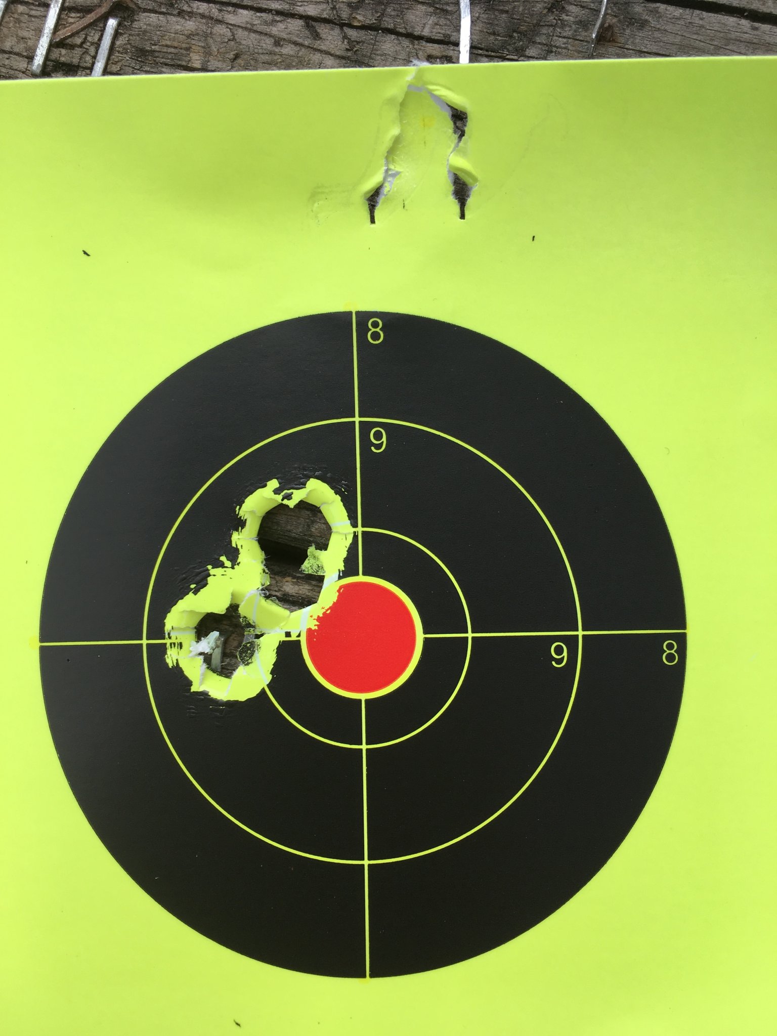

I have a completely factory 700 action with no work and it shoots bug holes with a Brux barrel. I also have a 40XB with a factory Krieger barrel pretty sure they are blueprinted and they shoot about the same.
If I didn't suck it would probably be better. I put 4 practically on top of each other and throw the 5th 50% of the time.
A good tube and chamber do wonders.
Latest 700 with a new tube does this.
