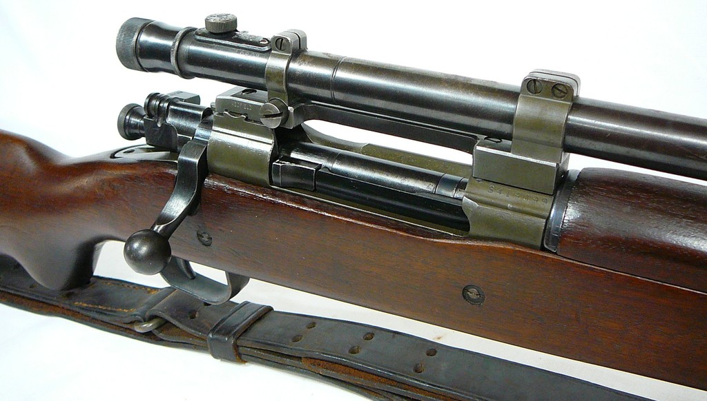

Is the profile of your bolt like mine?
Hi,
Yes the profile on my bolt is like yours although my bolt and handle have been parked.
