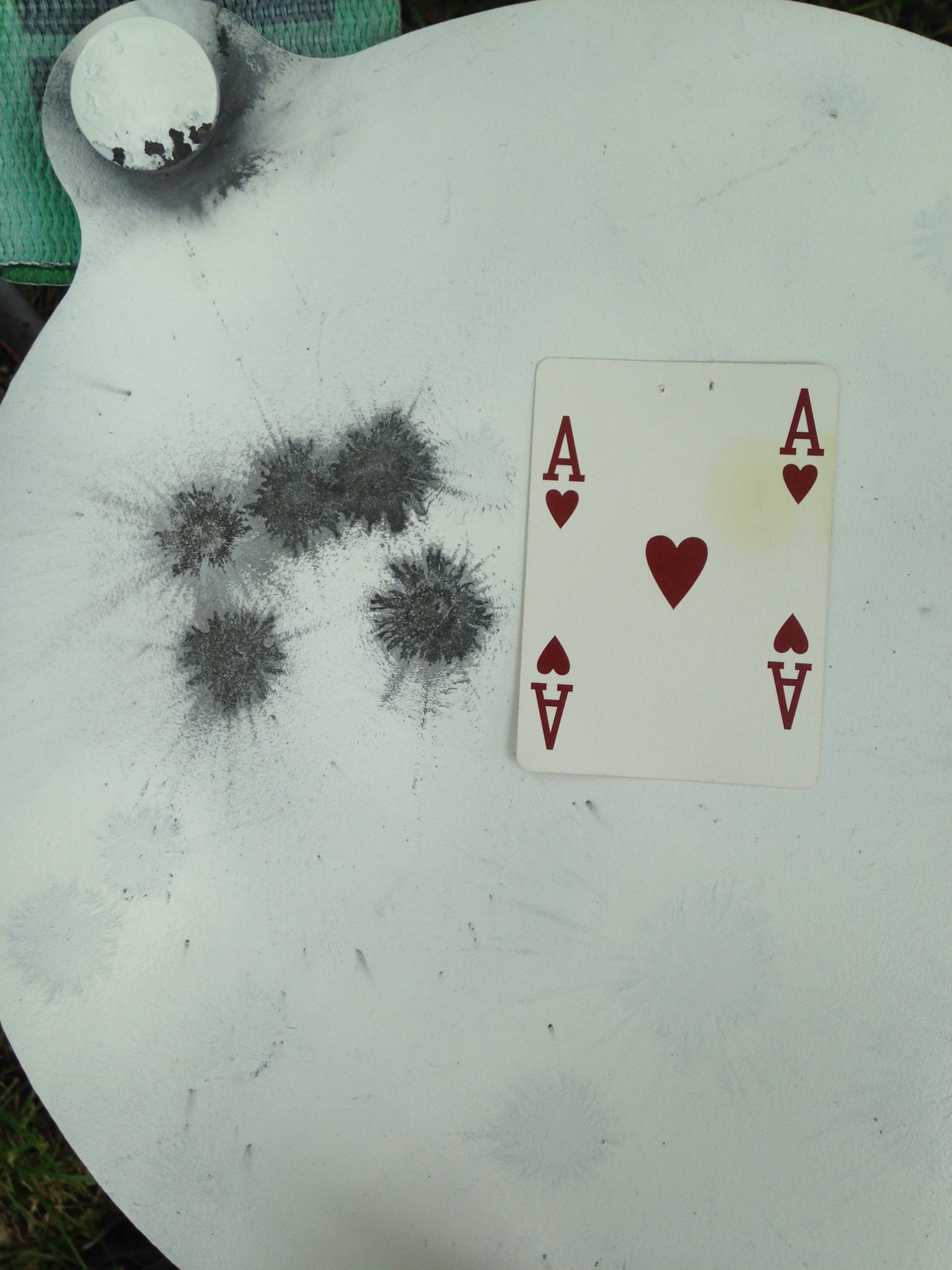

Either should shoot the 69 with no problems. Here's my 20" 1-9 with 75 bthp's, 5 @ 430
