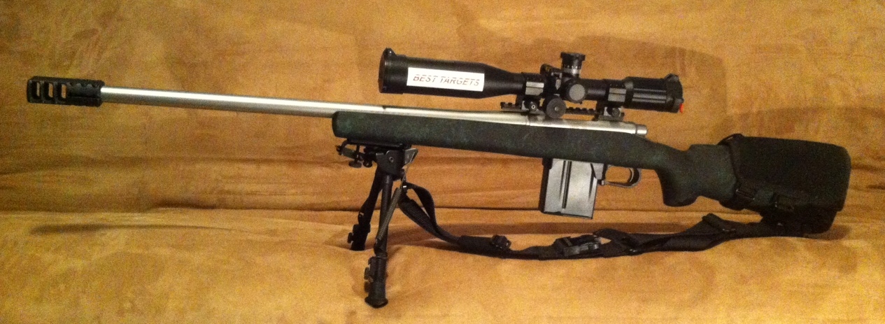

I started my 5R .308 project 4-5 years ago as a first step into the long range rifle arena. Out of the box it was a better shooter than I was with an affordable fixed power SWFA scope. Since then I've added a Kahntrol clamp on muzzle brake, a KRG bolt lift, a few other pieces and a lot of ammo and together we now do a pretty good job out to 900-1000 yards. I shot the 2014 Mammoth Sniper Challenge with it feeding rounds into the top (which I don't advise) and I just got it back this week from LongRifles Inc where they fitted this Surgeon bottom metal. The 5R is tough to beat for the money out of the box and it's a great rifle to build on. DBM Full Crop.jpgDBM Close Crop.jpg
