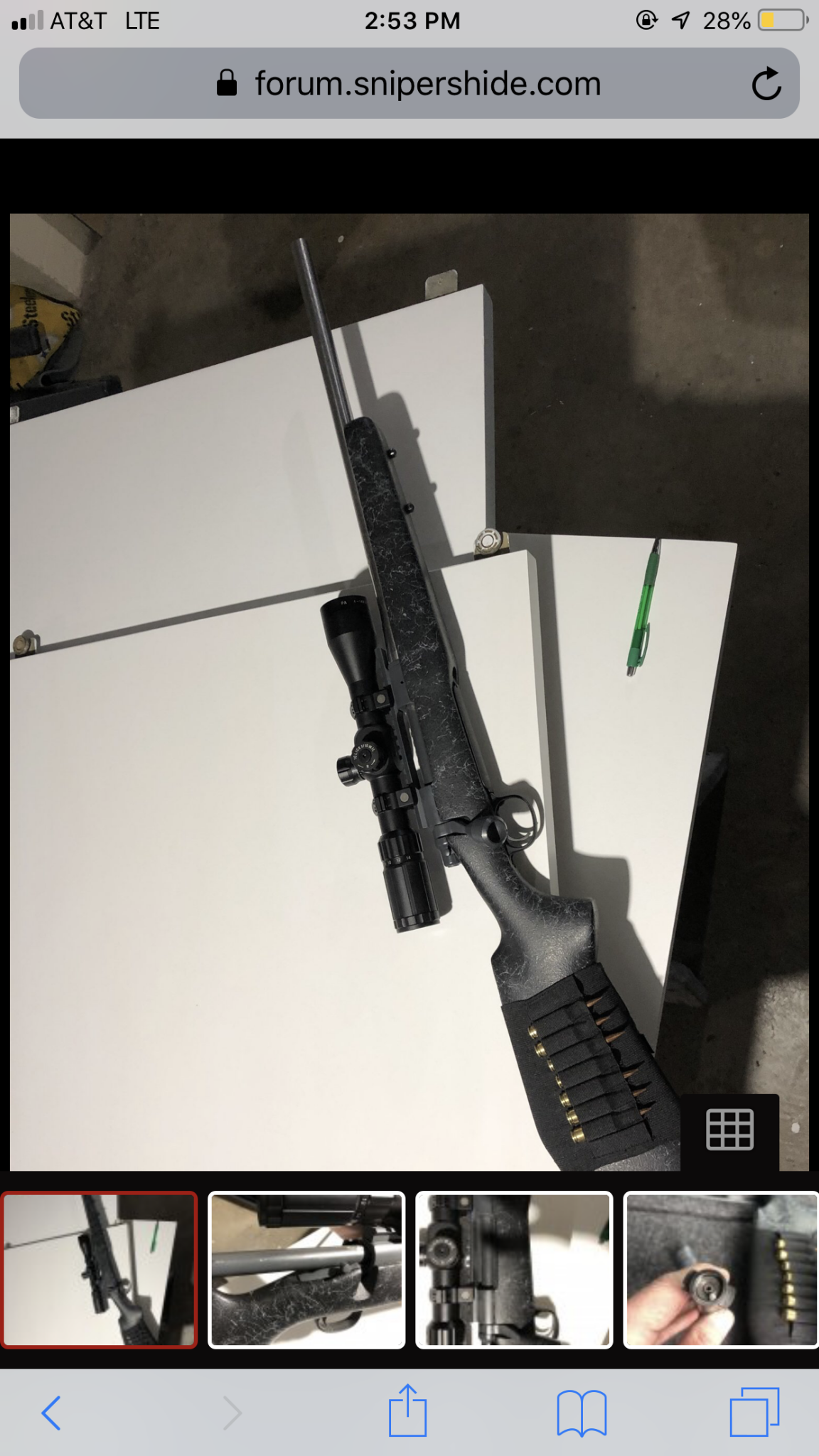

pics/full details on it?

The reason I am trying have a rifle that recoils less is because I only have 1/8th of a shoulder socket so if I shoot something that recoils harder than a grendel I dislocated my shoulder and it’s a 20” Remington 700 with a 1 in 8 Krieger barrel on an hs precision stock. I should be at my ffl on Thursday
That’s what I am gonna pick up

The 6xc is going to kick more than a 6.5 grendel, put a brake on either and they will be tame.
As for how to make a long action a dbm to feed a short action round will involve you replacing that bottom door latch bottom metal with a drob box mag bottom metal, that could involve relieving stock material for the new one to fit, the DBMs are wider than the BDLs.
Unless you are getting an absolute steal on that frankenrifle I would look elsewhere for something that will be less labor intensive and more appropriate for your goals.

Nice looking rifle. Just my opinion I’m no gunsmith but we feed short 6br from actions way shorter than there meant to be. So I dont why you wouldn’t be able to possibly put long action bottom metal on it using a long Action mag and possibly put a spacer kit on it. Or if it feeds like it is it will probably feed from a LA mag with a little modification.
