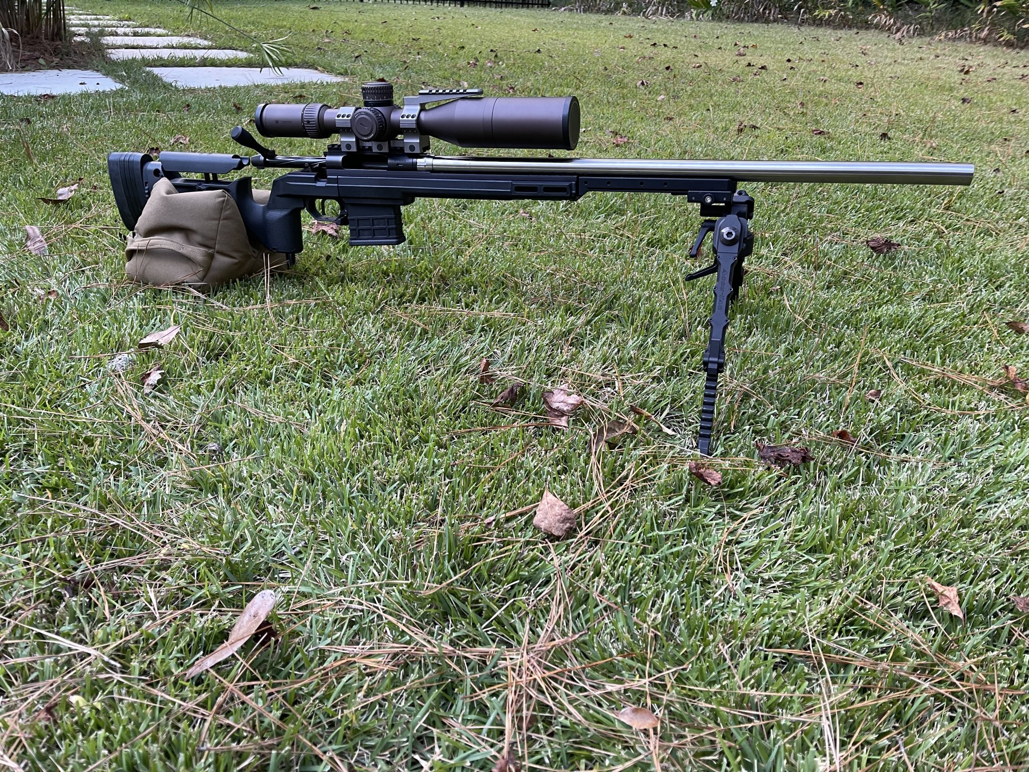

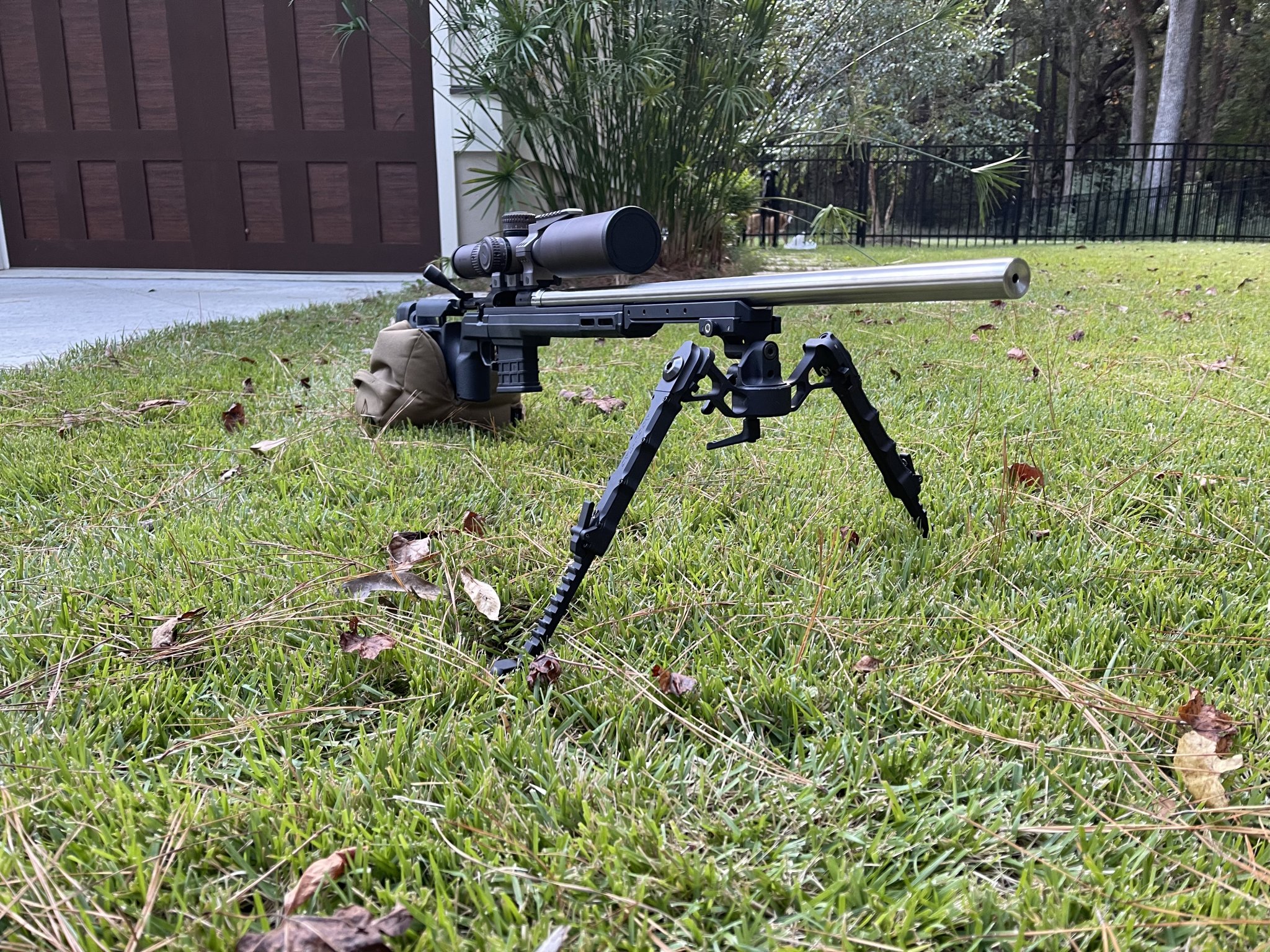

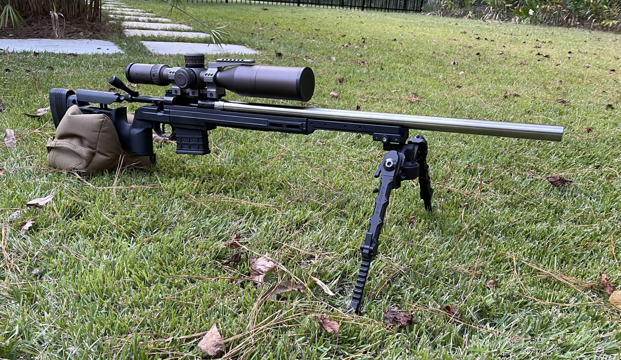

Received all the parts and put everything together. Everything fit flawlessly.
Took it to the range for barrel break-in and to get some MVs. I put a variety of loads through it just to see where i need to be. Will be settling on the Berger 80gr VLD Target, IMR 8208 (23.5gr), CCI #4, COAL of 2.475 (touching lands and grooves) with an average MV of 2835fps though might consider pushing it a little faster. Little to no recoil.
Next step is to get a good Zero and and see my groups so i can start tweaking as needed
Here are some pictures of my .223 build though i will personalize it a bit at some point. Also, wapped out the scope for a Vortex Golden Eagle so I can see how she does in an FCLASS match.
Looks awesome! Nice to see a build come together and the owner is happy!
