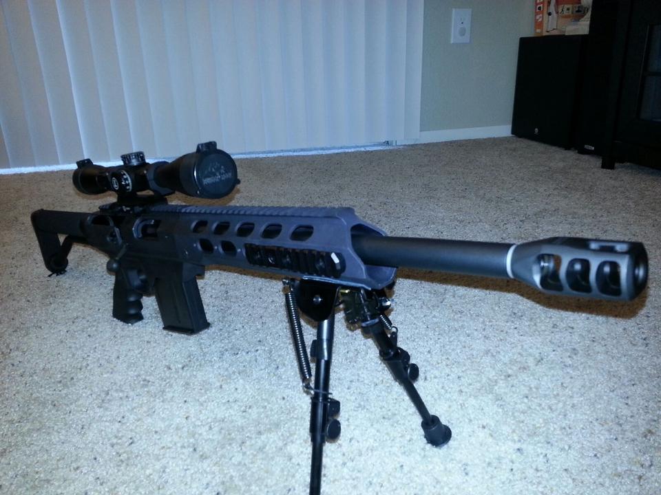

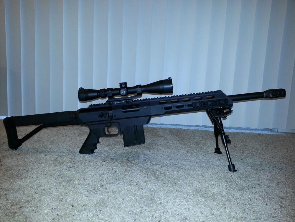

FWIW, my rem700 16.5 is equipped with:
Accuracy International AX chassis
Surefire socom 7.62 muzzle brake
Timney trigger
Warne Tactical 20moa base
Seekins Precision xtra high rings
US Optics LR17 3.2-17x scope
