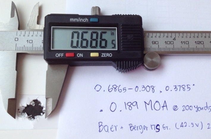

Another advantage of Custom Rig were;
• Match Chamber will maximize Brass life.
• Match Barrel, Custom Contour
• Stock Bedding
5 Shots Group @ 200 Yards (.189 MOA)
Rifle : LB Tactical Recon Bolt Rifle
Action : Stiller Tac 30
Barrel : LB Match 1:10tw 24" Bull Barrel
Trigger : Jewell
Stock : Mcmillan Prone

Great group. Gotta love it when it all comes together!!!
• Stock Bedding
Trigger : Jewell
