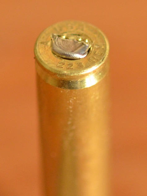

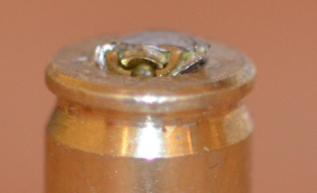

No need to attempt to kill the primer. See pics I stole from another forum. If these didn't detonate then yours will not detonate simply from pushing them out of the case. DSC_560901.jpgDSC_561601.jpg

No need to attempt to kill the primer. See pics I stole from another forum. If these didn't detonate then yours will not detonate simply from pushing them out of the case. View attachment 22155View attachment 22156
