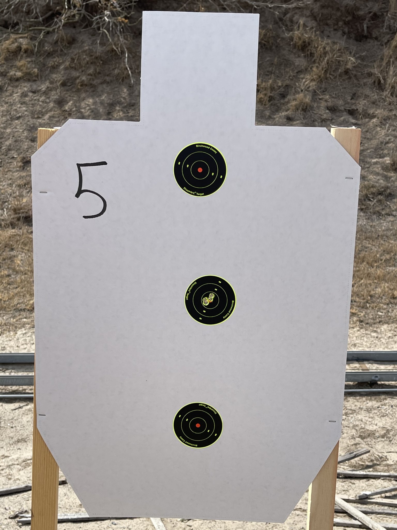

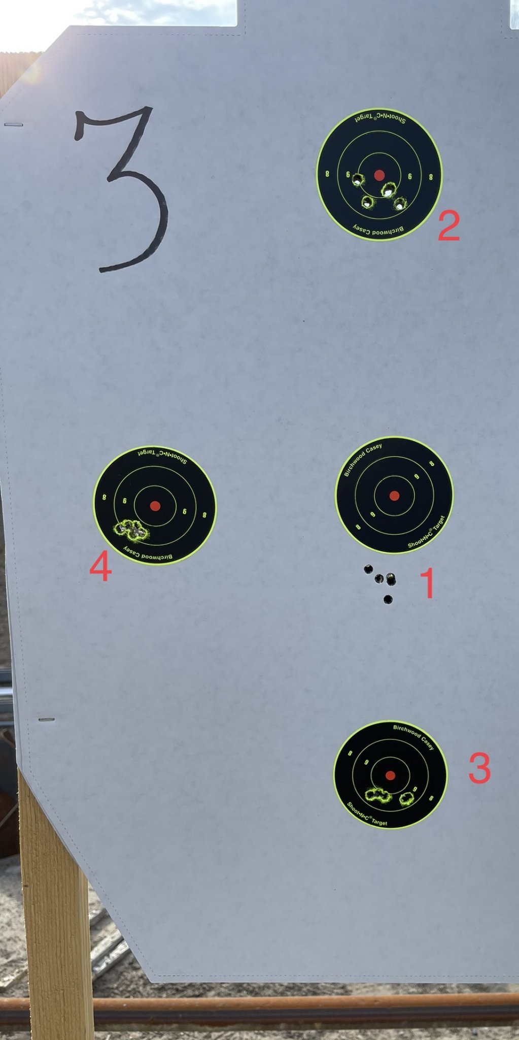

    It’s likely from not attaching yourself to the rifle and then bringing the rear bag into the equation. If you’re doing any form of the following:
    Rifle is on ground with bipod and the rear of the rifle is already sitting on the bag (typically in this situation a gamechanger or fortune cookie or variant). You get down and basically get your body in position.
    That’s going to do bad things. Instead:
    Have rifle on ground on bipod and no bag. Or rifle in hand. (If in hand, sit rifle down with no bag when you move into position and sit the rifle down). Keep whatever rear bag you choose either in your support hand or on the ground away from rifle.
    Position your body square to the target. Move the rifle into position in front of you. While up on elbows, with firing hand, pull the butt into shoulder/collar area. Relax into your firing position. This will slightly load the bipod with just a bit of your core.
    You should damn near (or completely) be able to remove both hands and the rifle is supported via collar and bipod. If you wanted, you should be able to easily shoot 1 moa dots without a bag here.
    Then bring the support hand in with the bag. You as the shooter do most of the support and the bag just makes micro adjustments. From here you can go into your NPA drills and such.
    Phil Velayo has a video called “building the bridge” (or something along those lines) that is very good demonstration.
    Here is a pic from a student at Rifles Only we made this adjustment to. I could literally take a pic like this every single class where we fix this “bridge”.
