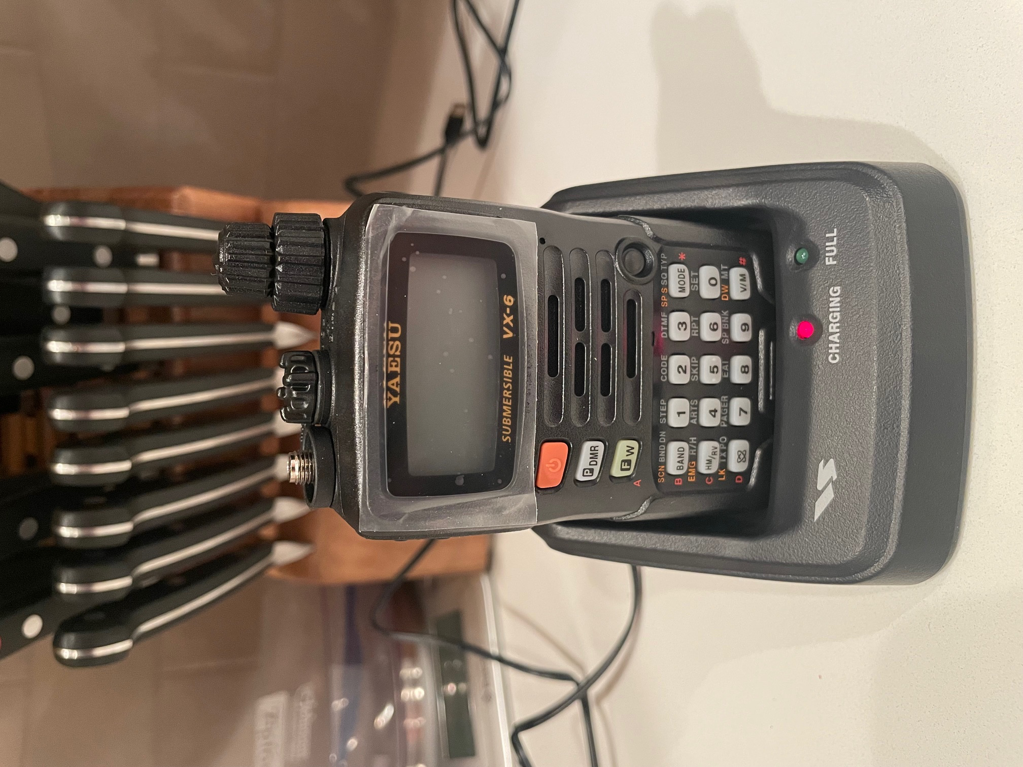

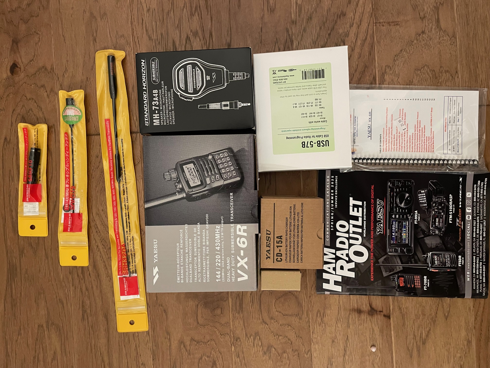

    Just as a follow up-
    I've kept trying to get smarter and knock the rust off since it'd been a number of years since getting my ticket and trying to better define what I was after. In addition to the previously discussed models I also was comparing the FT-70DR model as being perhaps less ruggedly built but with digital options. However one of the comments I came across was to take inventory of the number/location of fusion repeaters near me to leverage it and I think I found two total within the surrounding 4 counties here so that played into my thought process.
    I suspected that there may be deals around Labor Day and ended up being correct after looking at HRO, GigaParts, & DXe. Ultimately HRO seemed to have the best overall prices so that's who I went with and picked up the VX-6R for my first radio (it was just north of $200 with the sale) and unlike the Kenwood I mentioned, figured this gets me something of quality to play with and start formulating opinions and left me with some extra money to put into accessories. It came down to that or the FT-60R that was recommended here but for the $80 difference I chose the 6R for the smaller form factor, tri-band ability, and water resistance.
    In case there's any interest, the add-on's I went with were:
    * MARS Mod (seems like it essentially just removed a resistor and is the hardware equivalent of 'jailbreaking' the unit). With the VX-6R being a popular option I found some videos showing it done and while I felt comfortable making the modification myself with how straightforward it is, I just don't have any of the equipment to do such with the finesse I'd require for my preferences.
    * A handful of Diamond branded antennas. Thought process being that I distinctly remember hearing that the factory "rubber ducks" suck and that a quality antenna was one of the most bang for your buck change. Specifically a 13.75 tri-band (SRH320A) which seemed to get the most frequent recommendations for adding capability while keeping a the footprint manageable/relative to the small size of the transceiver. And since the whole point is to screw around with this and get smarter I also grabbed the dual band stubby 2.75" (SRHF10) & 7.75" (SRH519) as the middle ground. For about $20-$25 I threw them in to compare and contrast with real world differences.
    * A spare lithium ion battery & rapid charger.
    * A speaker microphone. Grabbed the Standard Horizon MH-73A4B specifically because it was built to the same submersible rating as the handheld and a crap mic is maddening from my memory of using radios professionally in the past.
    *Lastly I added some pocket quick reference cheat sheet specific to the radio as well as a programming cable w/out the associated software. I'm going to give it a try using Chirp first but depending how that goes, I might pony up the $25 for the RT Systems ADMS program. Ideally I'm trying to run the software on MacOS which they both claim to support but time will tell.
    All said and done- I'm out about $550 for the VX-6R including all the other add-on's I threw in the cart. I know it's apples to oranges as far as the radio capabilities go but that still puts me $100 less than purchasing the Kenwood TH-D75A alone at its current sale price. So I think I allocated my dollars wisely and have a good starting point to build from.
    If you're still with me- I'd welcome any thoughts on how I ultimately did. Hopefully the items ordered are indicative of research having actually been done on the topic and not the result of haphazard clicking on shinny things but if I screwed the proverbial pooch with anything on this order I'd like to know about it at least and why I was misguided.
    Thanks again for everyone's help on this.
    -LD

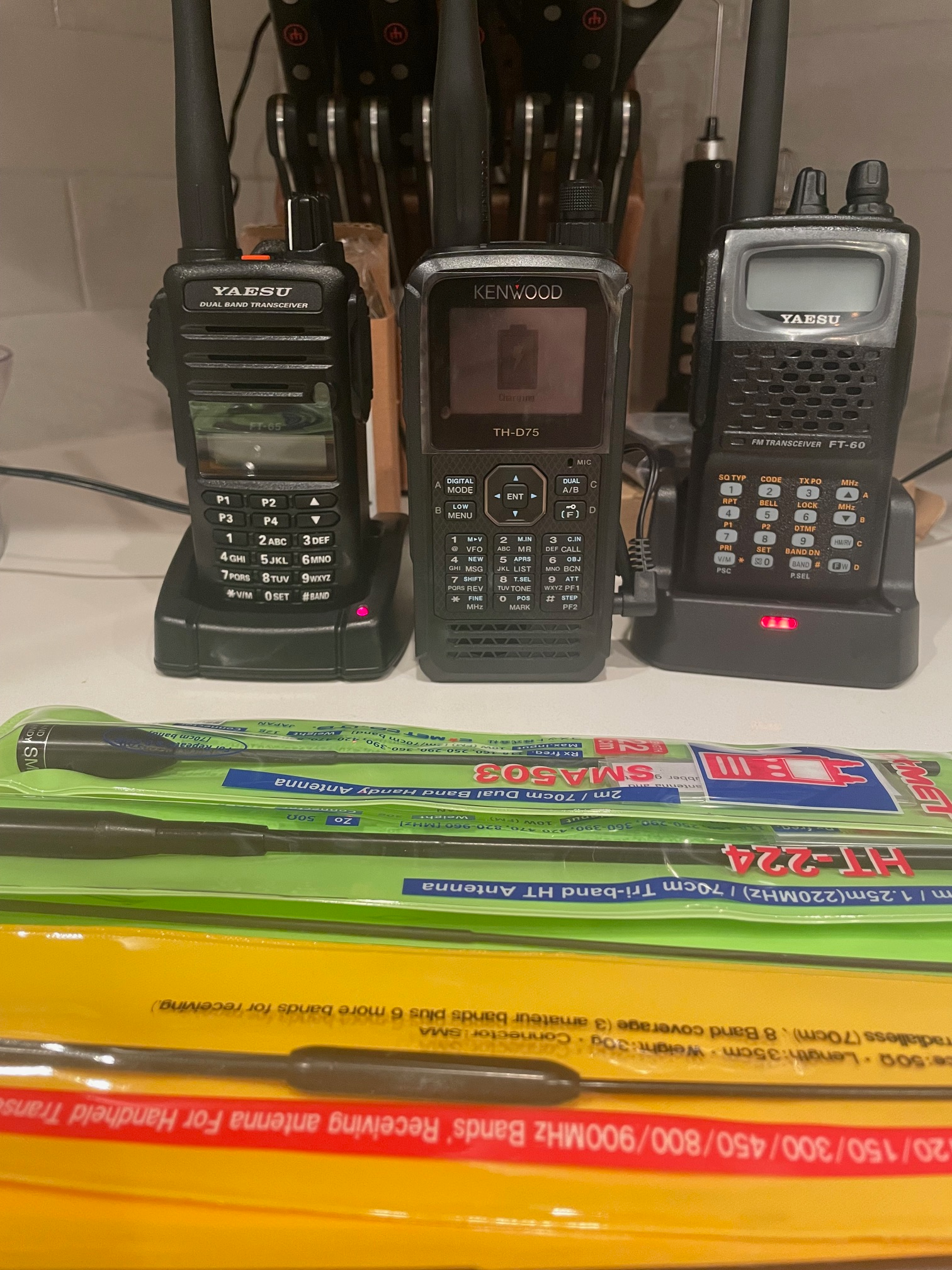

    Well, you made me go out and buy another FT-60, since there was a $20 off factory coupon when ordering from HRO.
    I went ahead and ordered a Comet 15" dual band antenna to go with it, so hopefully it works better than the factory antenna, as I have a hard time getting through on my local repeater when I'm inside the house. I can key the repeater, but my audio doesn't get through. It doesn't help having a metal roof, and a ridgeline between me and the repeater that's about 35+ miles away.
    I'm going to be in Denver next week, and if I have the time, I may swing by the local HRO. It's been over 20 years since I was last in that store, and probably 15 years since I was in the Dallas store.
    Reactions: LuckyDuck
    It should, the factory rubber duckies just work OK for most stuff, but Comets or Diamonds work much better. On the UV5R's we train folks with, we stepped them up to after market 16" and they work much better, while still being flexible. When we put the PRYME AL-800's on them really step them up, but they are none flexible which is an issue 90% of the time. We were going to try some of the longer folding types but have not done so yet. If anyone has tried them, I'd be interested in their results.
    I've a few Kenwoods that I use for base station, mobile, and portable work that have been bullet proof so far.
    While they might be lacking the latest gadgetry, I've found Kenwoods to be very solid in the basics of what a radio does. My old Kenwood TS-830S doesn't have the CAT control, soundcard, DSP or other things available in modern radios, but it has the hottest receiver and best transmit audio in my shack. I also have a TS-2000 and the more modern TS-590SG, which has CAT control, DSP, a soundcard, and the cool feature of being able to use a cheap SDR as a panadapter. While I maintain a HF capability, I mainly use the radios as IF's for VHF/UHF transverters. The 2000 receiver sucks above 10 meters, but works on 6M, 2M and 70cm for stuff that doesn't require a low noise figure and good sensitivity. The 830 and 2000 need a Signalink or similar gadget for digital modes. For those new to this, the TS-590SG is a great choice at its pricepoint.
    I have a friend who uses a Kenwood dual band handheld and a hand-aimed Arrow antenna to make satellite contacts. All you need are the radio, antenna, and knowledge to do this.
    I have an older model Icom IC-746 that has weapons grade stupid design flaws. It's in a box in the attic. It's an OK HF radio, but has serious stability problems on 6 & 2M for digital modes. It's less stable than Nancy Pelosi at happy hour. A group I do VHF contesting with uses 746 pro's as 28 MHz IF's with good transverters, and it seems to work OK.
    I use a Yaesu 818ND as an IF for my portable 10 GHz setup, and it's fine for the CW and SSB used there. So far I haven't tried digital with it, but the mode used there is not as sensitive to drift as the modes commonly used on 432 MHz and below for terristrial contacts. I use a regulated voltage source with the radio and my transverter instead of a battery.
    None of my radios' receivers comes close to the early 60's Collins R390A I sold and wish I still had. Most of these that you'll find in the market don't have all of the original Milspec parts, which are hard to find. Rumors in the tin foil hat crowd are that some CIA listening posts still use these and have tied up the supply of original parts. With original parts, these have a lower noise floor than any modern receiver and the filters are superb. The fact that modern radios can't outperform a 1960's receiver is sad, but I can't imagine what it would cost to build real R390 today.
    I fell down the radio rabbit hole this year.
    At work we needed to get a radio system setup. We were using FRS radios around our facility for years but earlier this year we expanded and the budget was available to invest in a commercial system. I know this isn’t the same as HAM but doing the research to get that system set up sparked an interest in radios for me.
    Since then I have purchased an RTL-SDR, FT-60 and Anytone 878. I don’t have a HAM license, but that will probably come eventually. For now I’m basically just scanning for local activity with the SDR and then programming those freqs into my radios so I can listen on the go. I probably should have bought a scanner, but it seems like there are fewer options for good quality, rugged scanners.
    I have really enjoyed going to racetracks and scanning around during their events. Once I find an active frequency I’ll try to figure out which car I’m listening to. Monitoring the track staff radios is also interesting. One of the tracks near me uses DMR. I learned how tricky it can be to monitor DMR activity when you know nothing about how the system is setup.
    I’m a noob when it comes to radio so I probably shouldn’t give advice, but I have enjoyed my RTL-SDR so much. I have learned more from it than my two HTs, for $50 it’s a must-have in my very humble opinion.
    A small handheld Spectrum analyzer can be had cheap and will show all active freq's between 100kHz to 5+ gig.
    I've had mine for a while now, and it has done everything I've asked of it, to include RDF'ing.
    If you're looking at one, make sure you get the real deal, as cheap clones of it are all over the place. The Mfg'er even has a warning on their site & can tell you how to spot a fake, & who their dealers are that only sell the real thing.
    Mine came from Amazon & now they have a few different models as well. I bought the basic one, but it does everything I need.
    https://www.amazon.com/s?k=tiny+SA+...tiny+sa+ultra,industrial,101&ref=nb_sb_noss_2

    Just to recap... in rapid succession after purchasing my 1st radio & having a brand new Yaesu VX-6R in hand- I have now went on to purchase a class bundle that should take me up to an Extra license, ordered a Yaesu FT-65R (and accessories), as well as a Yaesu FT-60R (and a few more accessories).
    Remember when I started this thread and mentioned the Kenwood TH-D75A? As "luck" (I'm sure it must be luck and sheer coincidence) would have it, where I've been ordering all these radios & radio accessories from just launched a "big sale" with "blow out prices" on ONLY 6 items this weekend. You better believe that damned Kenwood was included in the only 6 items they're having the "super sale" on and honestly it's the lowest price I recall ever seeing it offered at.
    So I ended up buying that too... Along with some more "necessary" accessories.
    I will say I showed great restraint though with the Kenwood. I did not purchase the cradle (interestingly enough both additional Yaesu's I ordered came with the cradle stock) & I did not order a spare battery since they were not on sale and also over $100 a pop... still don't know how they could possibly be that expensive. I restricted my accessories to ONLY buying an extra aftermarket antenna or two (did I mention somewhere down this path I realized I only purchased "diamond" branded antennas and realized I was doing myself a disservice in my continued education by not giving the "comet" brand a fair shake? that's been/was corrected somewhere down this road) and the programing cable/software because frankly this beast is incredibly overwhelming and I wanted to make sure I had software compatible with Mac OS before I even try to crack that nut. But that's it... well all of that & a screen protector (but hey it's a two pack!) for $20 because this is a damn expensive radio... Ok the aftermarket antenna, programing cable & software, screen protector AND the Nifty brand manual because... I did mention how overwhelming this particular radio seems to be right??
