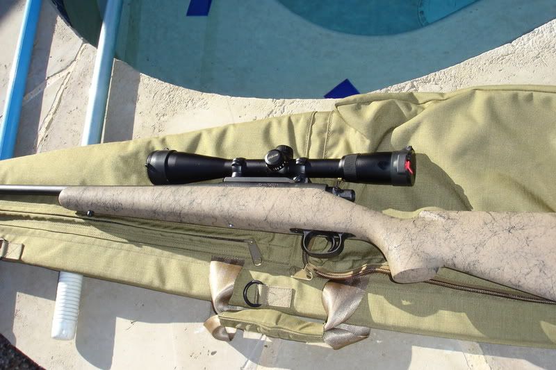

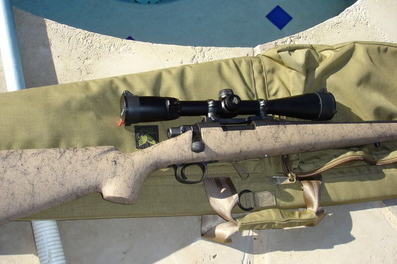

I'm turning my daughter's .243 into a .7mm-08. Here is my shopping list:
Match grade barrel, fluted, chamber cut. New recoil lug
Trued, blueprinted or whatever 700 action
Ceracoat action and barrel.
I'm thinking $400.00 Barrel, $150.00 action work, $100.00 ceracoat? What do ya'll think? The rifle shoots 1.5+ MOA, I want .5-.7.
Here is the rifle
