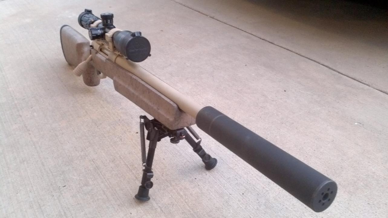

I have a 16" barrel on my Howa, and am using 8.9 gains of Vihtavouri N110 with a Hornady 225gr and getting about 1030 fps.
220 smk. 8.0 with 208 Amax gives about the same results. I haven't played with oal much to see if I can tighten it up. I don't change the die setting from the smk to the Amax and the oal on the Amax is about 2.17
I try to get my sub sonic loads right on 1000 fps for best accuracy.
