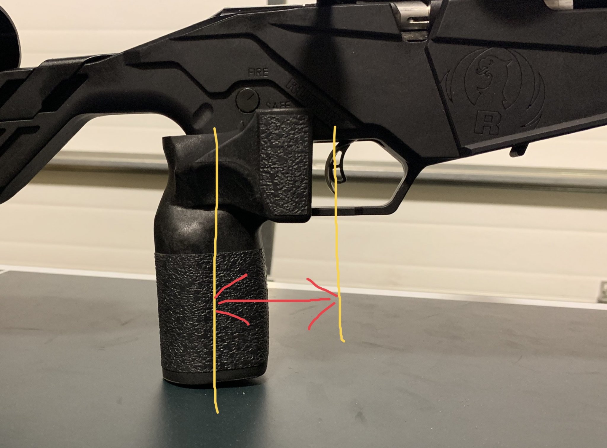

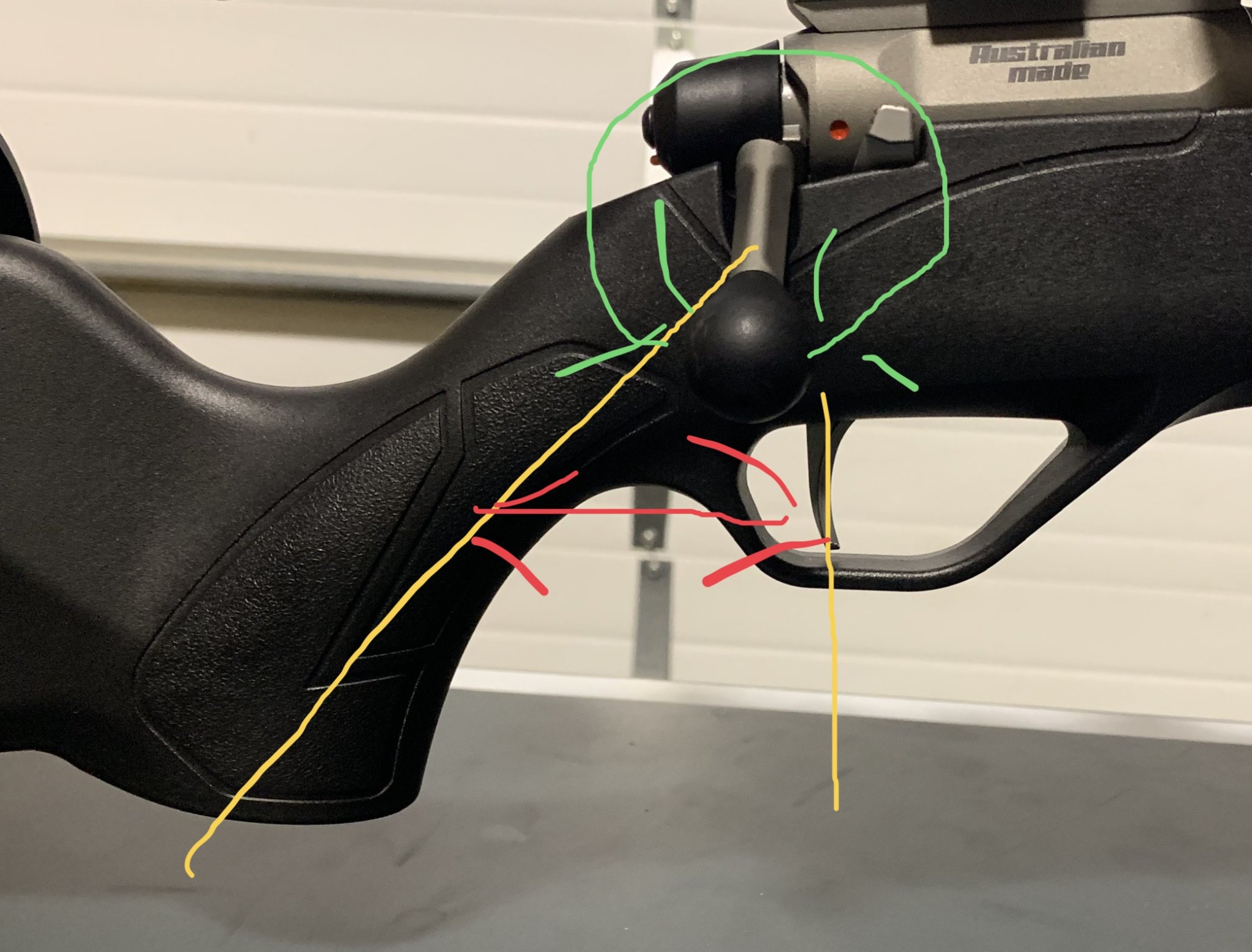

    On another aspect of this discussion, looks like another spec we need to know on stocks/chassis is the trigger to grip distance. Would be somewhat hard to measure on a traditional stock. What would we pick as the measurement point?

    Maybe we need more than lop info, like these two pics.
    Trigger to midpoint of grip and then with “non-vertical” grips the angle (in green).
    Thoughts?
