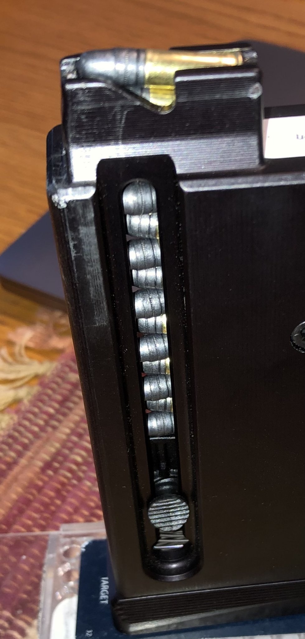

Over the years I've wondered if Vudoo's original, massively-overbuilt 12/15 round aluminum mags got pulled because they would misfeed/stop if the cartridge column was misaligned (photo) and a user had to be so.bleeping.careful. to load them correctly.
Explanation: note the staggered appearance of the bullets in the stack. If two rounds stack on the same side of the mag, a stoppage will occur there. It also happens with 10-rounders but somewhat less frequently.
These metal magazines ar 100% flawless in a Gen 1 Action. I love them.

As far as the Vudoo mags. if you load them correctly, making sure each round is settled in place, they never seem to fail. 2600+ rounds without one rim lock.
