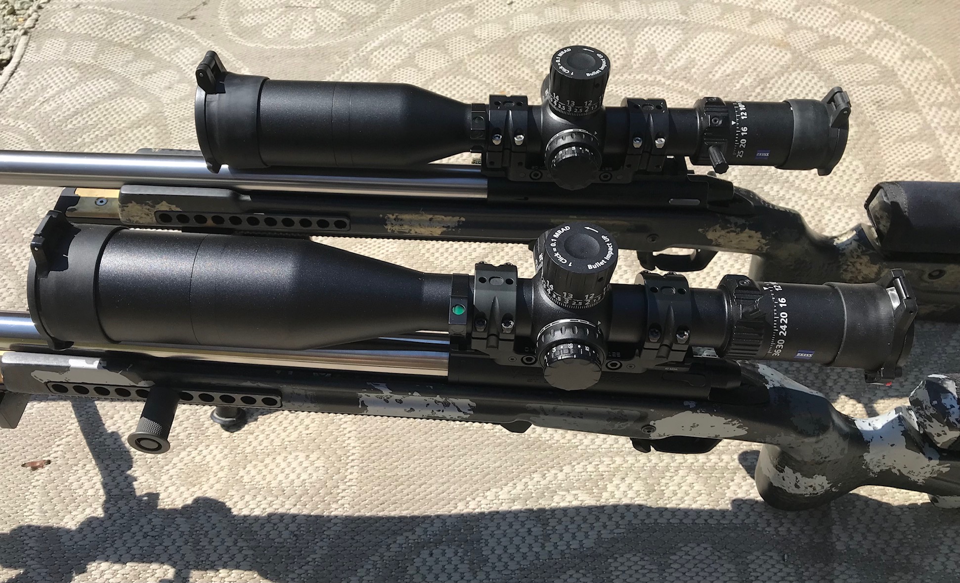

That's the answer. Glass is great, on par if not a hair better than the Gen 3, and it has 32 mils of elevation. On a 40 MOA base I have about 26 mils I can dial before using the reticle so that gets me to about 440 yards. If you want a lot of elevation get the LRP S3 4-25x and put it on a 60 MOA base and you will have about 40 mils of elevation to dial as the scope has 46.5 mils total. I like the Burris Pro but because of the elevation I would keep it on a centerfire as I am. My Vudoo has a LRP S3 6-36 on it now. Just got the 4-25 yesterday and put it on my 6.5/6 Creed.

No problem. Getting it at a good price always helps. Expertvoice has them at a really good price now. If you wanted more elevation you can use a 20 MOA M Brace. That will give you 50moa and should be around 29.5 MOA of elevation.

Nope. The 32 mils is in their working zone and where IQ is all good. Some have said they had 50 mils in the 4-25 but after talking to Zeiss I found out that’s not all with best IQ. The 46.5 is where the IQ is best so with the 6-36 you should be fine in that 32 mil area.

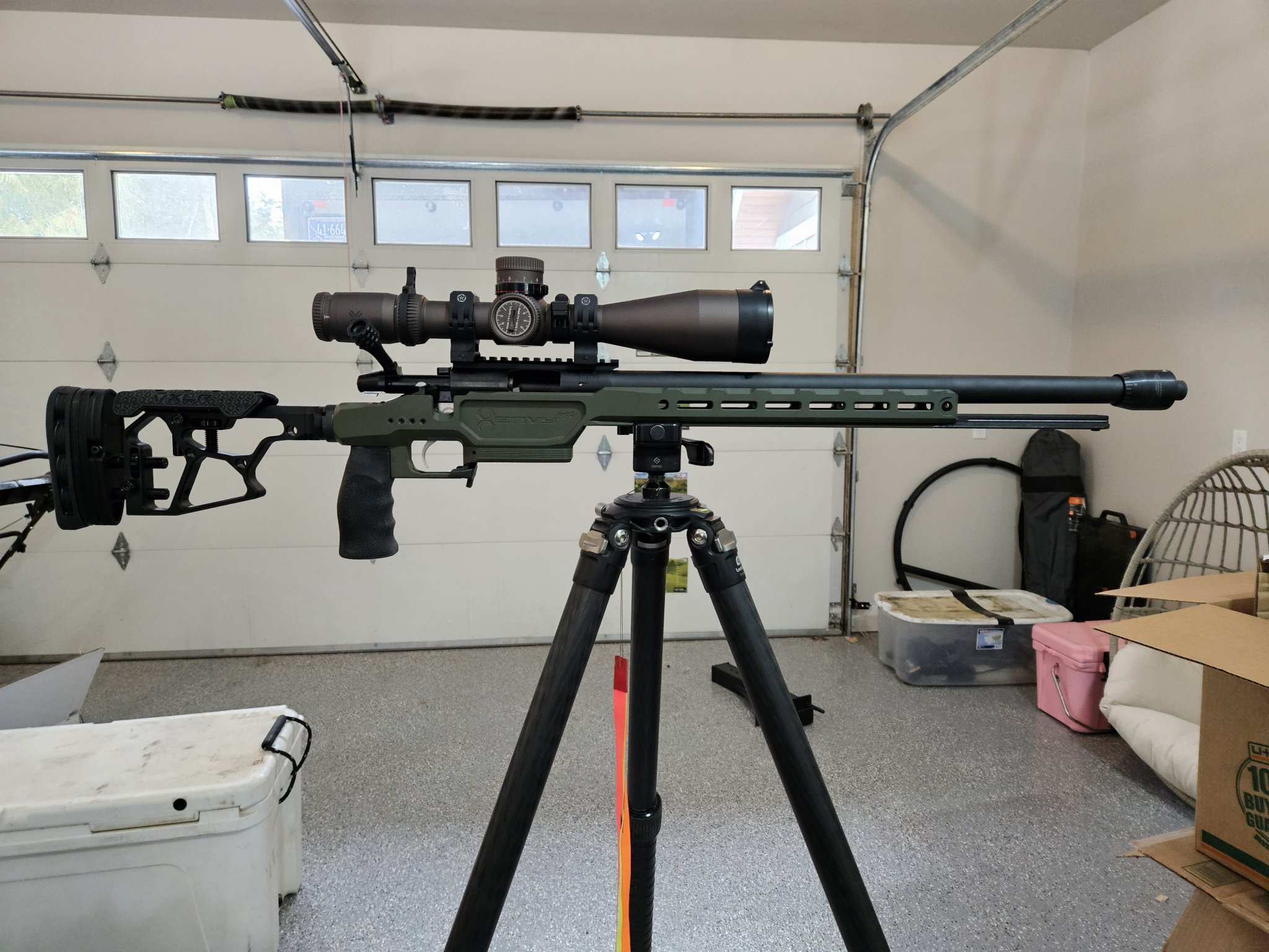

So you should have picked up the rifle by now, how about some feedback…..
how does it shoot? Who did the barrel work?
Let’s see that thing…. The Rimx that is!!
Check about 3-4 posts up. I went with a Zeiss S3 4-25, which still hasn't shown up, but oh well. Still has the g3 razor atop. I haven't shot it but maybe 10-15 times in the driveway getting a rough zero at 50y. Dime sized groups with Eley standing of top of tripod, not that stable. Manzella Precision cut it with an Eachus chamber. Hope to report more in coming weeks.
